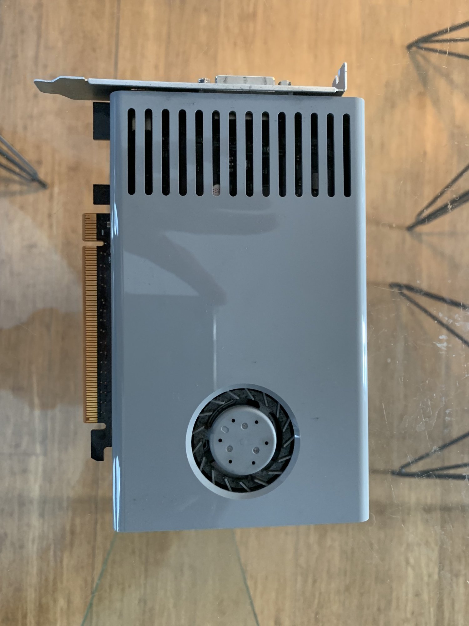

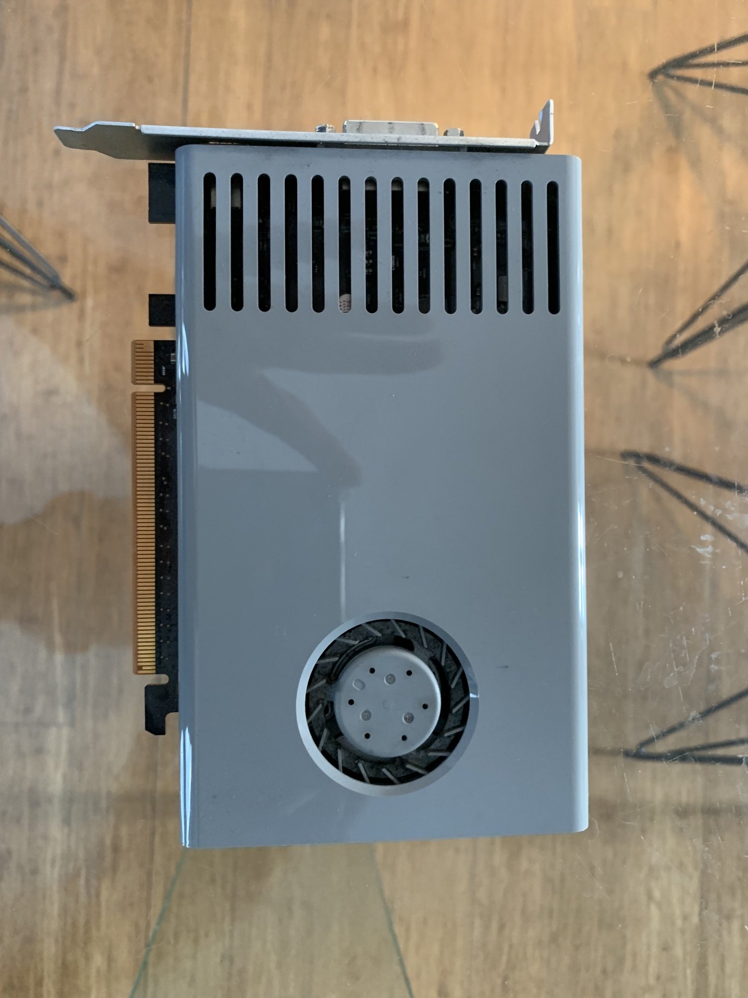

Is this the card I need?

GPU seems to be working fine but boot incredibly slow. Progress bar took over an hour to get to 100% and now it seems like it's stuck there. Assumed I'd be able to boot from the High Sierra installer USB I already made but doesn't look like it.
I cloned the USB stick to regular USB hard drive and it seems a lot happier. Trouble is it behaves exactly the same as before I swopped the GPUs.

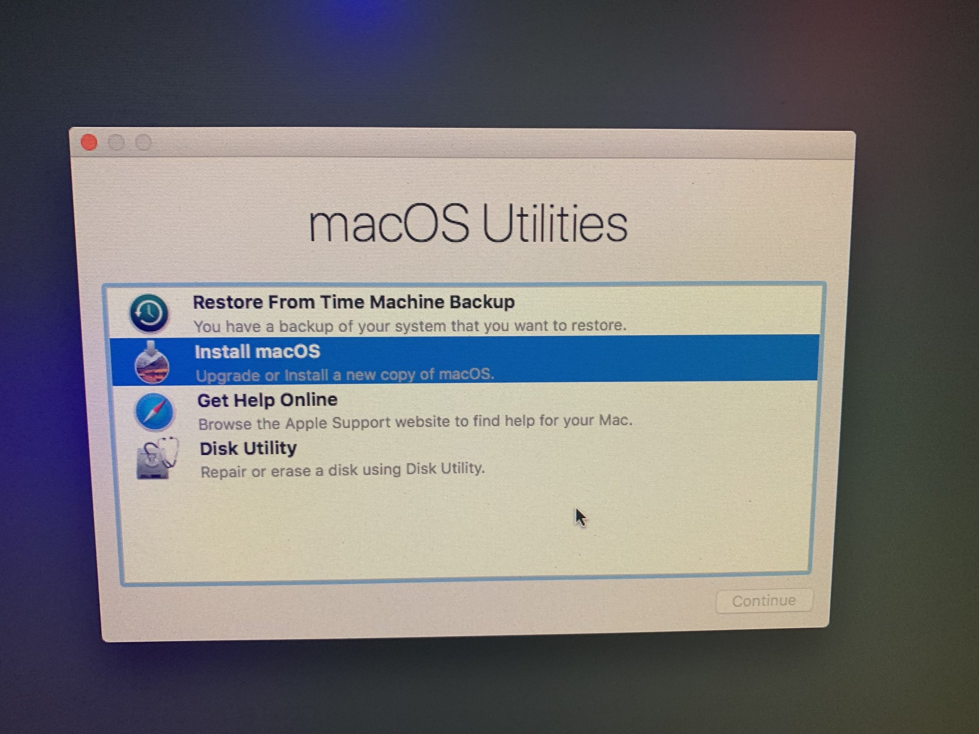

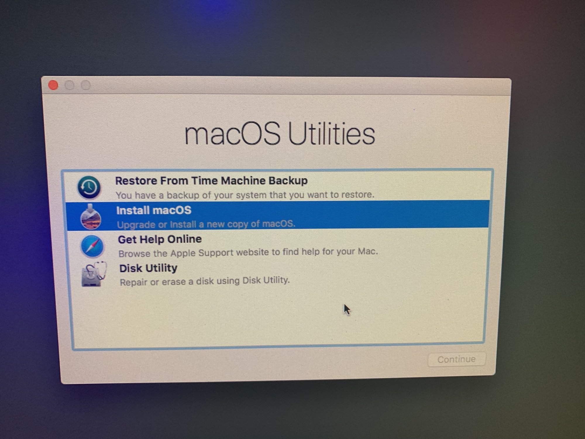

You remember I built the USB stick High Sierra installer (as explained by that Indian guy) well once I installed the old GPU and powered up with USB stick inserted the progress bar moved incredibly slowly - took over 1/2 hr to get to 100% then stopped there. I had force quit manually. When I relaunched I didn't even get the progress bar. I tried this several times with and without CMD+R & R but nothing except the Apple logo. I wondered if High Sierra might not read SSD USB sticks so I cloned the stick onto a regular mechanical USB drive (using Carbon copy cloner). It seemed to make a difference and the machine started up a lot quicker and this time took me to the Utilities window (see pic). The Install macOS never seems to do anything as far as I can see and the other options don't help.

This is the macOS installer screen, just go on. Btw, even with a extremely slow USB key, I can boot a High Sierra createinstallmedia USB installer in less than 5 minutes.
