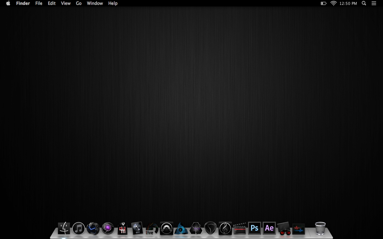

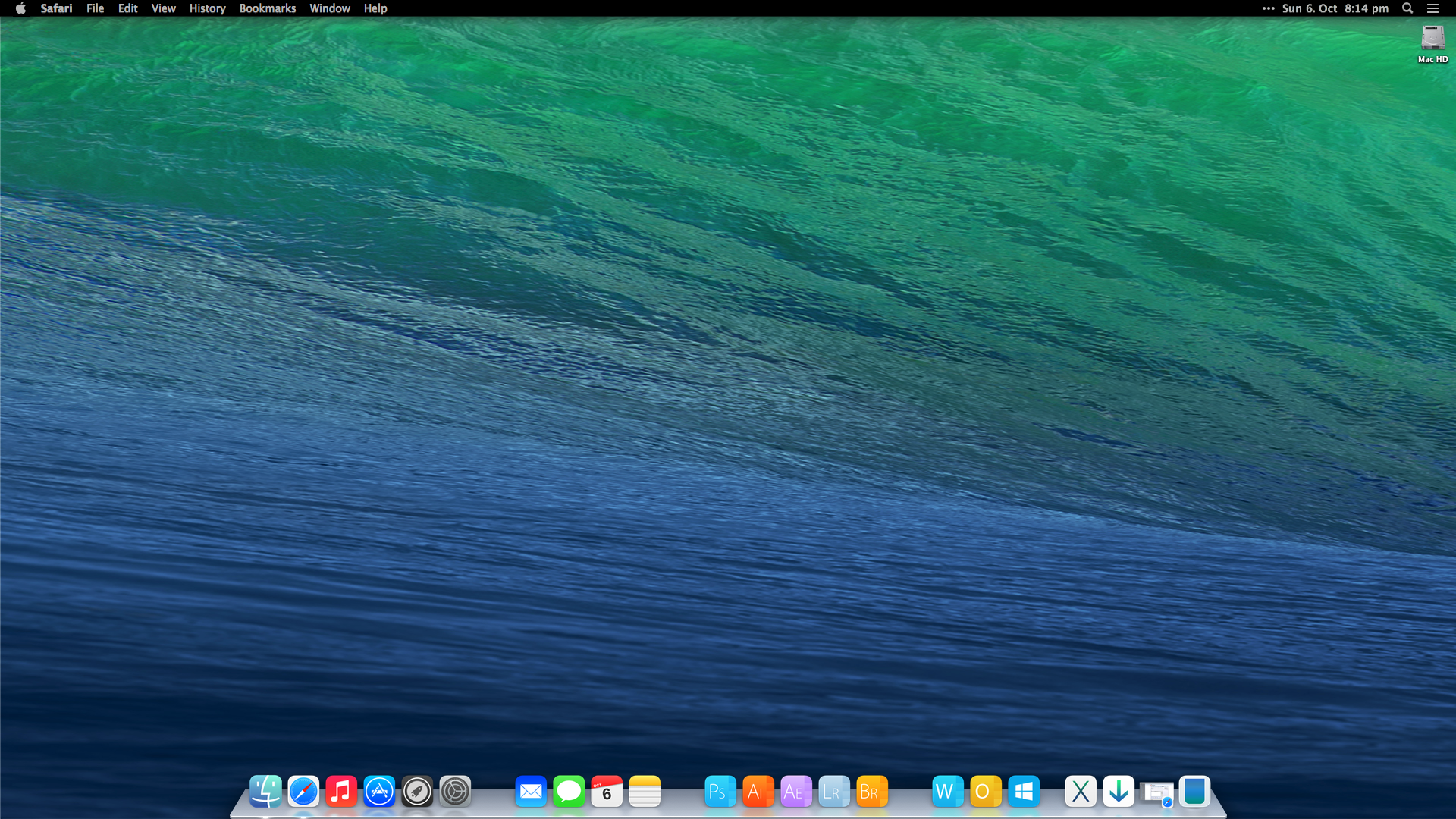

Thanks. Here's a fresher looking dock. Ive PM'd you some details
That looks great! I've found a bunch of good iOS7-style icons on DevART but can't find that Lightroom icon anywhere. You wouldn't happen to have a link, would you? Also, how did you get the empty spaces in your dock? I'd love to organize mine a bit (system/media/CC/etc, like you've got yours) ... Actually I sent you a PM just now but I'm sure I'm not the only one who'd like more info 😉
http://lifehacker.com/5993307/easily-add-spacers-to-your-macs-dock
http://maxa11an.deviantart.com/art/iOS-7-Adobe-Icon-Set-png-and-icns-401165296
