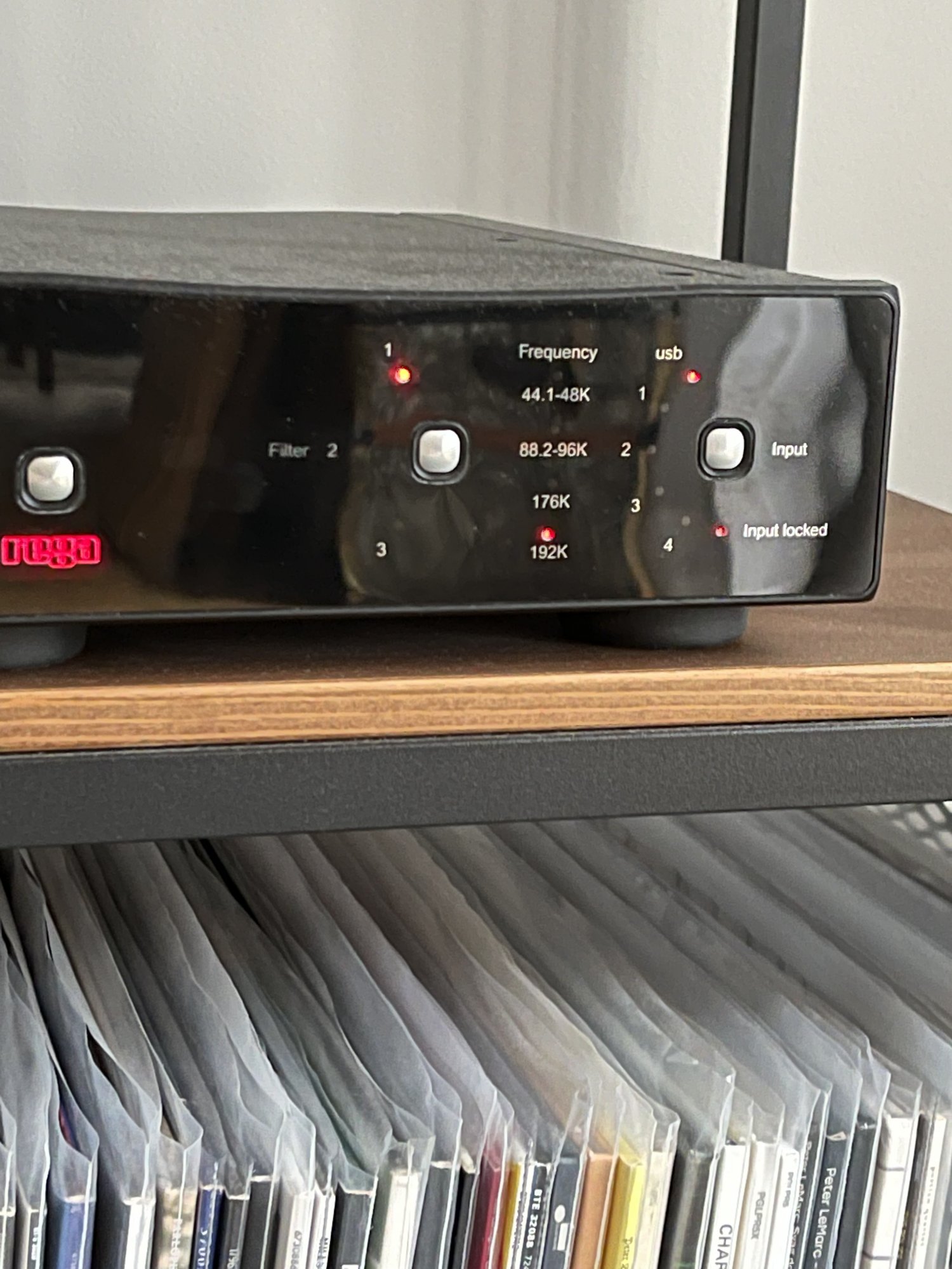

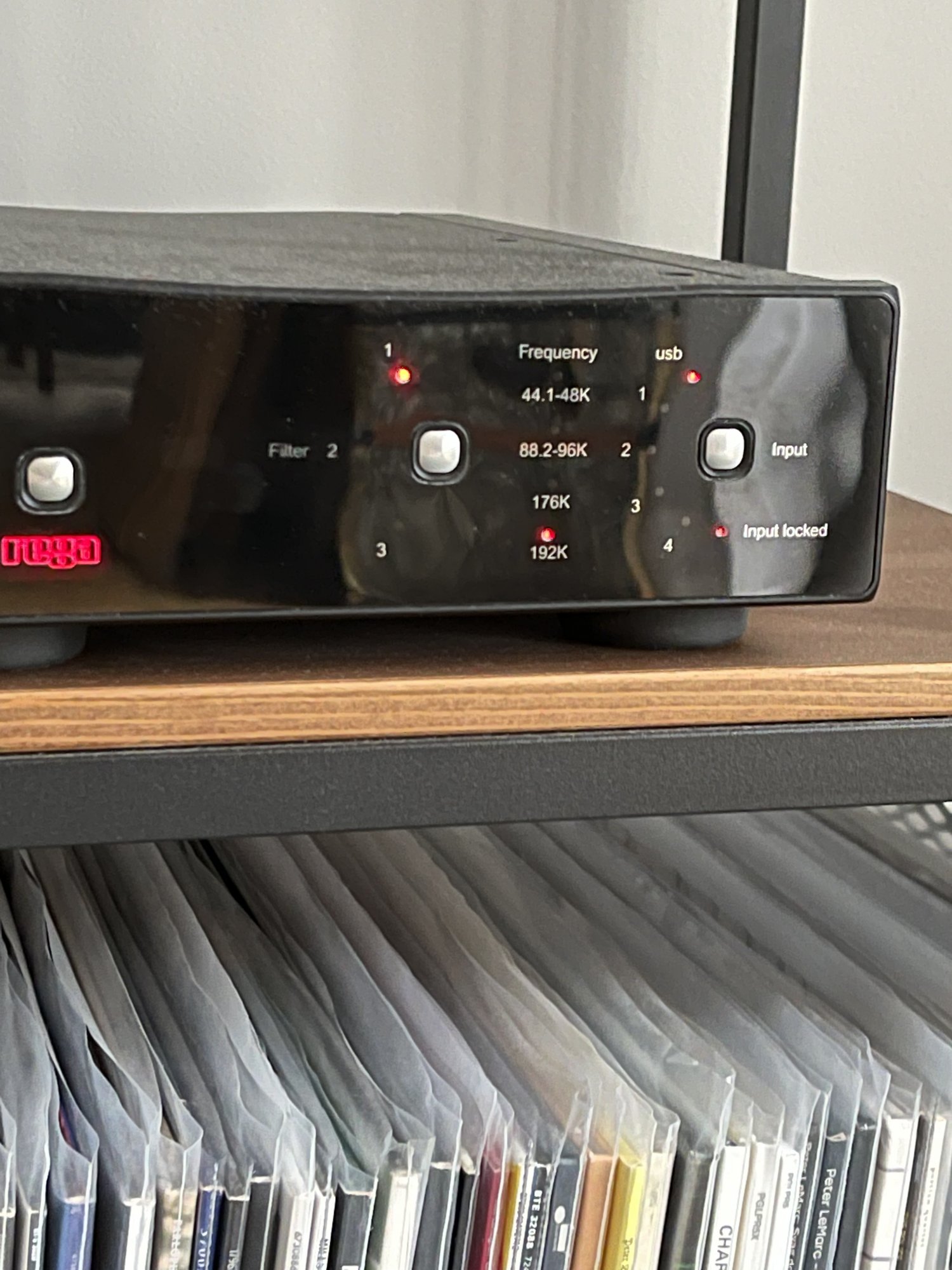

I have used the lightning adapter for years to play high-rez music from my iPhone/iPad on my hi-fi and I know for a fact that the adapter sends raw data to my DAC. please note that the adapter don’t ”add” anything to the stream, there’s no need for it to support this or that resolution or format. It send raw data, it’s the iPhone and iPad that sets the limits of formats to be played.
Attached image shows that my DAC receives a 24/192 Apple Music stream from my iPhone with the aid of the usb adapter.
