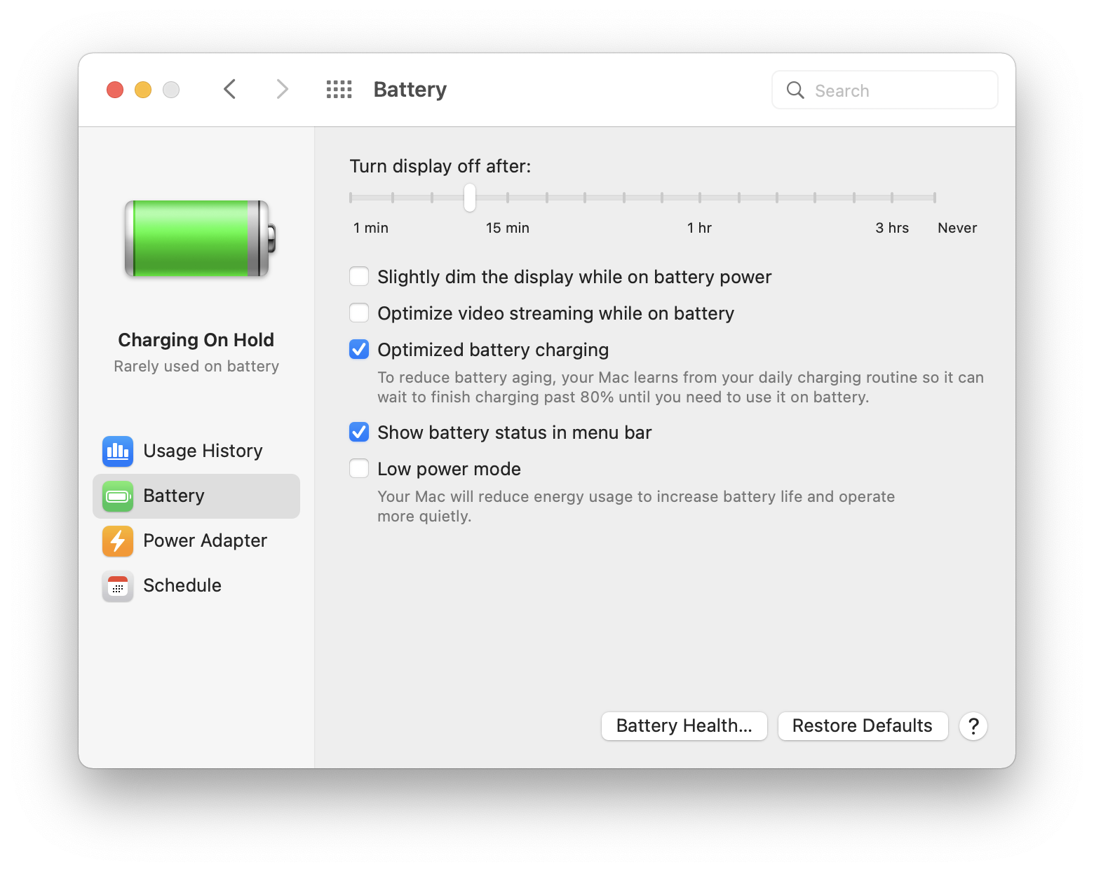

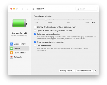

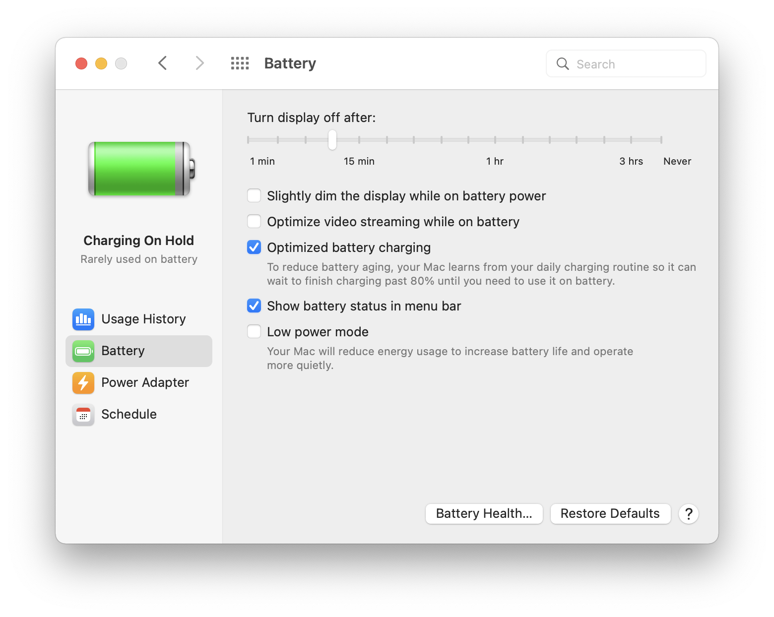

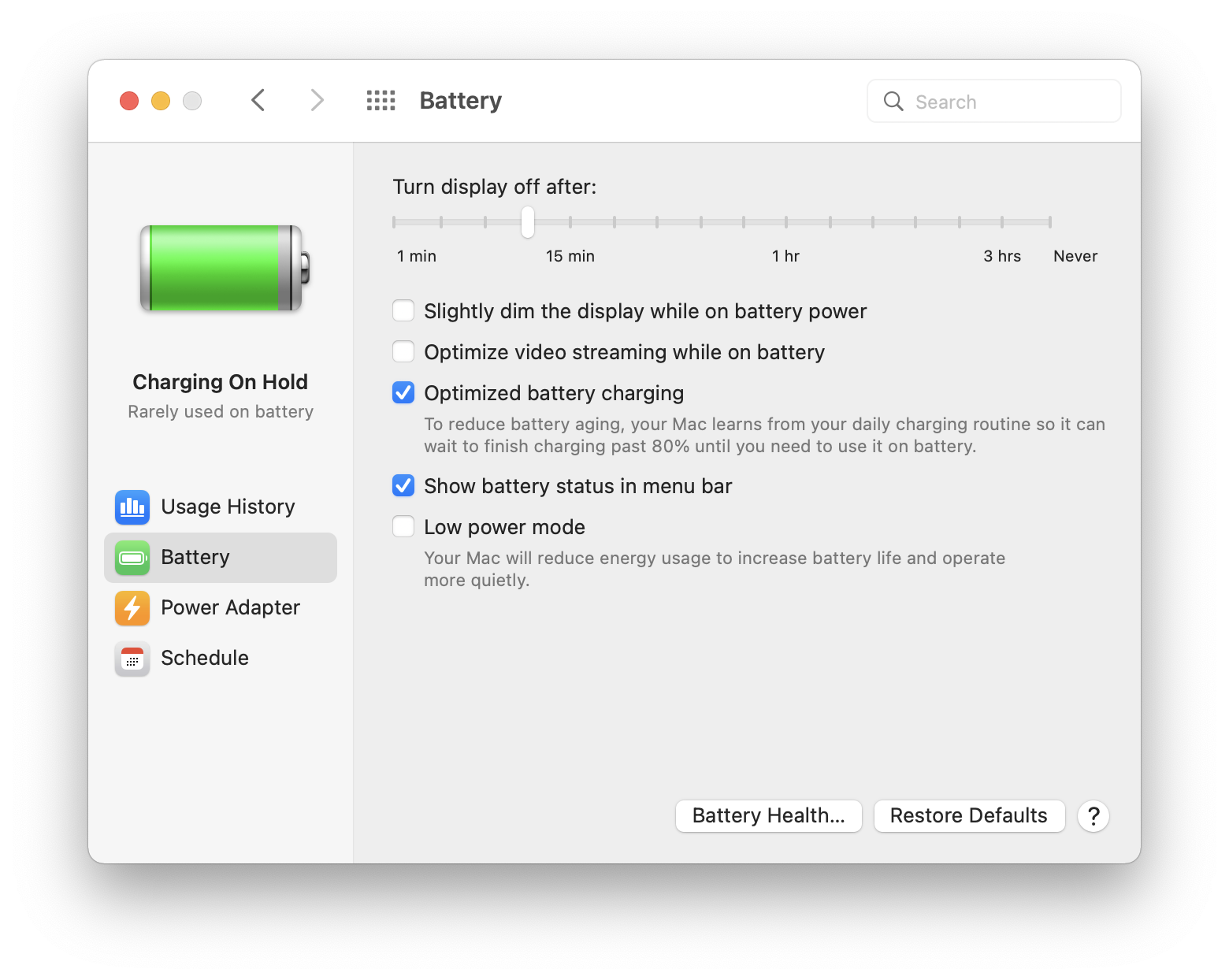

Go here and turn on Optimized battery charging and the OS will take care of it for you.
If you have a predictable schedule or plug in the MBP all the time, then optimised battery charging works very well. It will take a while for the OS to learn the pattern, after which it is good to go. I started using this in Big Sur.

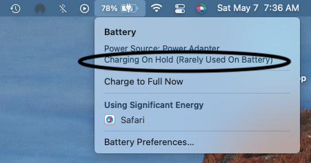

Adding the picture for future reference for anyone having the same question.
After using the laptop for @2-3 weeks on continuous charge.
