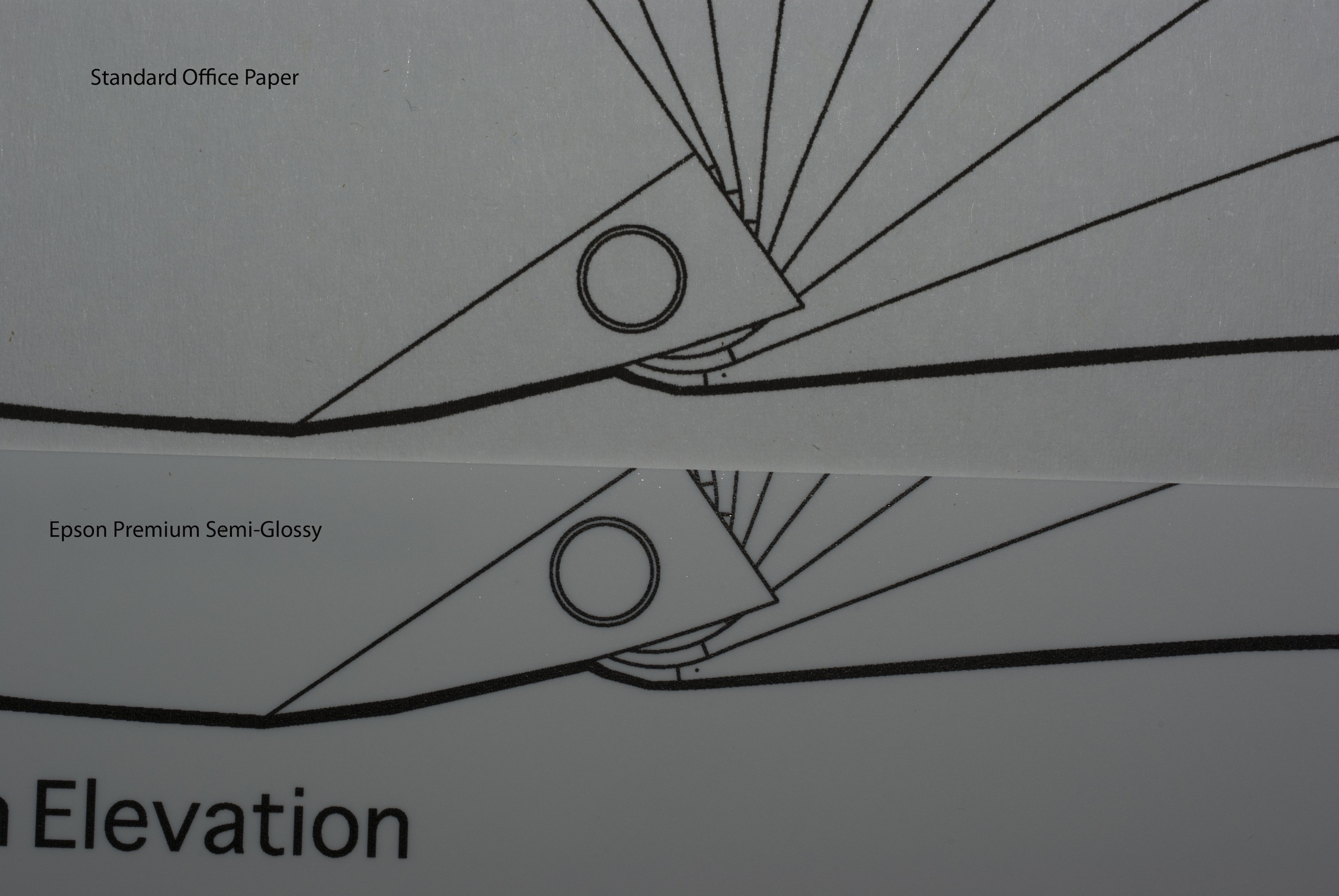

Ok I've found some Epson samples that I had from another printer (2009). I hace printed the same file with the same settings on each page. Below are images of the prints.
The files was created in ArchiCAD, then exported to PDF at 1200DPI (my printer is 1400DPI, the next option in ArchiCAD is 2800DPI...
Correct me if I'm wrong, but are these prints 'almost' vectors because I'm printing near the maximum that my printer can output?
Anyway, as you can see because the Epson paper is coated, the ink has not 'spread' resulting in a much cleaner line. Only thing is that the Epson paper is not as white as the other paper... At least now I have proof that a coated paper gives better results (as posted earlier).
I also have a sample of Epson heavyweight matte paper, which is brigher than the semi-gloss but I have yet to test that out (I'm in the process, will post tonight)
Let me know what you think.
Thank You

Yes, coated paper will give better results. My point earlier is that "coated" does not always mean "glossy." Even the matte paper I use is coated so ink does not spread. (Don't print on copier paper.) I am happy you found something that offers satisfying results.

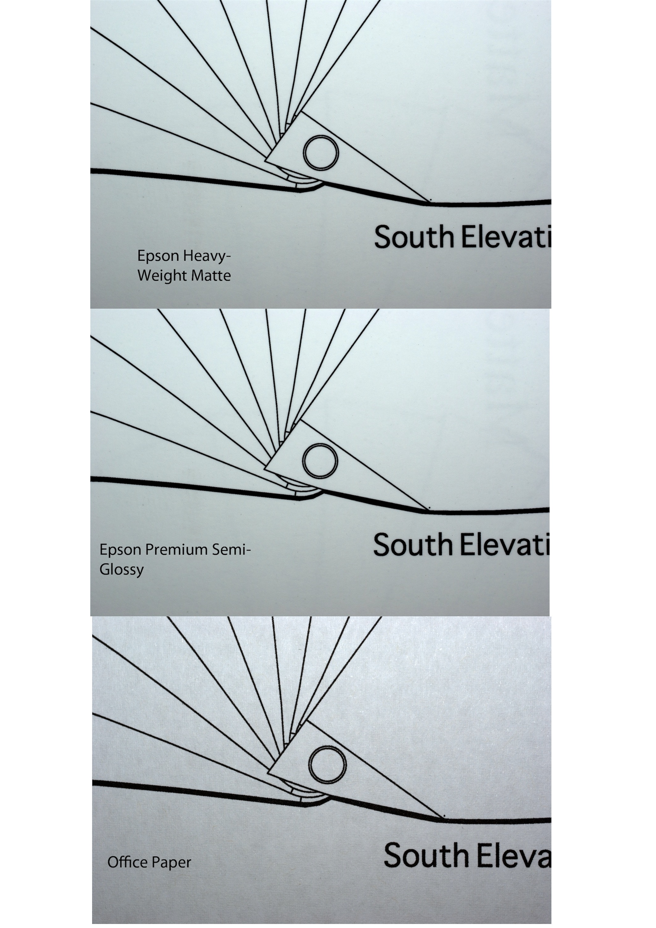

Yep, the Semi-gloss is great, but it's slightly yellow. I'm going to try the heavyweight matte too. If that's not as good as Semi-gloss, I will try a different (premium) brand that offer semi-gloss in bright white.
Thanks for your help.
And here's a comparison of:
Office Paper
Epson Premium Semi-Glossy
Epson Heavyweight Matte
Overall the semi gloss is better but in real-life it doesn't look white enough. The matte is slightly cream but the semi-gloss is slightly grey looking... I guess I need choose which I prefer...
Maybe if I can find a bright Semi-gloss, that will work but I prefer to stay with Epson brands, as it's an Epson printer therefor the profile work better etc.

I spoke to Epson (Online chat) and they said that the semi-gloss is the brightest. Whilst I can see that it seems brighter, because light reflects off it, I'm not sure the whiteness is quite what I want. The Matte is also fairly bright, however it's slightly yellow. Having said that it depends entirely on the lighting conditions i.e if I place the sheets on my window ledge, the semi-gloss is noticeably brighter...
I've heard that HP bright white is used by Architects but again, I prefer to stay with Epson.
I think Kwill nailed it with the second post. In my experience (dealing with Architects plans as a designer) when CAD programs output to PDF they use vectors.
