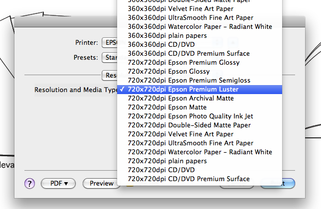

I've just received the Epson Photo quality inkjet Matte coated paper. It doesn't seem that 'special' but it does have a nice smooth finish to it, once I've printed the same image out as before (above) I will use my macro lens to closely inspect it...
I'm printing from Adobe Acrobat 9, and today for some reason, I have an option to select media type and resolution (attached). Before I could only select media type, do you know how/why I all of a sudden have these other options?
Thank You

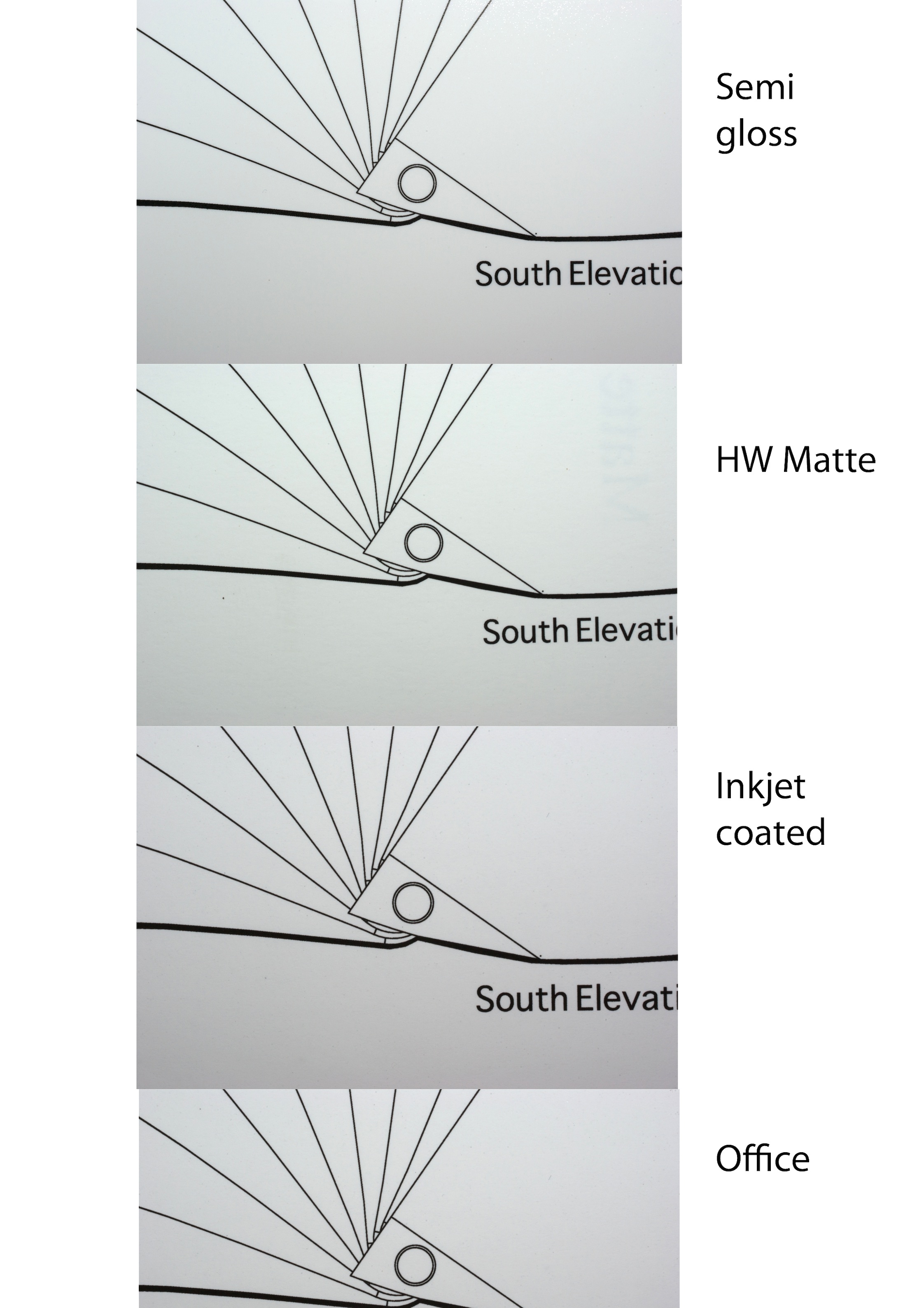

And here are the final results...
The Gloss still wins but it's overall not a bright paper. I think the coated inkjet and heavyweight matte are very close, obviously the office paper is last.
Tell me what you think 🙂
