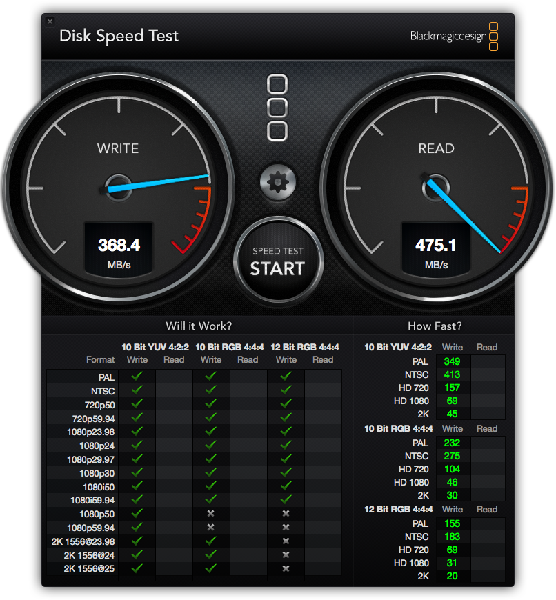

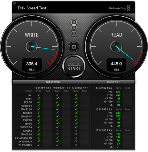

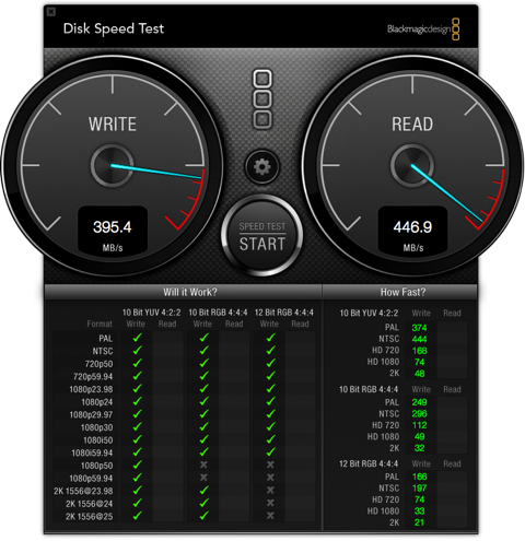

I've seen some of the benchmarks but I have no idea what they mean compared to whats out there...so my question is how are the SSDs that apple uses for the 768Gb configuration? I'm assuming they arent top of the top but are they noticeably deficient compared to things like the Samsung 840?
What benchmarks have you seen?
This:
attachment.php
IIRC the Samsung is a bit higher, in the low 500s I think, but I dont know if this makes a difference for speed of opening apps and files etc
Thanks. Yeah the 840 Pro is faster still by about 100 MB/s.

Just about nobody really cares, right? 😀 The 2012 iMac is likely using a Samsung 830 anyway. It's more than fast enough for 99.9% of people. If you really need ridiculous speed, RAID0 SSDs in Thunderbolt enclosures is the way to go, and then the 840 Pro can't touch that.
That looks pretty good to me! 🙂

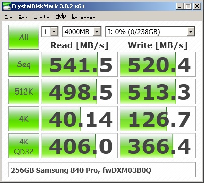

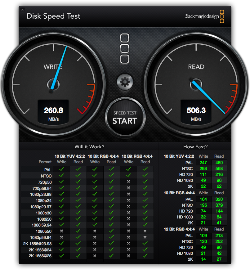

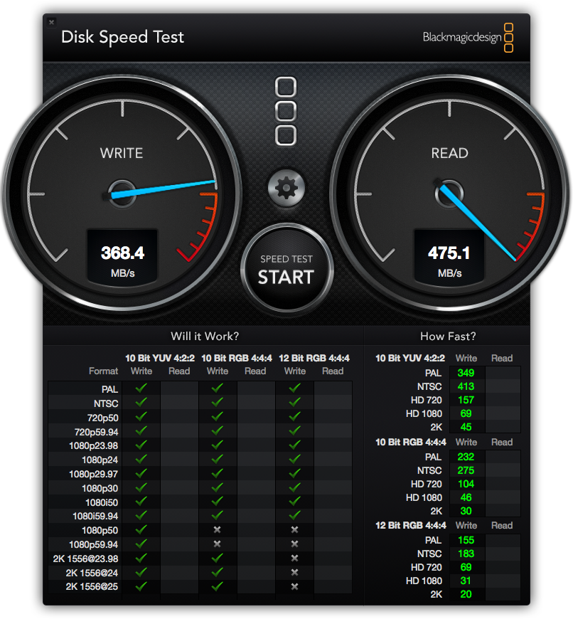

Just for comparison using the same test program, the following test results are on a Velocity Solo x2 PCIe card in my Mac Pro (SATA-III). One is the popular Crucial M4 512GB SSD, the other is a Samsung 840 Pro 256GB SSD:
-howard
Left: Crucial M4 ------------ Right: Samsung 840 Pro

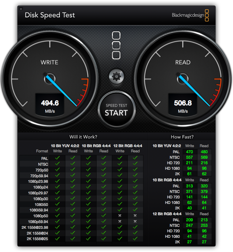

Here is my test of the LaCie "Little Big Disk" enclosure with a pair of Crucial M4 512GB SSD in RAID-0. It should be noted that I purchased a "refurbished" LaCie and removed the hard disks and installed the SSDs in their place. I am fairly confident that the reason the LaCie enclosures are "refurbished" is that they are dumping the old SATA-II bus units. The new LaCie units claim to have been upgraded to SATA-III internally ... but of course they are much more than the refurbished ones, and are probably faster.
I also show a test of a 2012 MacBook Air 13" with the 512GB internal blade-type SSD.
I wish I had a pair of Samsung 840 Pros to try in the LaCie RAID-0!
-howard
LEFT: LaCie RAID-0 SSD ---------------- Right: MacBook Air blade SSD

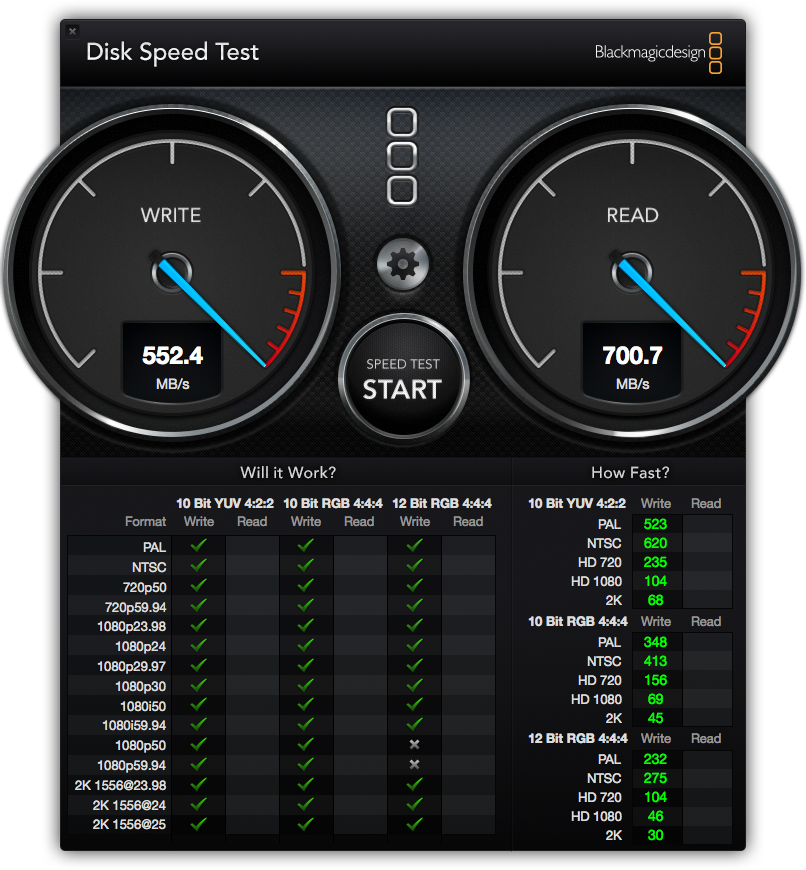

Here are a couple of Lacies LBD SSD connected via Thunderbolt in Raid0 to a MB Air. Quite happy with them...
Is that the current 1TB LaCie SSD drive or a DIY using their enclosures?
Are you using 2 LaCie LBDs in a 4-SSD RAID, or a single 2 drive unit to get those speeds? What disks are you using in them? Those are pretty impressive results.
