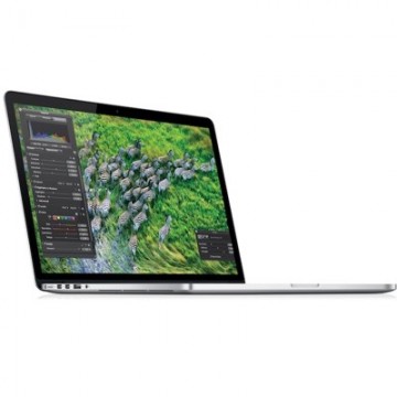

The ID on the bottom is A1398 EMC 2512 which I can only find listed with SSD, which I'm not sure I can access like a removable HD:
At this point I could just remove the bottom and see what's in there. I also think I have another charger for this that I can try, just in case the main one doesn't work. I think I'll also see what the local Apple Store can do.
