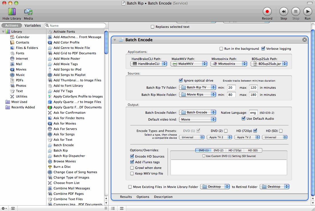

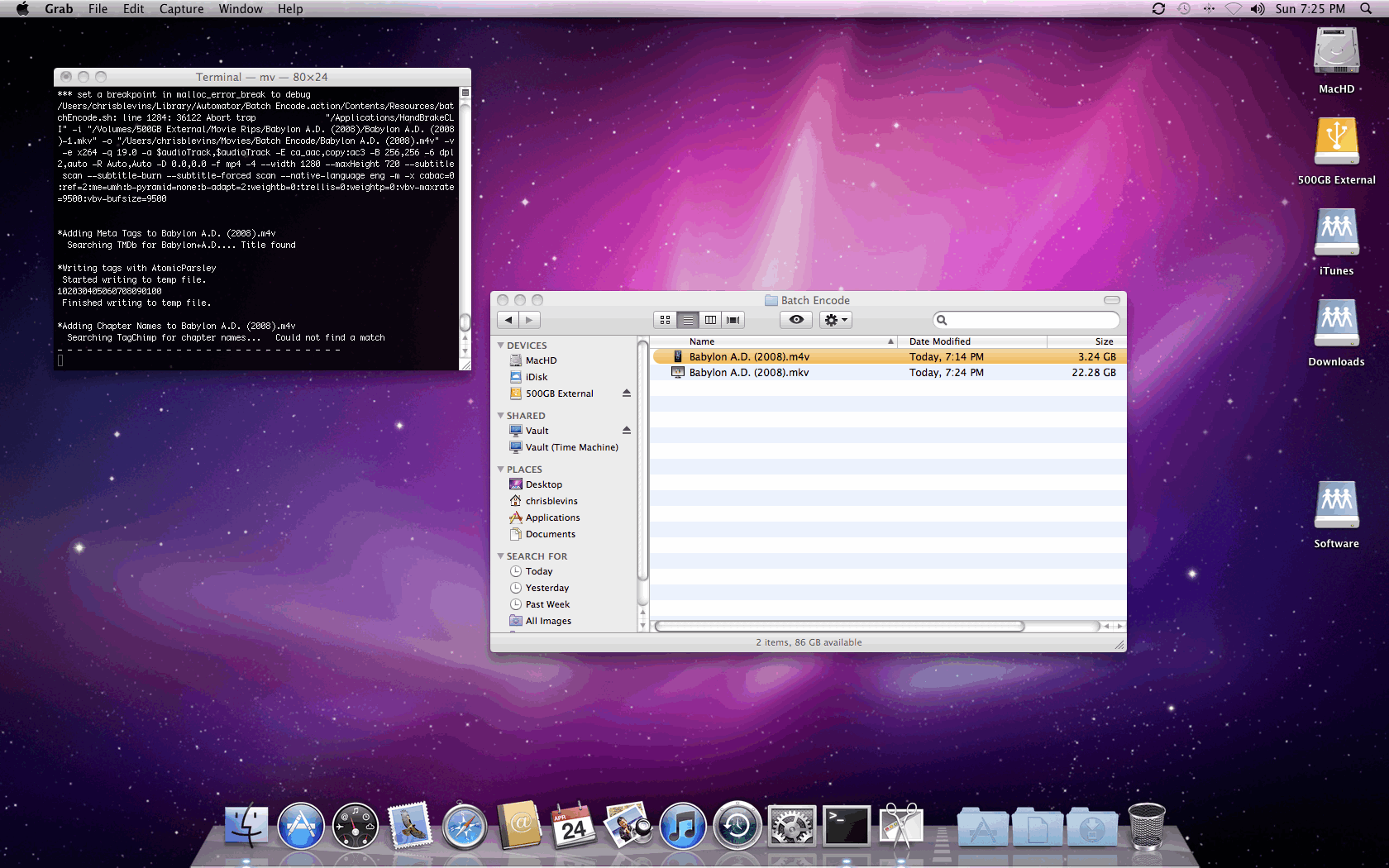

I'm having a strange problem. Whenever I batch encode the mkv's from the blue-ray ripper, the encode script is copying the original 30-ish GB file from my Movie Rips folder on my external hard drive to my Batch Encode folder on my internal drive where I have the results being created. This is in addition to copying the 'real' encoded file over. It doesn't copy the original file over until after the Adding Chapter Names via TagChimp step.
Note that this doesn't occur when I use the scripts for DVDs, only Blue-Rays. See the attached screenshots for my settings. Anyone have any ideas? My custom 720p line is this:
Code:
-e x264  -q 19.0 -a \$audioTrack,\$audioTrack -E ca_aac,copy:ac3 -B 256,256 -6 dpl2,auto -R Auto,Auto -D 0.0,0.0 -f mp4 -4 --width 1280 --maxHeight 720 --subtitle scan --subtitle-burn --subtitle-forced scan --native-language \$nativeLanguage -m -x cabac=0:ref=2:me=umh:b-pyramid=none:b-adapt=2:weightb=0:trellis=0:weightp=0:vbv-maxrate=9500:vbv-bufsize=9500
