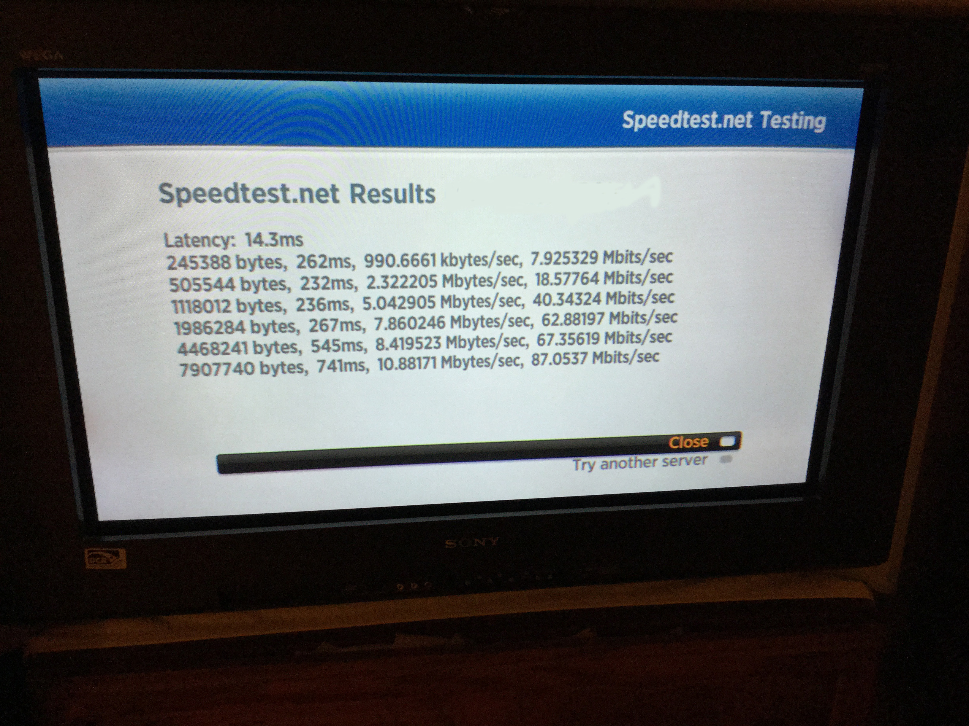

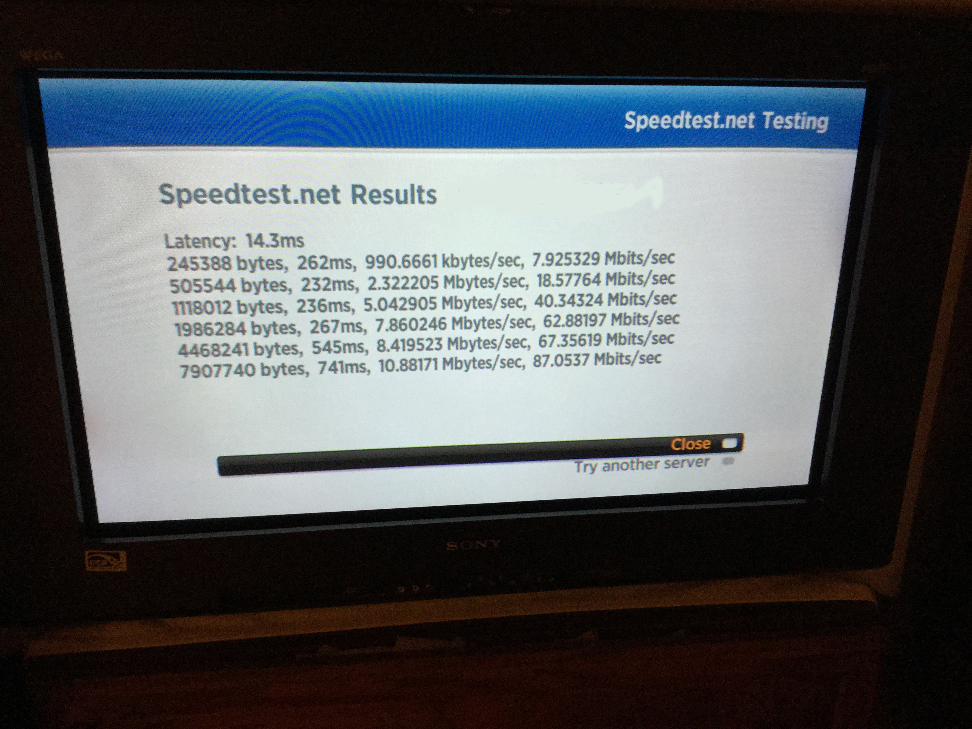

If you upgrade to 802.11 ac wireless I think you'll see a big improvement. With two old airport extremes, one 3 TB Time capsule downstairs and one airport extreme upstairs extending the same network, I was getting some buffering problems in Plex Media server running on my Roku box when set to the 20 Mbps option. Data rates were running from about 26 Mbps down to about 12 Mbps.
Some of my devices upstairs don't support 802.11ac and therefore I need to connect them to the airport ethernet ports.
After replacing the older airports with the 2013 Apple Airport Extremes which support 802.11ac I saw a dramatic improvement in results as shown here with the Roku box speediest results.
The first two results for some reason are always slow. It's between 2 and 8 times faster. No buffering issues at all now in Plex.
I purchased them from the Apple refurbished site and saved $170 off the list price for the two airports.
