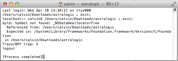

I had no need for doing C# development myself, and chose instead to rewrite the utility based on your code in something I needed to get some familiararity with, so I rewrote it using Swift 4.1 as a simple command-line tool.
Source code inlined, the zipped executable is attached. Swift is something I've no real experience with so those critical of the source make constructive not corrosive comments.
EDIT: In case you're wondering why such a simple utility produces such a large executable it's because Swift packages in the Swift Standard Library in order to be executable on older systems such as yours.
Be aware that this has NOT been tested on anything other than macOS 10.13.5
You're the man Lloyd, thank you.
The program itself doesn't work in this old OS which is absolutely fine. I'm not asking for help to get it working on this old OS in any way. I'd just like to know if the error that was displayed looks normal, i.e. is this error confirmation that the program doesn't work just because the OS is old?
Also are there any software requirements needed to run a swift program? I just want to make sure that something unexpected or unusual hasn't happened.
