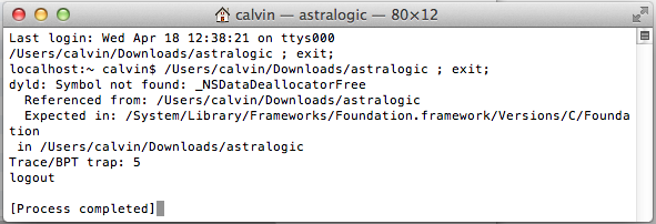

The program itself doesn't work in this old OS which is absolutely fine. I'm not asking for help to get it working on this old OS in any way. I'd just like to know if the error that was displayed looks normal, i.e. is this error confirmation that the program doesn't work just because the OS is old?
Also are there any software requirements needed to run a swift program? I just want to make sure that something unexpected or unusual hasn't happened.
It appears I misread your Macs OS version, I mistakenly read 10.9, which happens to be the cutoff for Swifts backwards compatibility. So you're one revision to far back for this solution to be of use.
My apologies for wasting your time, I learned several things so it was still of benefit to me.
I assume your Mac is not 64 bit capable and thus not updatable to a newer version of Mac OS or you would've done so, correct? But if that were true it should not have proceeded to run on your machine as far as it did!
EDIT: Would you mind sharing what Mac you're using? For instance the machine I am currently on is the iMac17,1

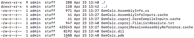

Hmm... I'm wondering if I even did build an executable. In my debug and release folder I have the same five files listed below:
As you can see I also renamed the program. Are one of those the executable? I was expecting no filename extension for the file, like the one you built.
Within the project folder itself are two folders called "bin" and "obj" each one contains a "debug" and "release" folder. I listed the files in the "debug" folder that's in the "bin" folder.
In the "obj" folder, the "debug" and "bin" folder both contains the same files as each other again but in "obj" the files are different, shown below.
