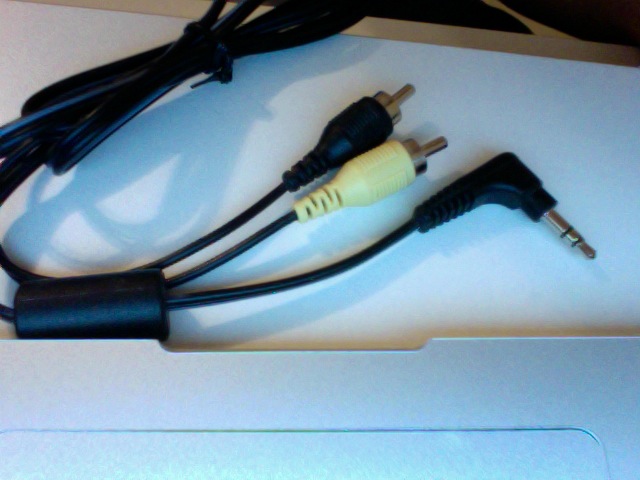

Question: I have dug up a cable that looks like a 3.5mm to Stereo RCA Cable, however mine appears to have..well take a look.
gnky
While the ones I have seen have black and red jacks.
Is there a difference? Isn't it just if you input it right or left? I don't know what I'm saying, actually. So some clarification would greatly be appreciated. Thanks.

Shouldn't make a difference, probably just color coded from whatever device it was from. If it doesn't work, well nothing bad will happen, it just doesn't work...
Yours is for a camera, with the yellow for video and the black one for audio. It might still work, and it probably won't hurt to try it.
Looks like a normal 3.5" audio jack. Unless it's something special like for a video camera and the yellow is for video (like posted above) and the other is for mono sound, however, I've never seen anything transport video through a 3.5" jack other than the cables Apple originally used to get video out from the iPod Videos.
Other than that, the color's can be pink and orange, it doesn't matter. There's usually always at least the black cable and one other though. They are just for left and right audio signals, so with a cable like that you can plug it in, listen to it, then switch them if the sound is coming out the wrong sides.
For example, if it was RCA on both sides (the 2 cables on both ends), you could have black going into the red port, and red cable going into the black port as long as you connected the other side in the same way (just like jumper cables for a car battery the colors are just there to help, but if it was connected "wrong" in the same fashion on both ends, it would still work the same as a "correct" connection).
Canon cameras, and probably others, use a cable like that to display images and video on a TV. I have a cable like that somewhere, and if I find it I can test it to see if it will work for audio.
I dug up my Canon AV out cable, and it looks just like the one pictured in icedd's post. Electrically, it matches a 3.5mm to RCA cable. The yellow plug corresponds to the red one, and the black plug corresponds to the white one. I haven't tested it with audio, but I don't see any reason why it wouldn't work.
Oh okay I see now. Yeah I was just hoping it could work for audio since I already have the VGA adapter anyway. Save me a hassle for buying one, aha. Thanks!
Hey, thanks so much for testing it out. I haven't had much to do it but after exams, I will definitely check it out. Appreciate it! 🙂
