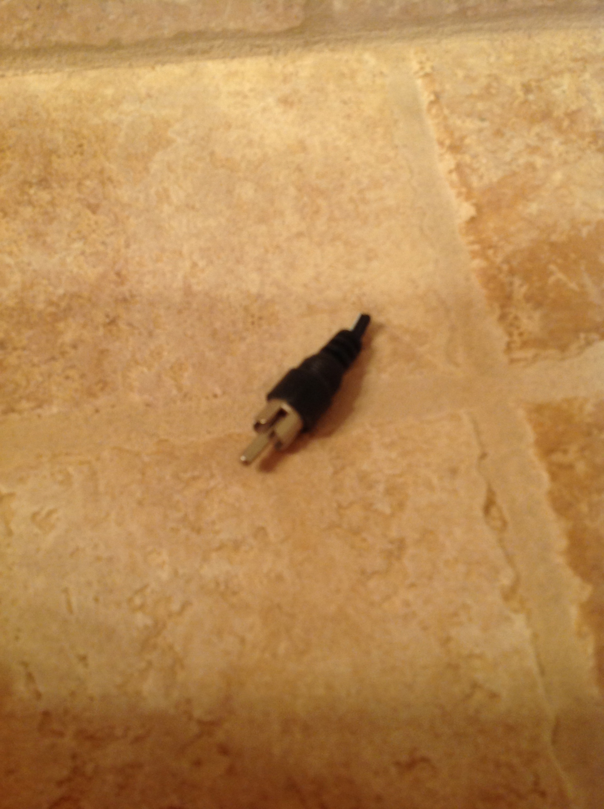

But I have some rear speakers that were used and connected to this Aiwa when it was used as a stereo system back in 1995. I want them to be connected again and use with the working 2 side speakers. I know that even tho I can put them behind me, this will not be a true surround sound but if I can get some rear sound from them, I will be happy. Problem is the speakers are missing the connectors that used to connect them to the Aiwa. There is speaker wire coming out of the speakers but they need a connector end of some type - what is showing where they used to be connected to the Aiwa is a red and white "hole" like RCA connectors go in. Now the "hole" where they connect to the Aiwa is that color but the actual connector on the end of the wire is black. I have a picture of one of the ends that was cut off for some reason. This Aiwa has been sitting in the closet for years. Anyway I have attached a pic. Keep in mind that each speaker, right and left had their positive and minus wires connected to this end. From the picture, can you tell me what this is called so I can possibly go buy speaker wire with these ends already on? This may look like an RCA connector but you cant see in the picture that this end has the 2 speaker wires coming out of it.

If you are just looking to connect the Aiwa's the way they used to be, you would want plain wire (I believe that's what you said was on the speaker side) to RCA.
The connector you posted an image of is an RCA type. It does have two contacts - the pin & the outer ring (shield). When you connect the cables to your speakers, make sure to use the same color wire for the '+' on both (the two-wire cable should have one marked with a white or red stipe (or sometimes a texture - like a rib molded along the wire edge).
Some extension speakers are connected via RCA connectors, though most feed wire directly to the amplifier. RCA connectors are typically used for low-level audio - like connecting a CD player to one of the inputs on the amp.
Thank you. The rear speakers themselves have the wire connected to them and the end of the wire connected to the speaker is just coming out of the speaker, no connection, just wire coming out back of speaker. I just need to get a connector for the end that plugs into the Aiwa. I may need to splice some speaker on to what is already connected to the speaker to make it long enough to reach across the room to the rear of my seating. So if these are RCA connectors I hope they come with speaker wire already on them so I can splice to the length already on the speaker. I know this is a low level system but hey, it was just stored in the closet and my internal Sony TV sound was terrible.
