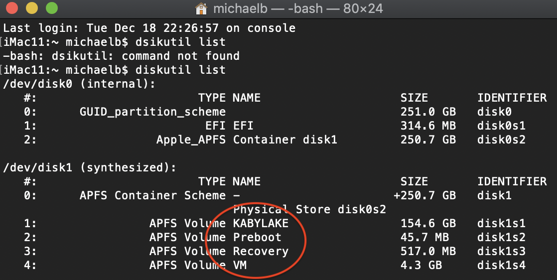

The only two ways I know of checking are:
1. Reboot holding cmd+R keys should boot to Recovery
2. type diskutil list into a Terminal window to see the screenshot attached.

It should show up as an item when you try the terminal command "diskutil list", as suggested in post #2 by Mike Boreham.

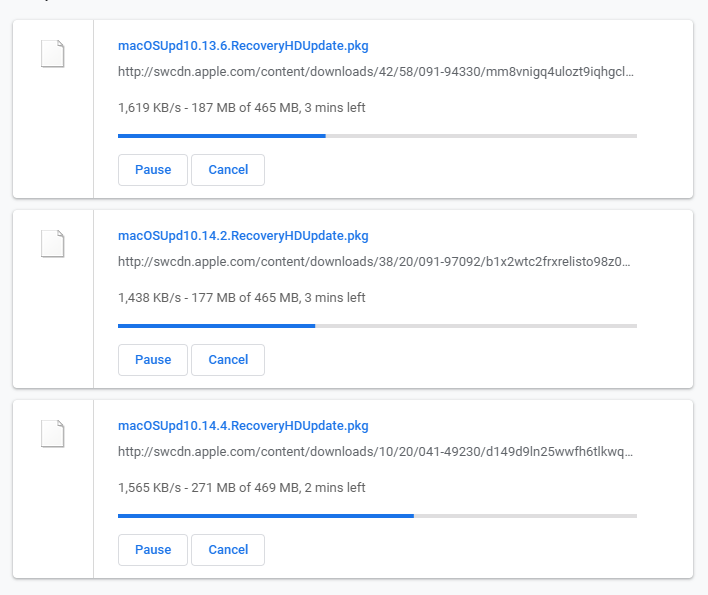

It is not unusual for an old link to go dead from the swcdn server when apple remove them. However as far as I can tell all 3 are still live. I'm downloading all 3 now:

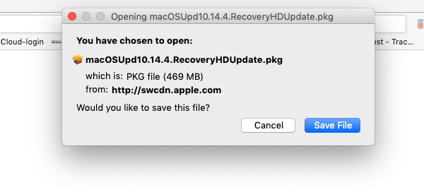

This is what I get for all 3 links, a blank page with this download prompt.
Using FireFox browser.
These links take you to the file itself - just accept “save file”, and run the package file once it has downloaded to your Downloads folder. If you are having trouble downloading these links with Chrome, and you don’t have Firefox installed, try opening these links and downloading them in Safari.
