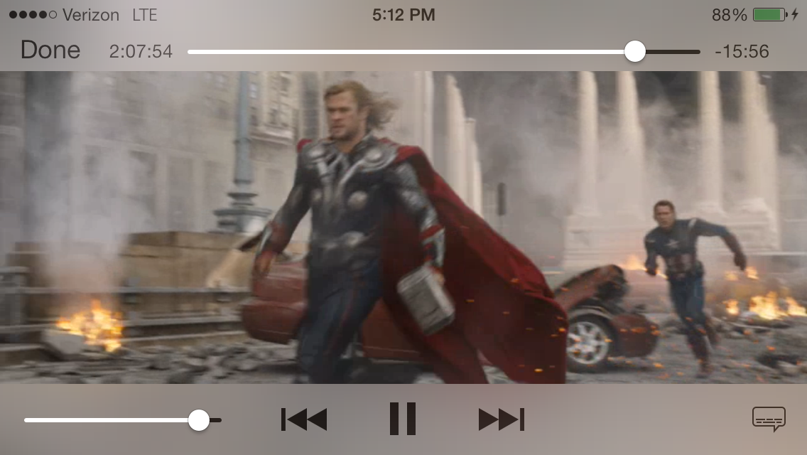

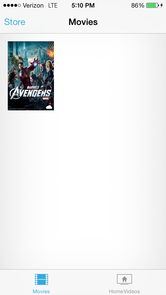

I don't know if it is a bug but I can't find any information on it. I could really use the 2GB this movie (The Avenger's) is taking up. I never downloaded it to my iPhone. I just remember seeing The Avengers and The Hunger Games in my movies through the Cloud on their own. And then one day I noticed even when not on Wifi I still had the Avengers and I couldn't delete it.

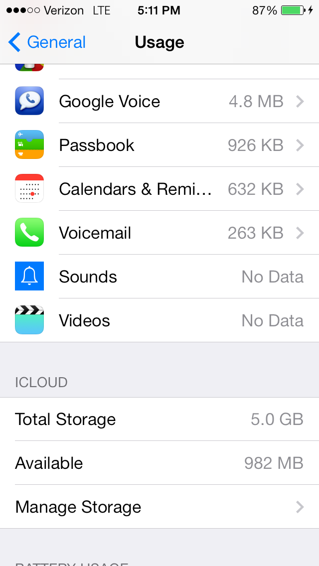

I know it is taking up storage because out of nowhere 2GB went missing. And when I added up the rest of the apps storage, 2.xx GB is missing. In my usage, the Video section says it contains no data.
I am attaching pictures of what I see and I do not know how to remove it. Swiping left or right does nothing.

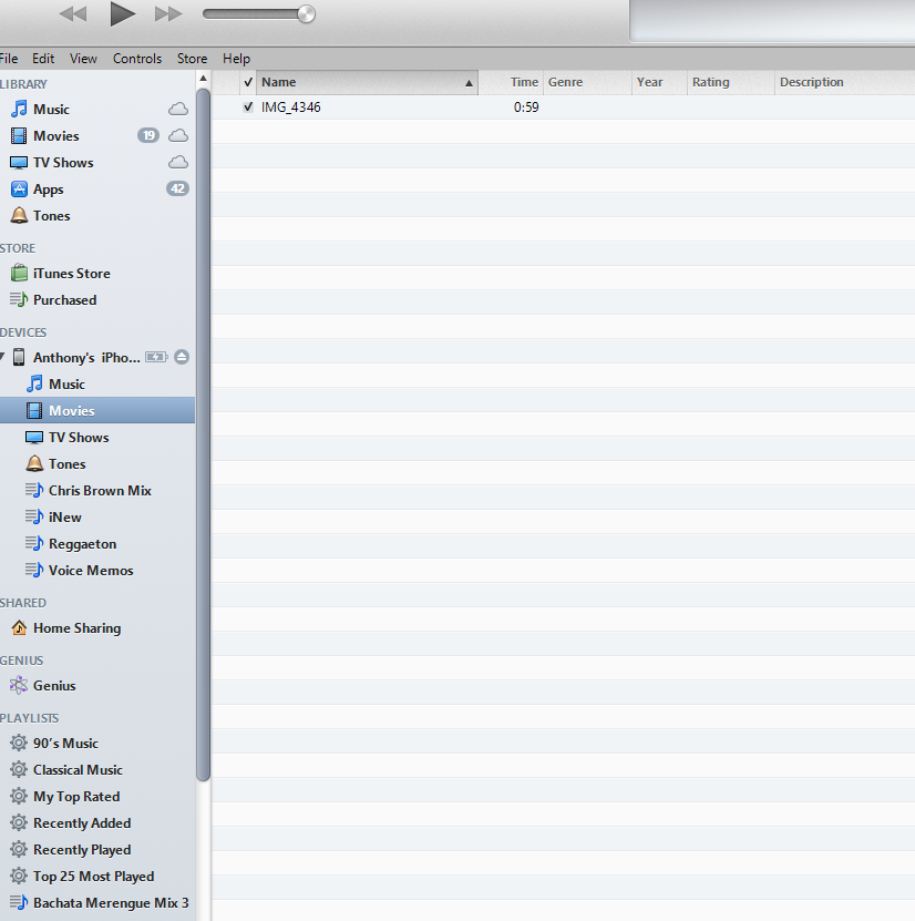

Can't you just un-sync it from iTunes? Just click on Anthony's iPhone, go into the Movies section, uncheck that movie and then sync.
Unsync it using iTunes.
How would I go about doing this?
When I go to my iPhone and click the Movies tab, it appears that I am not synced. I don't want to have to delete anything, but I remember I synced my iPhone with this current computer.

It looks like the movie is not actually on your device.
It's odd because there is a cloud on the thumbnail (bottom right corner) that shows that it is in the cloud and not on your phone. Have you tried restarting the phone? Reset all settings?

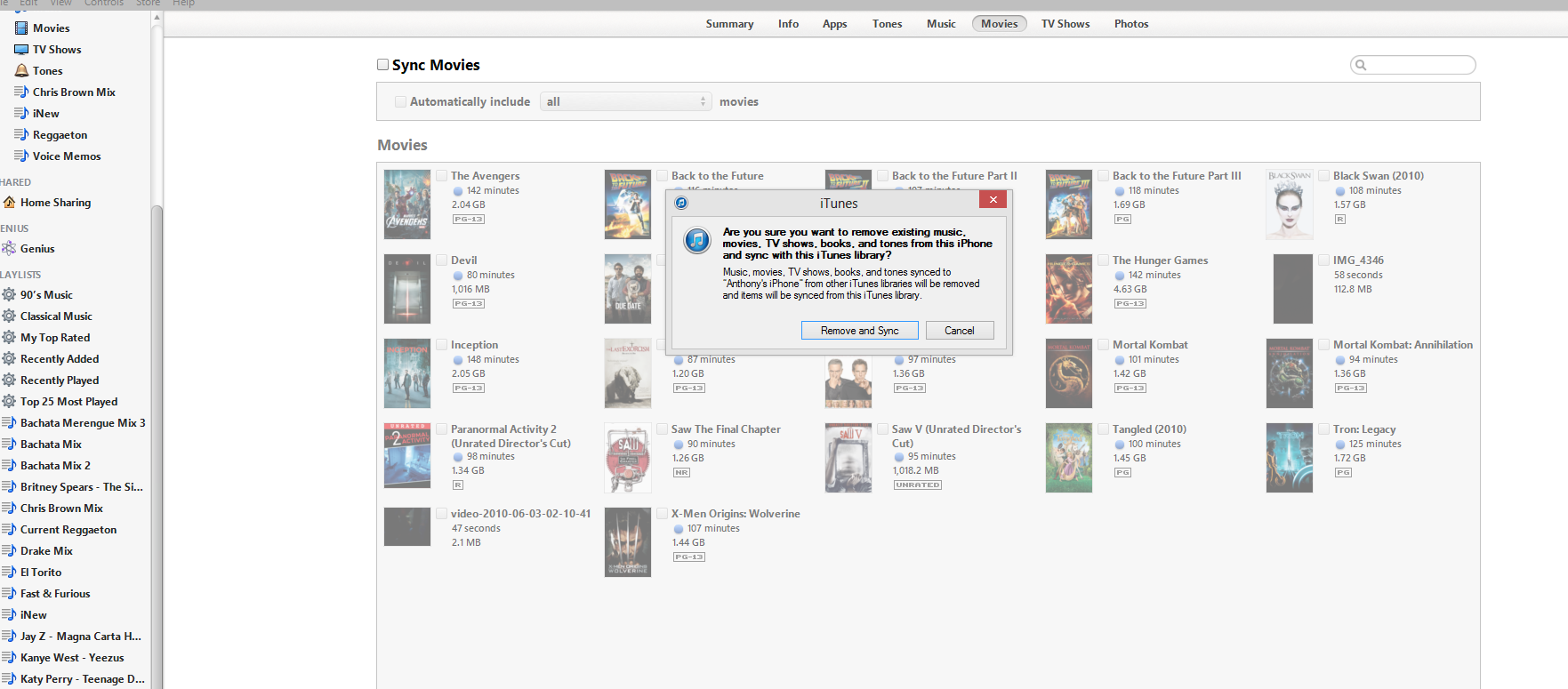

Go into iTunes, check sync movies and sync; you only need to sync one movie, not them all. Now uncheck and sync again and see if that removes it.

If you go to settings, then general, then usage and movies you can delete it that way. I had one movie and it would not let me swipe to delete.
