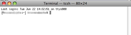

Ok that is what terminal looks like when I open it. Should I enter the code below the existing text? Or should I erase the existing text in the terminal and replace it with the one you mentioned?
