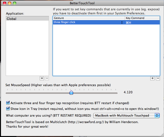

What is the command for middle click? I want to use the 3 finger click as middle click but I don't know the "key command"
Install the latest version of BetterTouchTool (0.317) and all will become apparent.
Thanks. I re-read the blog and it was blindingly obvious.
