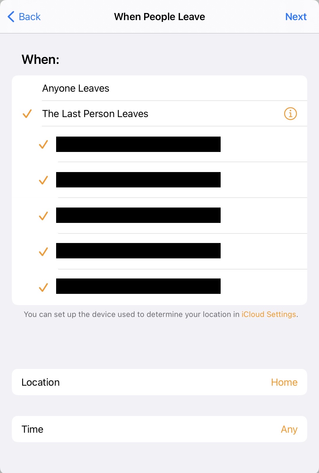

It sounds like you're creating a Home Automation, since Personal Automations are device-specific and can't, to my knowledge, check the location of other devices.
The two iPhones need to be using different Apple IDs, configured as the devices to determine the location for those Apple IDs, and both Apple IDs need to be part of the same family under Family Sharing. Then you should be able to create this Home Automation:
When: People Leave (The Last Person Leaves)

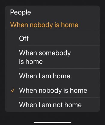

All 3 devices (2 iphones &!pad) have separate apple ID’s. The iPad is always home as it is mounted to the wall.

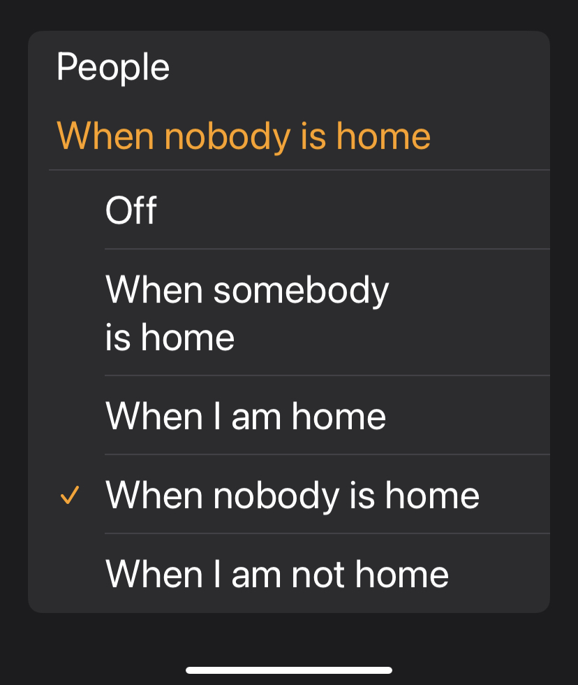

I am using a Home automation. However, the location options are limited. See photo.
I had originally set it to “nobody is home” for the 2 iphones but forgot about the iPad being always home. The automation will never trigger.
There is no setting when just iphones are not at home.

Which device are you trying to create the Home Automation on, and what version of its operating system is it using? Both my iPhone and iPad offer more granular options when creating a Home Automation in the Shortcuts app (iOS / iPadOS 14.6)
All devices are on 14.2. I have been hesitant to upgrade due to people complaining about battery issues. Hopefully 14.7 will fix that.
can you post a picture of the new options available in iOS 14.6 or 14.7?
This is what the dialog looks like in iPadOS 14.6 (lightly edited for privacy). You can uncheck family members that are not considered part of the rule.

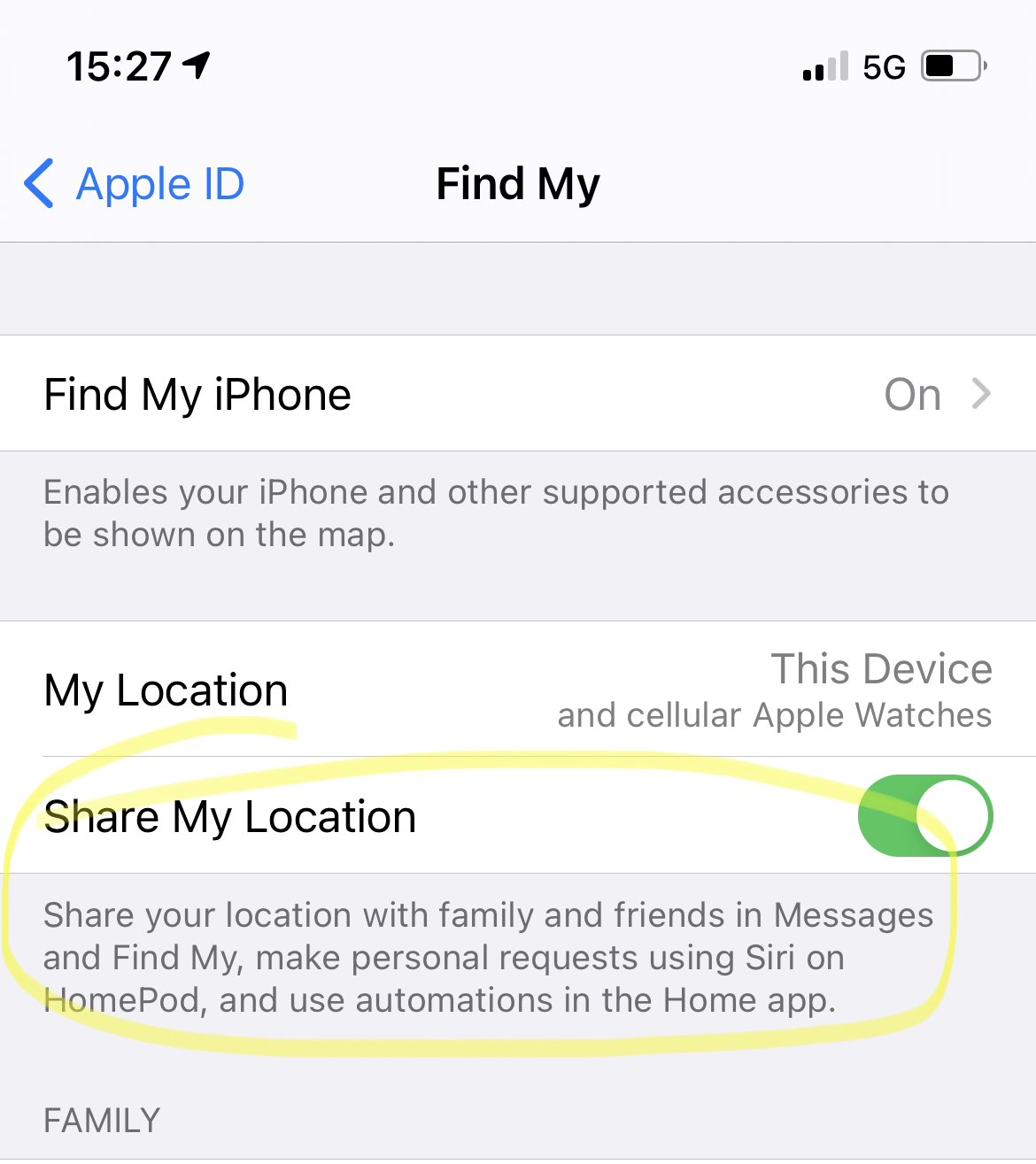

I just conducted several experiments. Everything works as it should when one iPhone leaves the house.
However, the automation fails if I set “nobody is home” (except iPad). The iPad has both “share my location” and the individual Location setting turned off under privacy->location services.

The iPad had “share my location” off as well Privacy>Location Services>Home turned off.
My wife’s iPhone was at her work however my iPhone was home but the above settings were turned off also. I wanted to be away from home also for the test but couldn’t make it happen.

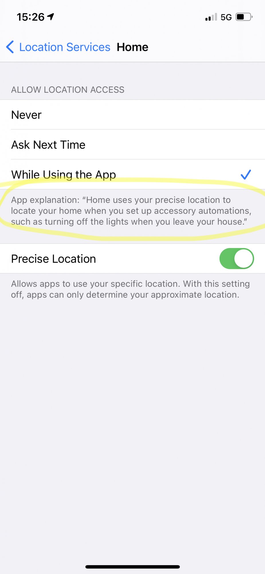

do I need to turn off the HomeKit setting in System Services also? I left that on both iPhone and iPad.
I had wifi off on my iPhone. I rebooted the iPad yesterday after I turned off the shared location settings.
Ya know, I think there were three location based setting that had to be disabled now that you mention it. Try disabling on the iPad only and see what happens. If not you can always turn it back on. Trying to remember if that was the third setting…
I turned off all location settings including the one in the system services section.

Second, I added the iPad back into HomeKit. I turned off all location settings:
Find my location
Share my location
Privacy>system services>home
Privacy>Home>never
