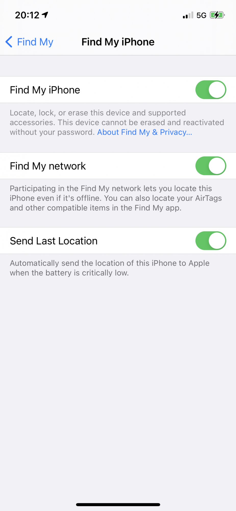

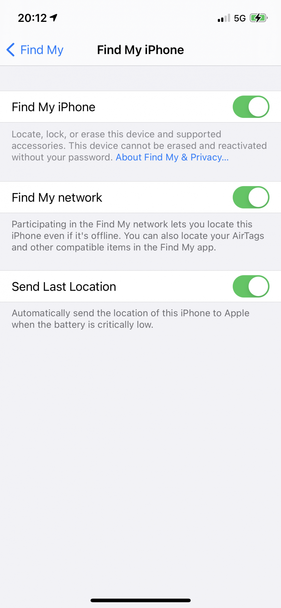

Second, I added the iPad back into HomeKit. I turned off all location settings:
Find my location
Share my location
Privacy>system services>home
Privacy>Home>never
Turned on airplane mode

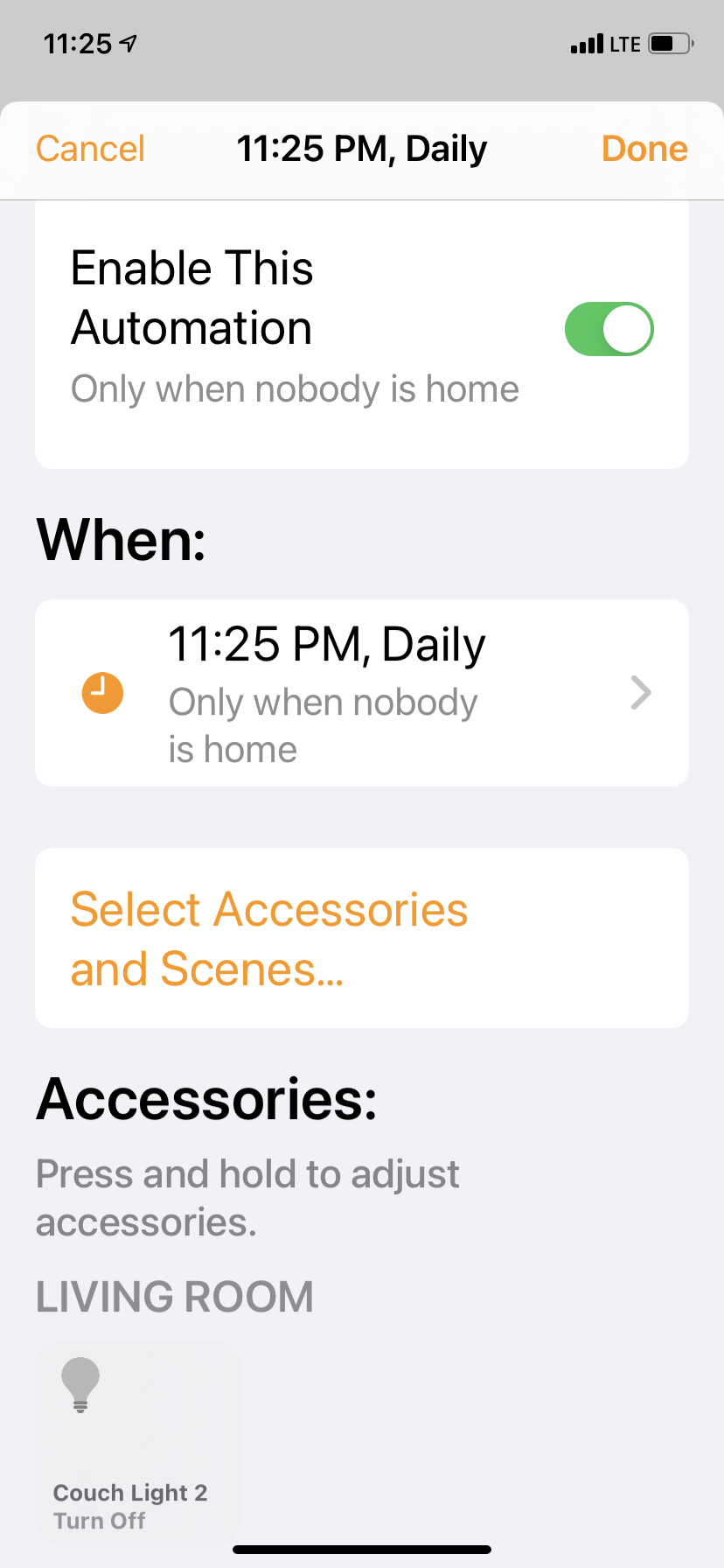

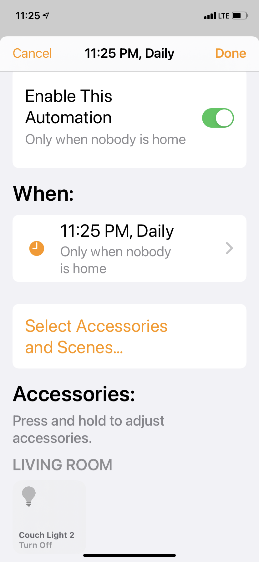

The way I create the automation is first a Time of Day trigger AND a Nobody is Home condition. There is no way to exclude the ipad in that condition. Strangely, the exclusion option exists with "when the somebody leaves" trigger. Apple just dropped the ball on this one. Hopefully it will be fixed in ios15. There has to be a lot of people with stay at home ipads on the wall.

I don't think the two triggering options are interchangeable in the OP's situation. Here's what the OP wants:
We leave the home earlier in the day, and come back at some point in the evening. The lights turn on automatically at sunset. If it's 10PM and nobody's home, the lights should be turned off. If even one of us is at home already, nothing needs to be done.
If you start with the "A Time of Day Occurs" option, the logic's going to run like this:
Is the time 10PM? Looks like it is, so is anyone home right now? Looks like no. Okay, let's turn off the lights.
If you start with the "People Leave" option, the logic's going to run like this:
The last person just left! Is it between 10PM and 11PM? No, it's 10:45AM. Okay, let's do nothing.
...and then the lights come on at sunset, and stay on past 10PM even though no one's home.

Yes. This is correct👍
I also did a final test by turning “use as a hub” for the iPad (still on its own Apple ID). The automation failed. The iPad is still considered at home (which it is 🤣)
I have attached the picture of the automation.
