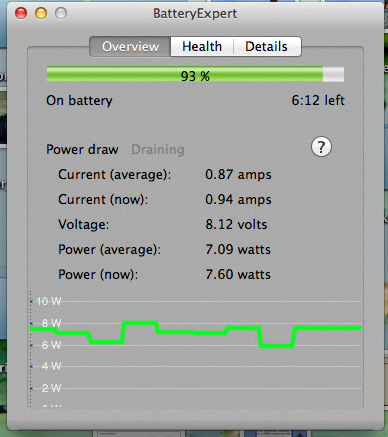

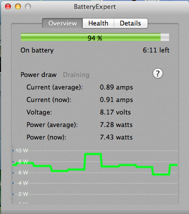

I tried to get a more concrete answer to this using the power draw measurement. Using BatteryExpert from that App store (I'm the developer), I measured power draw for about 5 minutes without an SD and 5 minutes with an SD while on battery. The card is a Sandisk 8GB SDHC Class 4.
There were some small fluctuations in power consumption while I was measuring- maybe spotlight decided to index something, or something else was going on behind the scenes, but I don't think it was significant enough to affect the measurement. Power draw looked basically the same with and without the card- it's good enough for me.
No SD card:
With SD card:
