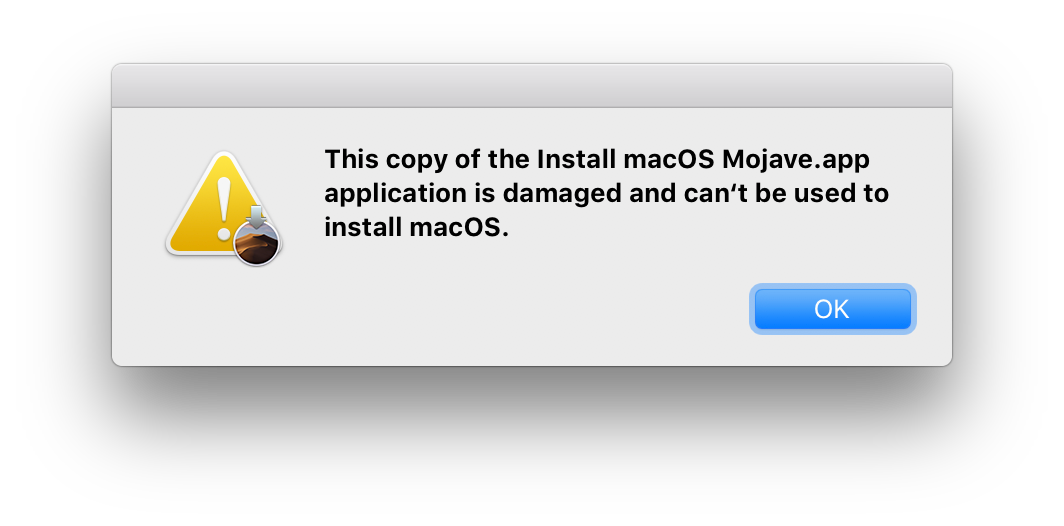

The answer to this:
How to Fix a Damaged macOS Installer (Mojave)
for me, turned out to be this:
Step 1. Go to your Applications folder.
Step 2. Find the Installer for macOS Mojave in Applications folder
Step 3. Right click on the installer and click “Show Package Contents”.
Step 4. Click on folder named “Contents”.
Step 5. Click on the folder named “SharedSupport”.
Step 6. Delete the file named “InstallInfo.plist”.
Step 7. Enter your administer password to confirm.
Step 8. Now open the installer for MacOS Mojave again, it will run
It was simplest thing after fighting with Apple and installers for about 5 hours.

The certificate on older 10.14.6 installers is expired– the certificate expired on installers October 24, 2019.
So are you saying, if you have an older 10.14.6 installer, then the fix is to download the 10.14.6 installer again, which should have a valid certificate?

Downloaded the 10.12 installer direct from the app store.
Deleting "InstallInfo.plist" did NOT work for me...the installer "phones home" and gave an invalid certificate error when I did so.
What worked was disabling "set time and date automatically" and then manually setting the year back to 2018 before starting the installation on my iMac 2014.
EDIT: setting the date to sometime in 2018 also works to install 10.13.
