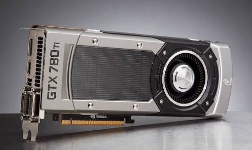

Does anyone know a stable safe method to flash a GTX 780Ti?
I have a GT120 as my boot screen GPU and the 780 as the card for AE etc.

Yes it's better in my opinion but has a higher power demand. On Premiere it runs brilliantly and can manage 4K playback relatively comfortably.
I haven't had any issue with the power drain from this card even under heavy loads when rendering. Seems stable enough with the normal PSU
There is no public Mac rom for Reference GTX 780?
Nope. Given the work that MVC puts into flashing these cards I don't blame him for keeping it private to make some cashola. It's not just a case of flashing the ROM, sometimes additional soldering work is required.
Stock flash chip doesn't have enough free space for additional EFI bios. MVC replace it with different.
Also after that you can't read/write bios of this card with standard software.
