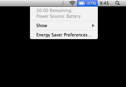

I was very obsessive about prolonging my battery life so I
  • turn off bluetooth
  • removed the optical drive
  • replaced the HDD with a low power SSD
  • always quit apps I'm not using
  • disabled Dashboard
  • reduce brightness
  • installed ClickToFlash
Disabling background processes, quitting apps, and blocking Flash along with everything else can give me battery statistics of up to 14 hours. I rarely take my charger with me anywhere now.

But you have to make your desktop background black to cut the power even more.
Well that all well and good.... unless of cause you actually want to use your laptop...=/
Plus correct me if I'm wrong but how would a black background save power? The led backlight is still on the pixels are just blocking it...
That was just a joke. I have a black background because I use my MBP during concerts and I don't want the screen brightness to be a distraction.
Obviously, I don't get 20 hours. I do get over 10 consistently, everyday, with web browsing. The OP wanted to know what he/she could do to optimize the battery performance. I wondered the same thing and was detailed about the changes I made to my computer. Quitting background apps when they are not in use is simple. Getting an SSD and removing the optical drive can also make improvements. ClickToFlash is absolutely fantastic. My MBPs run cold and quiet daily. Yes, watching 720p movies is taxing. Streaming Flash videos is taxing. When I do have things to do, like running Photoshop or Logic Pro, I have a little more juice than most people.
I do one very battery intensive thing which is why I made all these tweaks. I record concerts with a very sophisticated bus powered FireWire microphone preamp. It is absolutely crucial that I can run this peripheral, an RME Fireface 400, off the internal MacBook battery. Running my preamp and recording in Logic Pro at 192 kHz, I can go for around 3 hours. This is all with an 18 month old C2D MBP.
