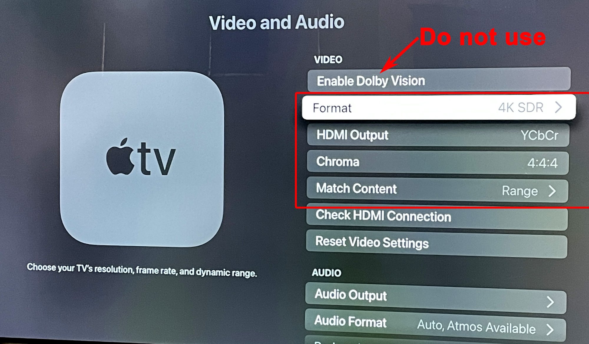

I had to use the settings in the photo to get HDR & DolbyVision to work properly. When set, Stats of Nerds work properly even though my LG doesn't indicate the video is HDR.
The first line "Enable DolbyVision" simulates everything into DolbyVision. I like real DolbyVision & HDR.
thanks for posting this. I had it set to 4K HDR and didn’t understand the ramifications.
