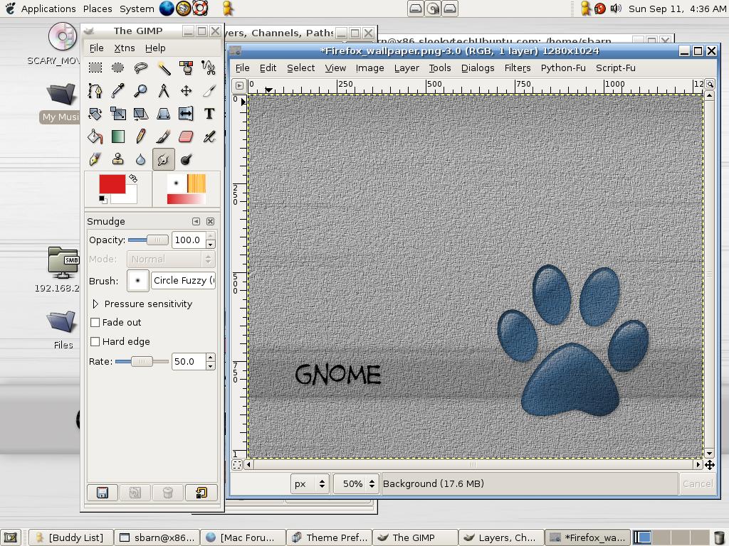

I forgot the screenshot of what Ubuntu looks like afterwards. NOTE: You can change your themes in System->Preferences->Themes I have mine set to look like Royale from Windoze XP.
Cusomized of mine is as follows:
Controls = Clearlooks-DeepSky
Window Border = Chiro
Icons = Smokey Blue
Here's a screenshot too:
homerjward said:
wow, that makes windows 98 look beautiful...
Really? I don't think it looks too bad. Besides, that's not the default theme and it can be changed easily anyway.
