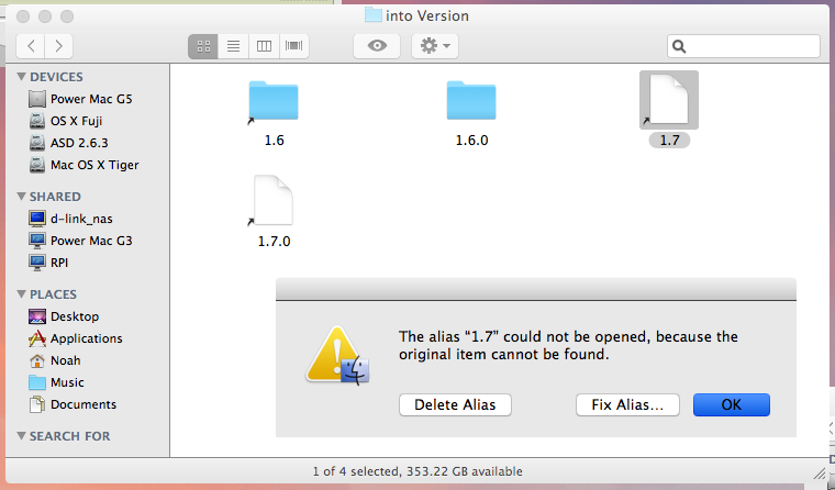

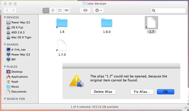

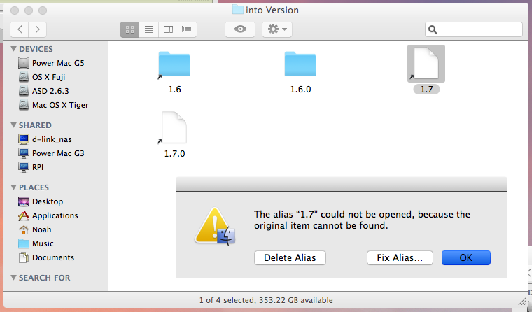

Alright so, there's nothing wrong with the 1.6 you included. All good. But there are two aliases to 1.7 in the 'into Versions' folder, neither leading anywhere, so the only 1.7 present at all is in the 'into JavaVirtualMachines' folder as a .jdk.
Simple oversight? Maybe upload another version with a fixed 1.7?
The 1.7 should be pointing to 1.7.0 and 1.7.0 should be pointing to Java home folder in the 1.7.0 JDK
