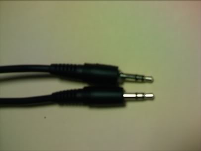

    The image below is how i solved that problem. in the pic there are 2 head jacks.
    1. the one on the bottom is the normal one that won't fit on the iPhone because of the wide black base.
    2. the one in the pic on top is the modified one. I scraped the black base off with an exacto knife so that the base is narrow enough to sit inside the iPhone jack.
    it was either that or wait a month for belkin to deliver a 10 dollar adapter for the iphone. :D
    [​IMG]
    edit: for those who were not familiar with the problem: the iPhone does work with standard 3.5mm headsets. the problem was that the iPhone case (the circular part surrounding the headphone jack) is so narrow that most headphone jacks wont sit all the way down properly

    Boss1 is correct, and the Bose earbuds do not fit the iphone. I have the same problem. Bummer. Waiting for an adapter, or I might "carve up" my plug.

    dude don't carve up your bose headphones! lol . use an adapter to extend to the headphones. Thats what you see in the pic carved up. A 4 dollar extender i picked up at radioshack
