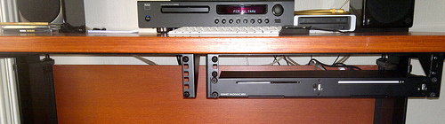

Some time ago I have bought a RacMac mini from Sonnet tech as seen here:
So the 2nd. room in that could be used for some cooling equipment if needed. Also, it's steel plate surface would be fine to add things in for the mini, I don't want to screw directly in the mini...
More pictures of inside the rack here, and here. The mini fan can be seen here and without the fan here

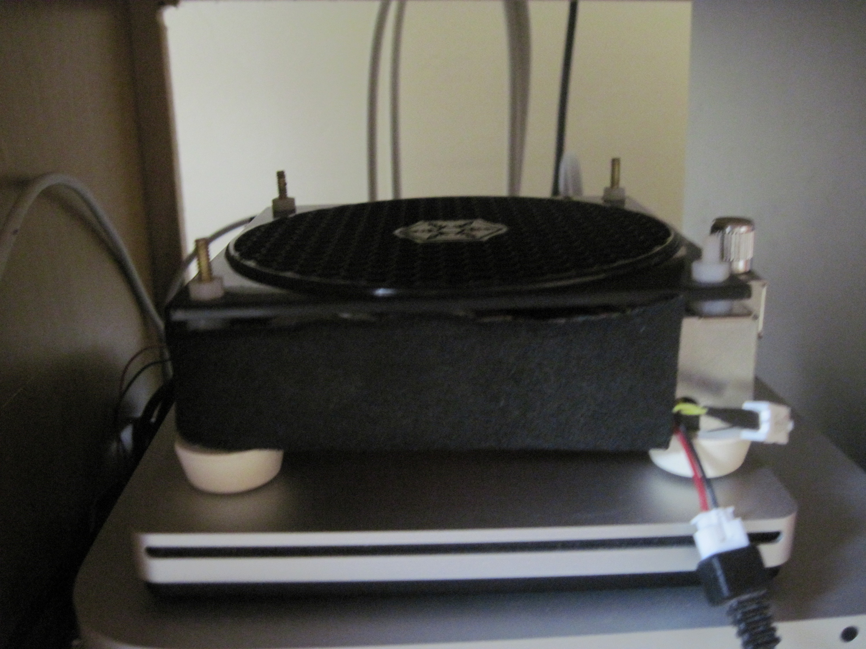

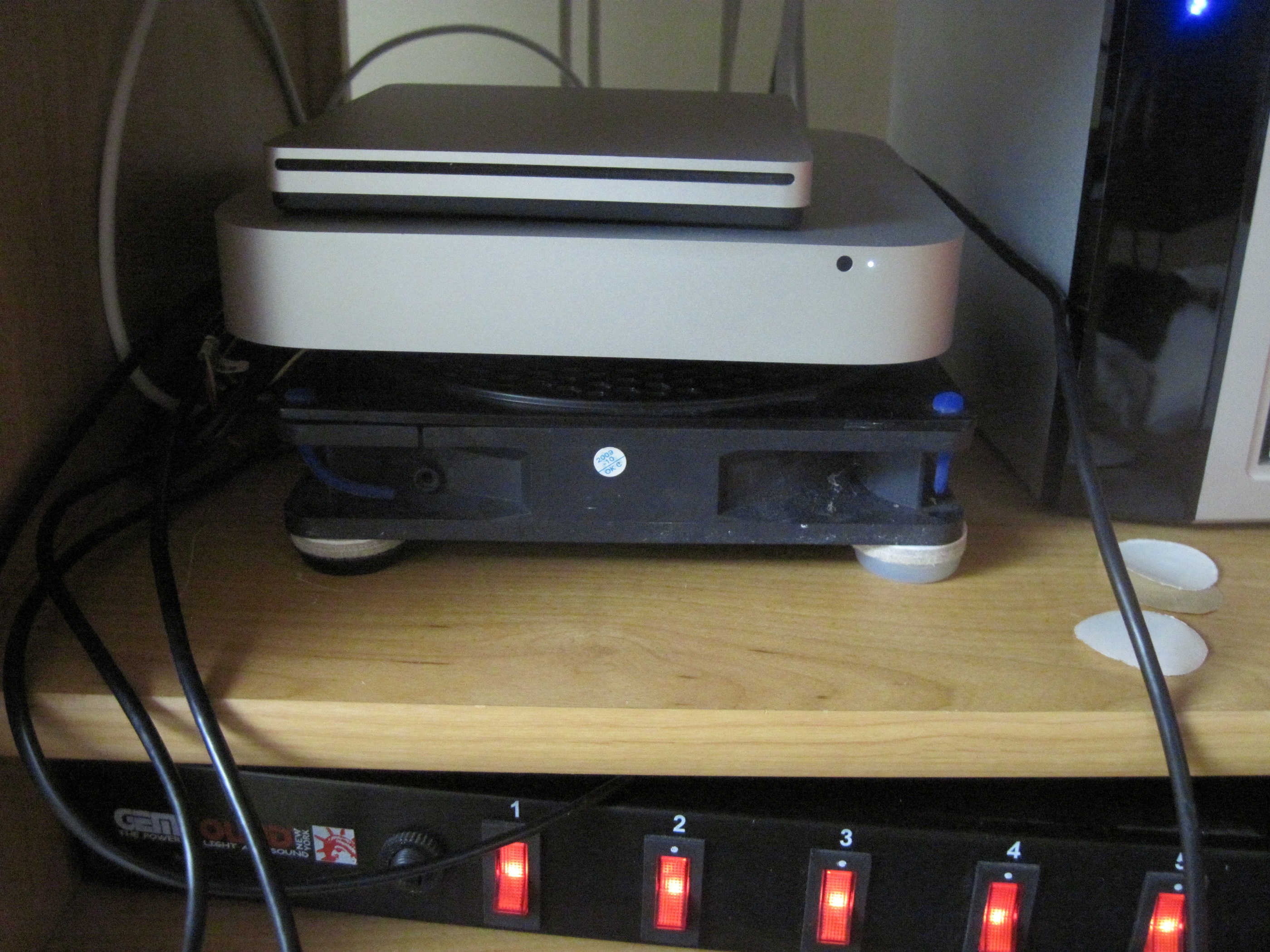

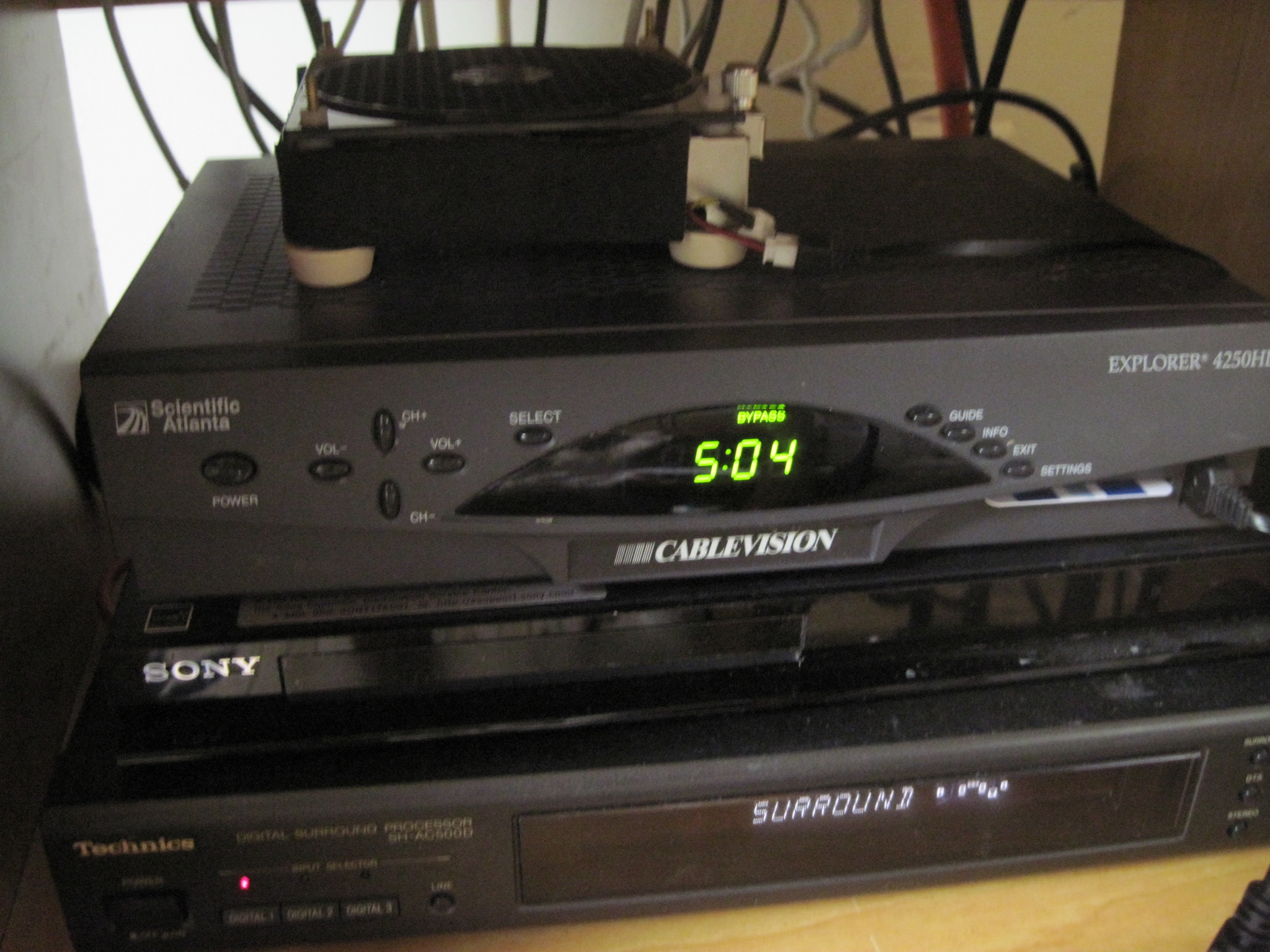

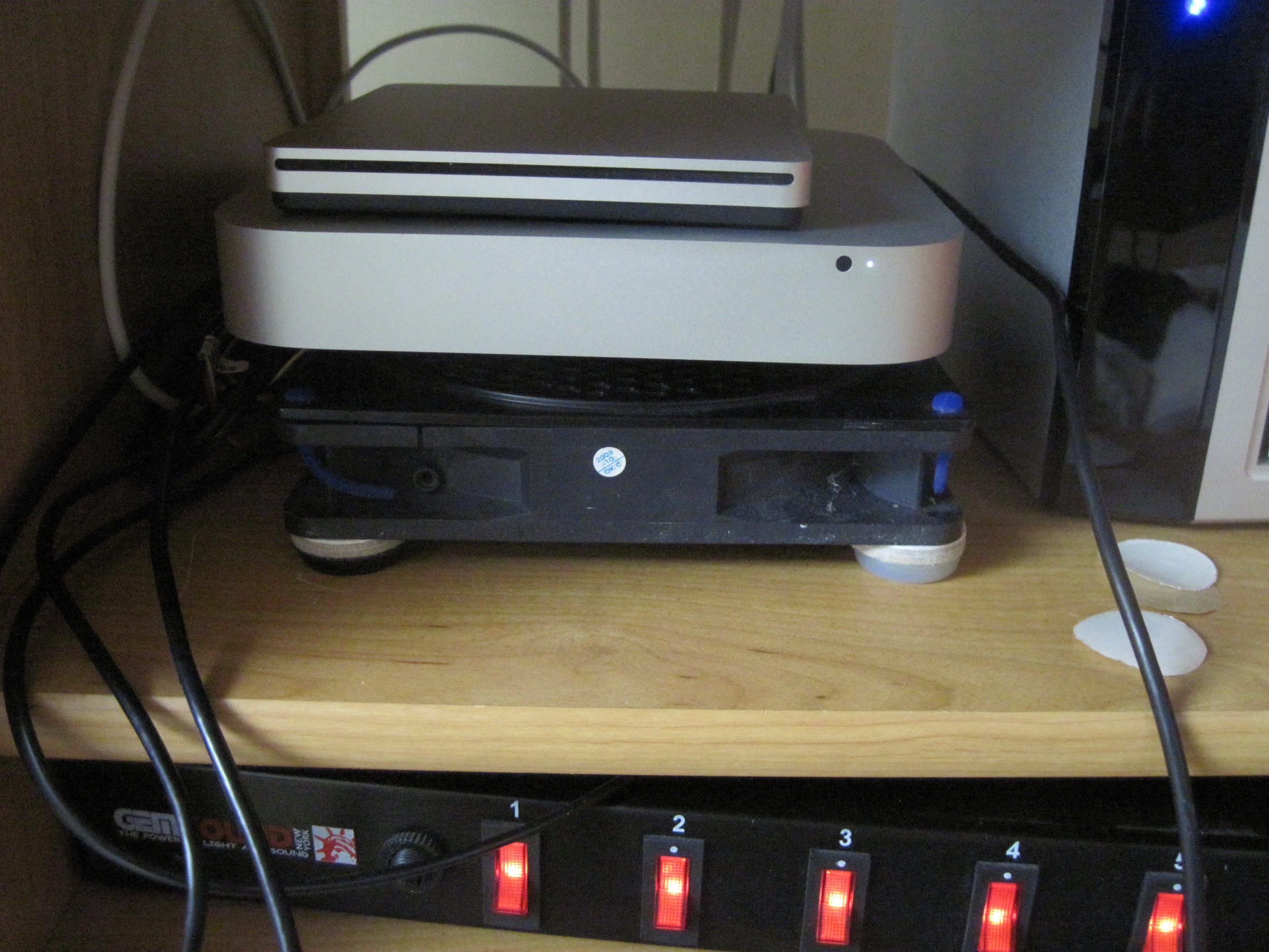

here is your fix
part 1:
http://www.amazon.com/Thermaltake-Mobile-External-Cooling-AF0007/dp/B002OJN250
part 2:
http://www.amazon.com/SilverStone-1...8&qid=1342472267&sr=1-1&keywords=120mm+filter
part 3
http://www.amazon.com/Peavey-000516...1342472512&sr=8-1&keywords=peavey+rubber+feet

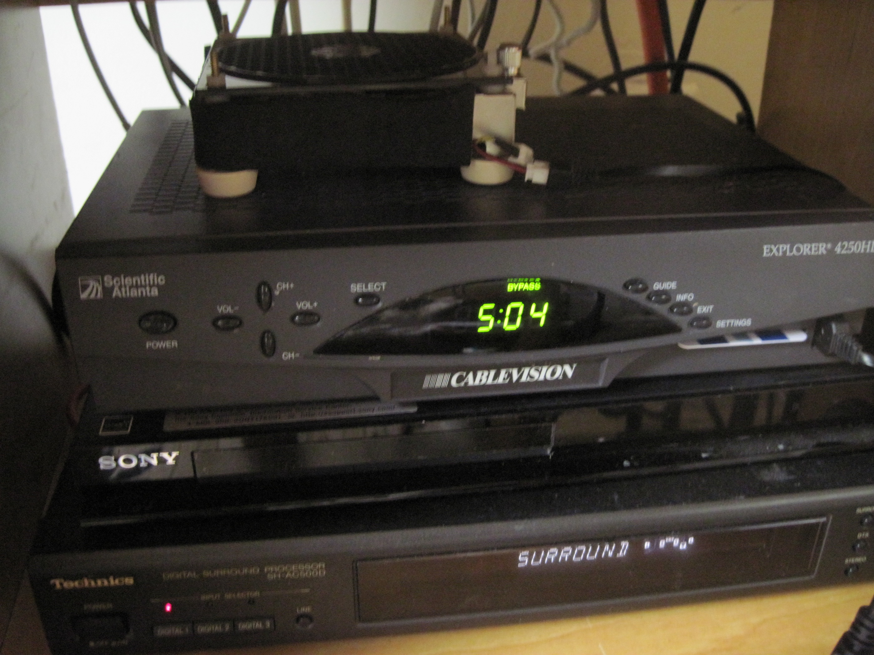

I made the thermaltake I list above to cool my cable box.

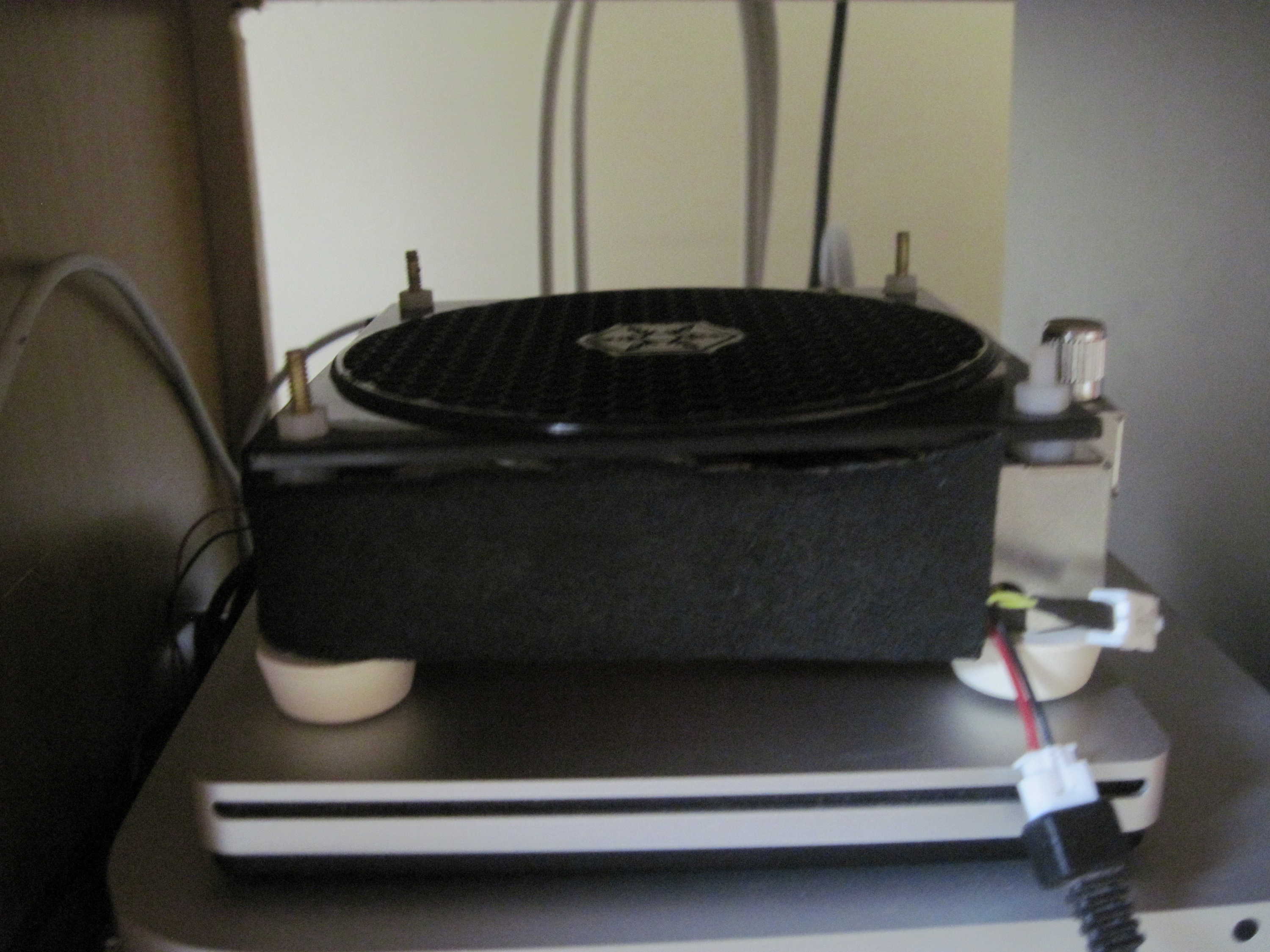

I made a 8 inch fan to cool my mini. the thermaltake version will work for your mini.
I used over size bolts to put it together since I use it to pull the air out of my cable box. look at the thumbnail shots, the first shows the mini stacked on a big silverstone fan with feet and a filter I think it is a 180 mm fan.
the second show the thermaltake 120mm it would work under a mini if I had used shorter bolts . the thermatake will run quiet or loud it has a speed control

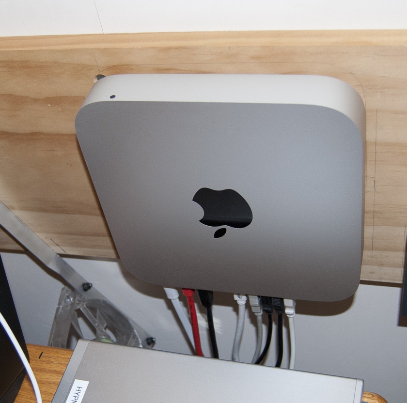

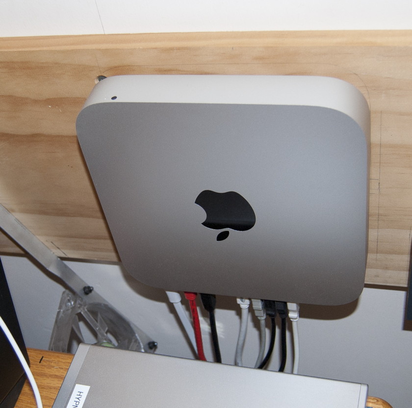

I have mine mounted on the wall (using an H-squared mount), at the rear of my desk. Below the level of the desk, I mounted a 120mm case fan to blow across the Mini, esp. the heat vent area where the cables exit. It barely get warm. The case fan takes away the vented heat, and helps cool the unit in general.
