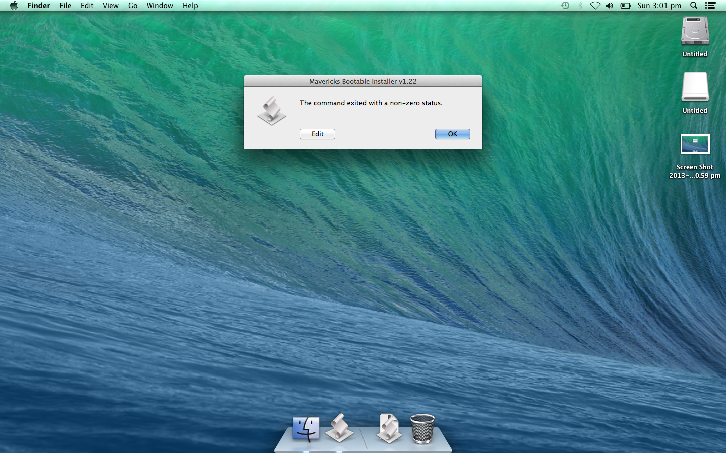

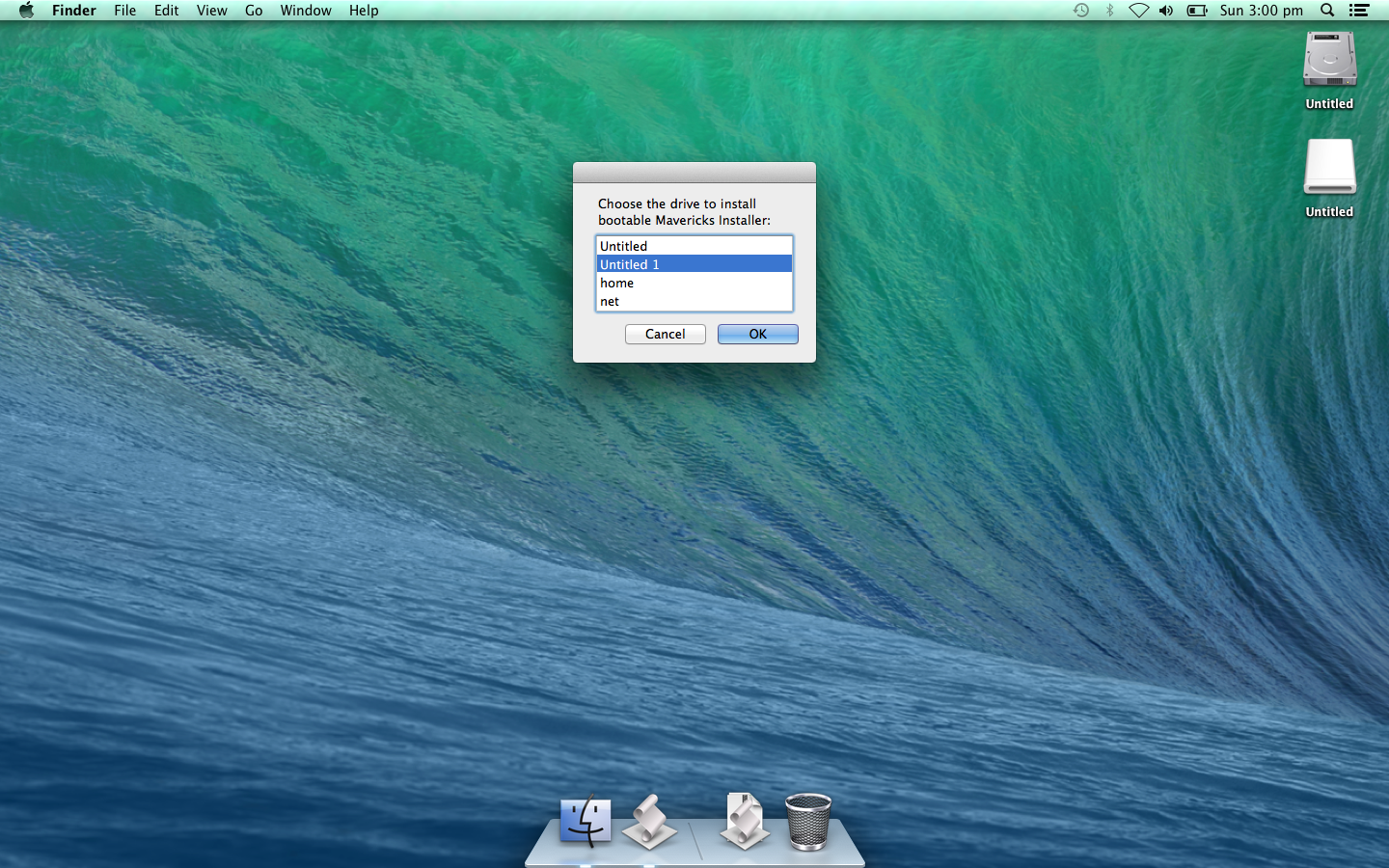

I got this.
Only after using Disk Utility does my drive appear in the script. It doesn't not appear if its blank (no partition). The screenshot on your site shows flash drive appear, but then you state in step 3:- ".....This is absolutely necessary in order to create the proper partitioning scheme that OS X can boot from"
No its not, since the dive doesn't appear until after its partitioned.
How can you point to something that doesn't exist yet ?
However, after using Disk Utility partitioned as GUID (Journaled), it shoes up as screenshots below, but then i get an error as indicated.
I'm not after any solution here, as i have my solution which works for me...... Just thought i'd share for anyone having the same.
I'm guessing it's failing since both of your drives are named "Untitled". When this happens, both drives will appear to have the same name in the Finder but one will have been assigned a different name as seen in /Volumes and as the Applescript indicates. A Non-zero error in an Applescript just means that the script didn't exit as expected, but the cause could be any number of things.
Edit: The process is indeed failing because both of your drives are named Untitled.
