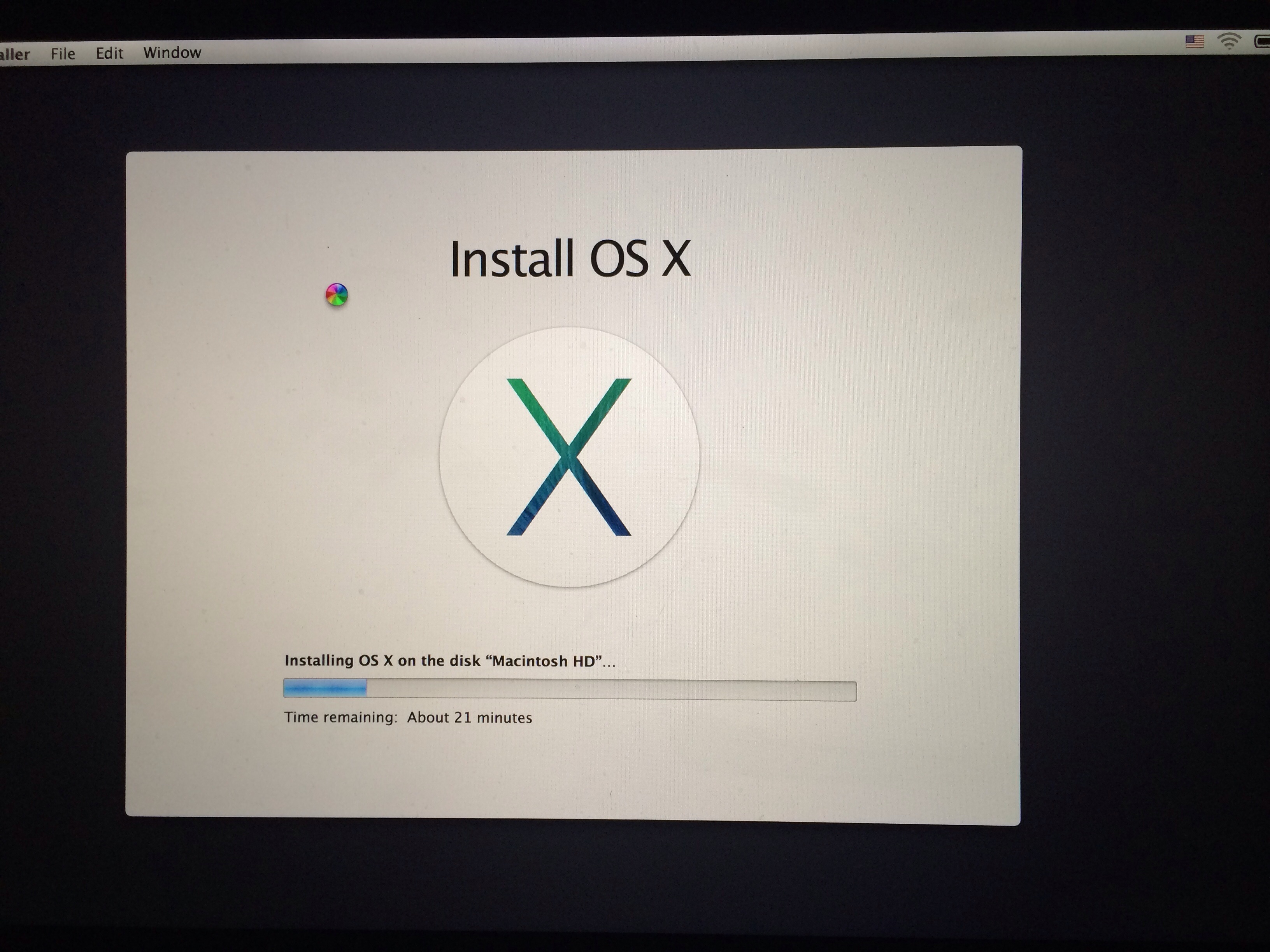

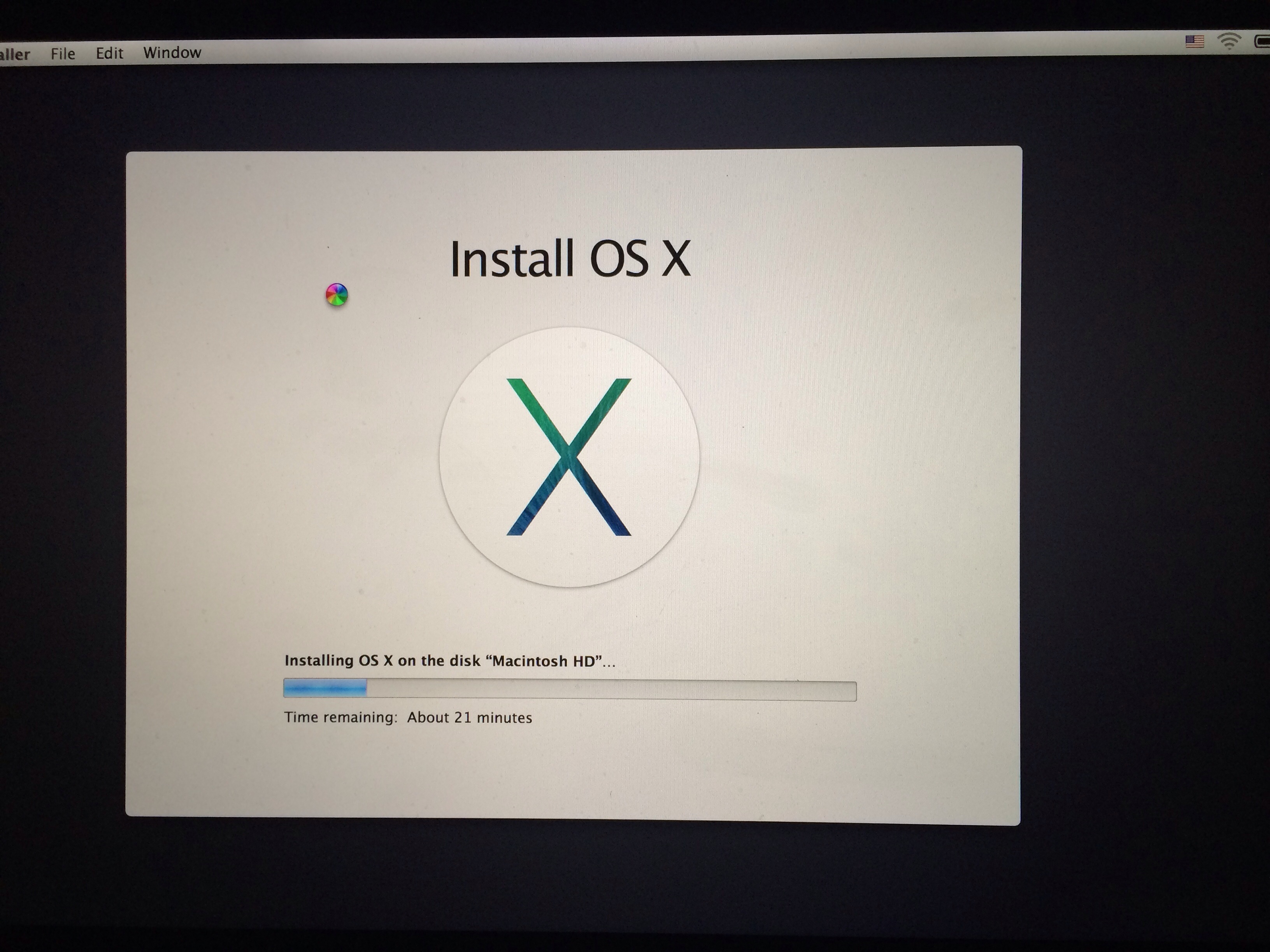

Hey, I'm currently (finally!!!) installing Mavericks, clean, on my 10.6.8 MacBook Pro.
I used this site*:
http://www.gottabemobile.com/2013/10/22/perform-clean-install-os-x-mavericks/
*Scroll down to view their alternate method for creating a bootable usb (initially their first).
It starts with: Our initial method (if the above method doesn’t work):
This finally worked for me!
At this moment Mavericks is installing!🙂
Hope it will work in a few minutes!
Good luck to other 10.6.8 owners!
If it somehow ends up failing later, I will edit my post. No edit means it's working!
Cheers!

Odd issue
The following is when installing to SSD using both sudo command and DiskMaker X :- (Attached)
Beach-ball occurs all the time during second half of install, and stops. Can always re-produce.
However a power cycles fixes this, install resumes, and completes installation.
UPDATE : would you believe, the above was caused by a flaky USB thumb drive ?
Of all the times i've done this, this had to NOT happen on call with Apple.. 😛
