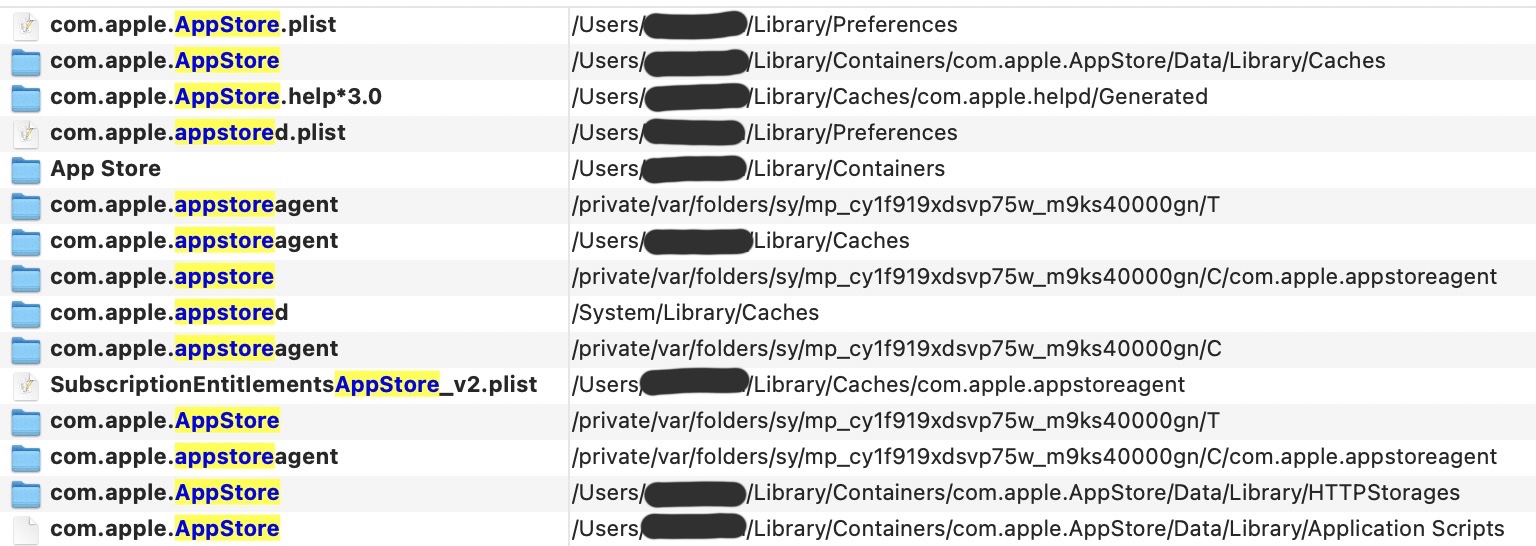

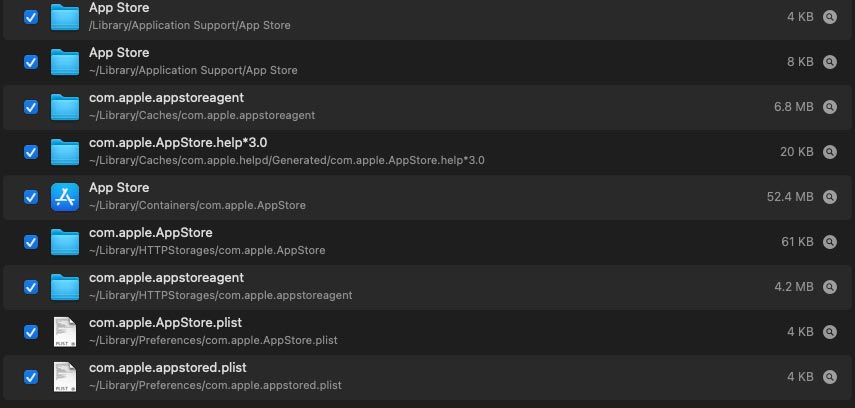

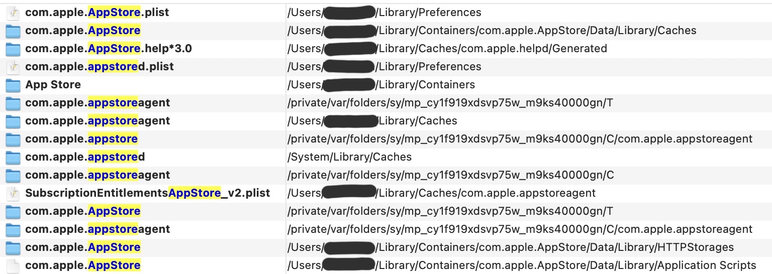

1) I did a search of all AppStore using Easyfind app
2) I took a screenshot-useful for some of the folders in case you need to put one back
3) I removed all the folders from the Pref and Libraries
3b) I created a generic folder on the desktop and
added few folders nested inside like
"Users", then inside "Library", inside "Caches "
The folder "Library" will contain "Containers" ," Preferences" as well and so on...
to help myself to know where they were coming from in case I needed to reverse it
4) After moving all, I restarted the computer and launched AppStore that prompted the window notification immediately
Maybe just try all the Users/YOU/... and see if it works already
If it doesn't work, you will need to delete all those again plus the System and private ones

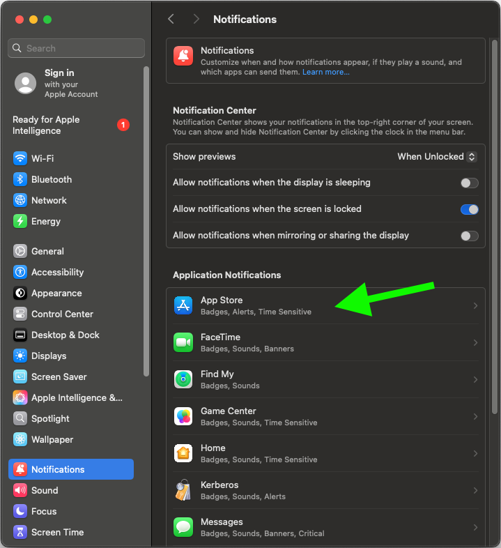

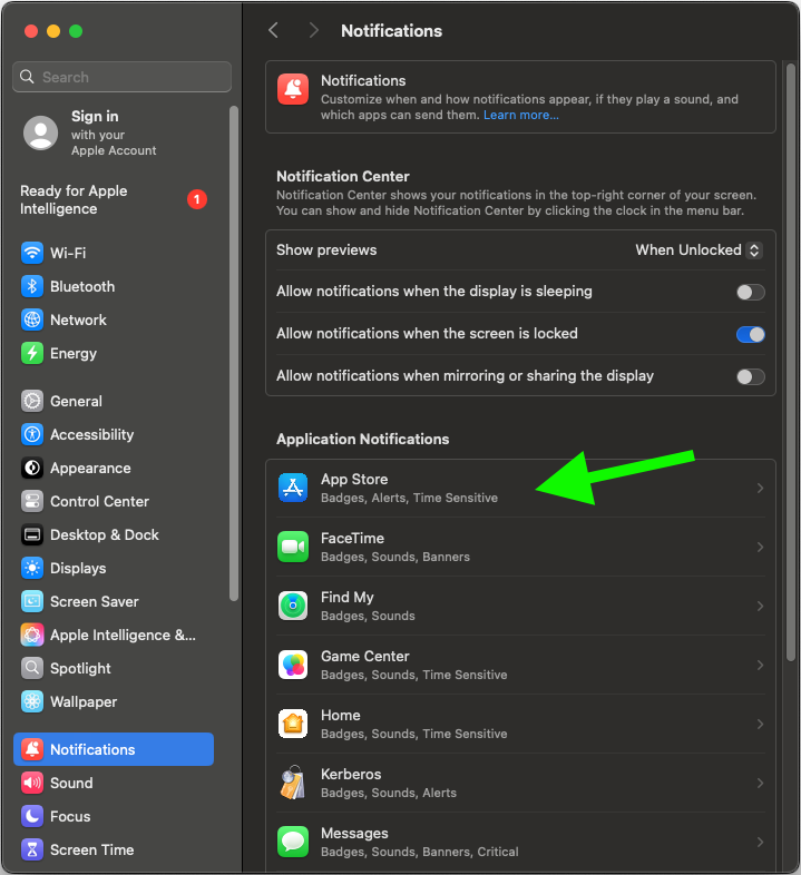

Question: Currently, the App Store is NOT present in Settings -> Notifications (Sonoma 14.0) .. After your App Store notifications began to work, did the App Store magically appear in the Notifications settings?
Absolutely agree with the part of always allowing notifications at first then disabling them if not needed.Just a follow-up post in case anyone is still having this issue.
After having this App Store notifications problem in Sonoma (with a new Mac Studio), I did a standard upgrade to Sequoia 15.3 (non-clean install) hoping that would fix it. Nope - still no App Store in Notification Center. 🙁

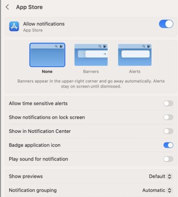

So, before I did a full reformat, I tried creating a new user account (Settings - Users & Groups - Add New User..) with admin privileges - and finally - when I launched the App Store, it requested notification permission and added the App Store to Notifications 🙂. This was much less painful than a reformat clean install (or a "Erase All Content & Settings" install) because it leaves all applications intact.
I think I've had this issue off and on since Big Sur (including Monterey and Ventura), but that was using Open Core Legacy patcher to run current OS's on a 2012 Mac Mini, so perhaps that was the reason? Any way, not that big of a deal, but this is the first time I've had App Store notifications since 2021.
And lesson learned: now I *always* select "Allow" notifications when the request first pops up. They can be turned off later in settings.
