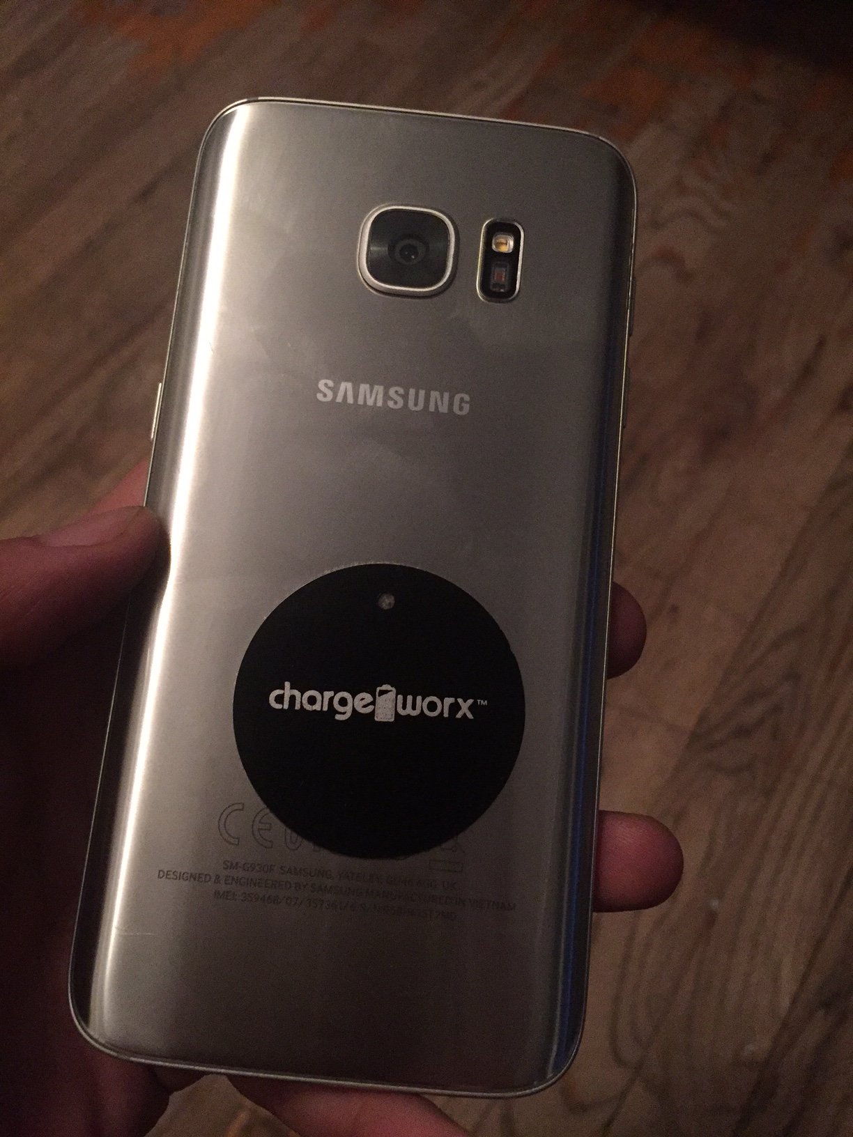

Having the same issue with my Galaxy S7 Can't figure out now way to take it off

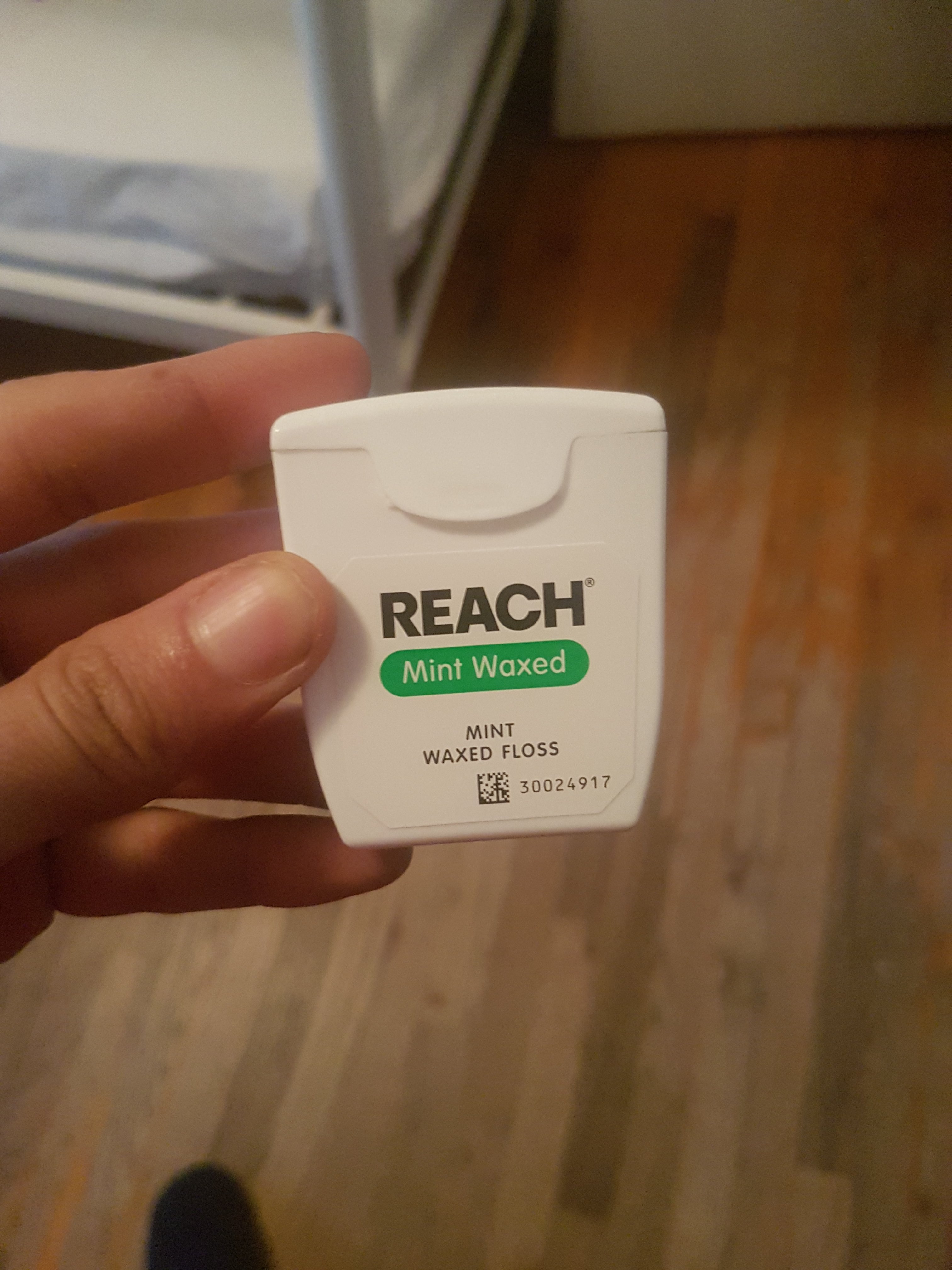

Dental floss or fishing line. Slide under edge and gently pull along. Any remaining glue use solvent to remove.
Please tell me you are joking. Use any kind that allows you to pull it flat under without breaking. Flavor or brand don't matter. Refer to my avi picture or better yet double face palm.
No I'm not joking or anything being funny this is my first time that I'm doing this is never had this problem before and I don't know which one to use since the one I got is a cheap Brand
Did you try it? How expensive it is doesn't matter.
Floss works good. Add a hair dryer in the mix if floss alone doesn't work. If it still doesn't work, use a heat gun & fishing line.
