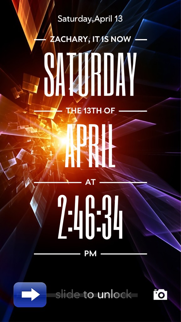

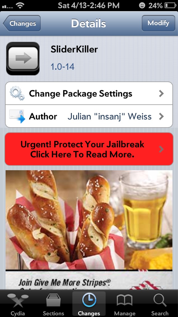

I just installed sliderkiller and now i have slide to unlock text back which should not be. i tried putting just spaces in the custom label in springtomize but that did not work but that did not work! Any fix?
ImageUploadedByTapatalk 21365879141.830357.jpgImageUploadedByTapatalk 21365879160.841044.jpg
It definitely sliderkiller. Uninstalled it and now theirs no text like it should be. Us their anyway to hid the slide to unlock text from being showed and having sliderkiller installed at the same time?

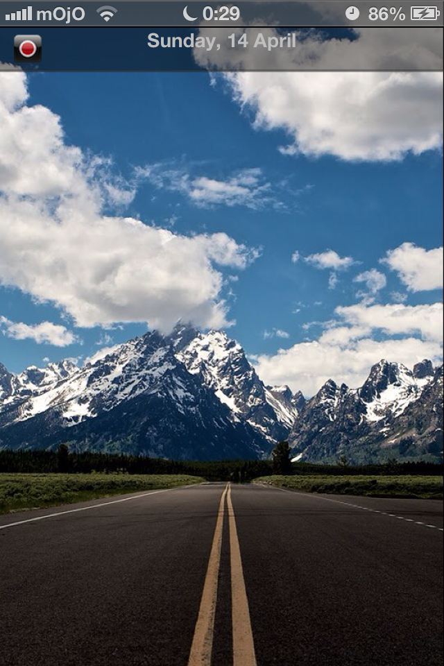

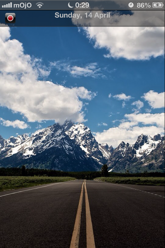

I use lockinfo to hide the clock and the slider... Lockscreen clock hide for the status bar time and the date below the status bar... And springtomize to hide the labels and the camera button...

Thanks for a response Zman. Is there a way to remove just the line without removing my slider? I want to keep the slider as is.
Most likely not or not that i know of. Sorry🙁

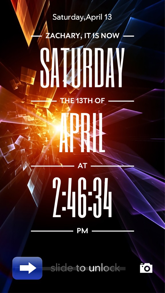

Okay, this is what I do:
Using either iFile (cydia)/ Cyberduck (Openssh)/ or iFunbox, Navigate to System>Library>Core Services>Springboard.app>English.lproj (Or whatever language pack you use).
The file you're looking for is Springboard.strings
When you open with a text editor, you'll see a long list of strings, anything that says "slide to unlock" on the right side, for example:
"Away_Lock_Label" = "slide to unlock"
Simply blank out the text so that it looks like so:
"Away_Lock_Label" = " "
Respring and the text should disappear. If you wish to reverse the process, just retype "slide to unlock" where you deleted it before.
This process shouldn't conflict with sliderkiller.

Thank you🙂
