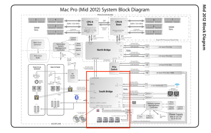

Looking for a schematic of the 4,1/5,1 - is the SATA controller in the PCH/NorthBridge, or is it a separate chip?
The PCH supports hot-swapping SATA.
pch/northbridge

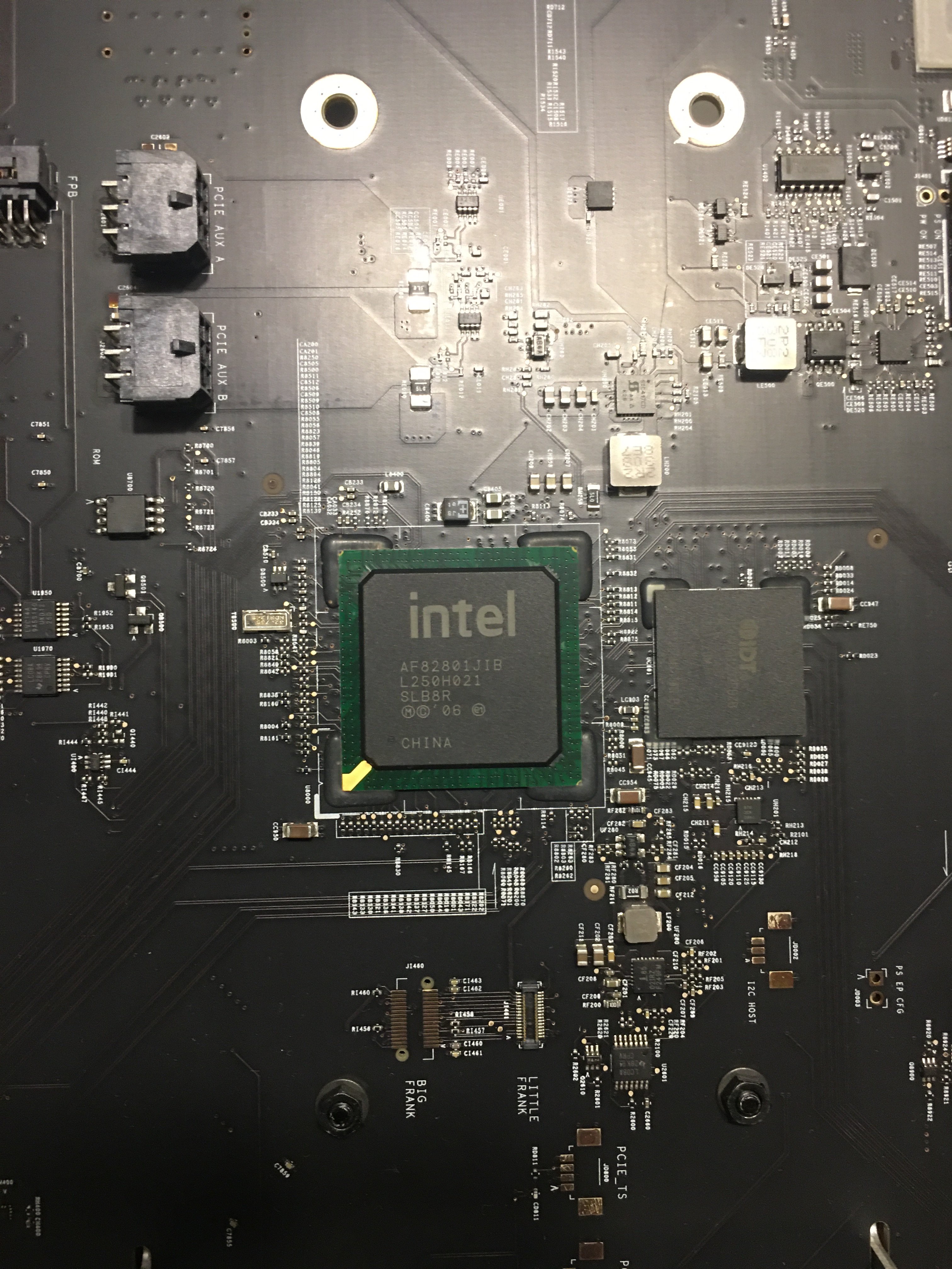

Mac Pro SATA controller are part of the southbridge and don't have a hot-swap support circuit, just a SAS/SATA mux.

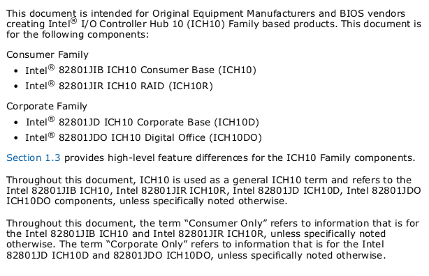

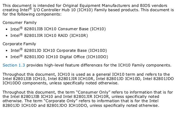

There are 4 distinct versions of ICH10 chipset, two consumer (ICH10 and ICH10R) and two corporate (ICH10D and ICH10DO):

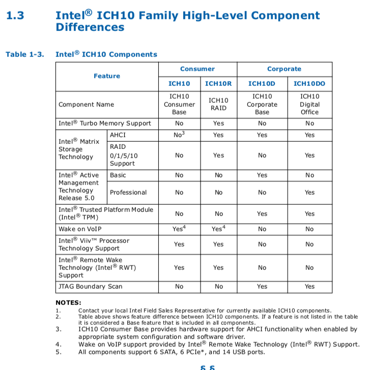

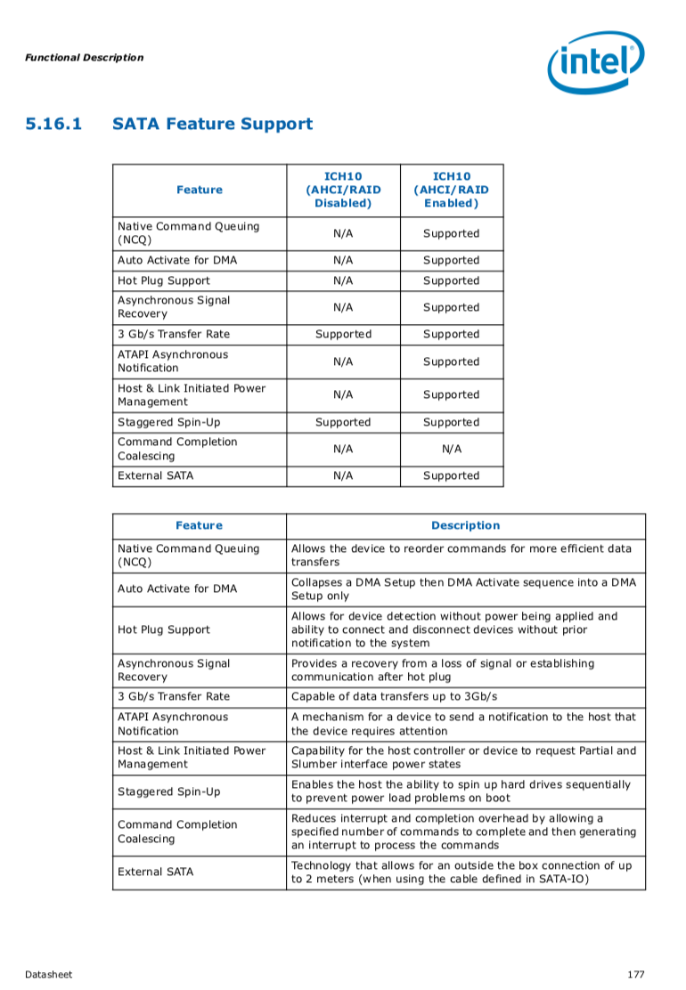

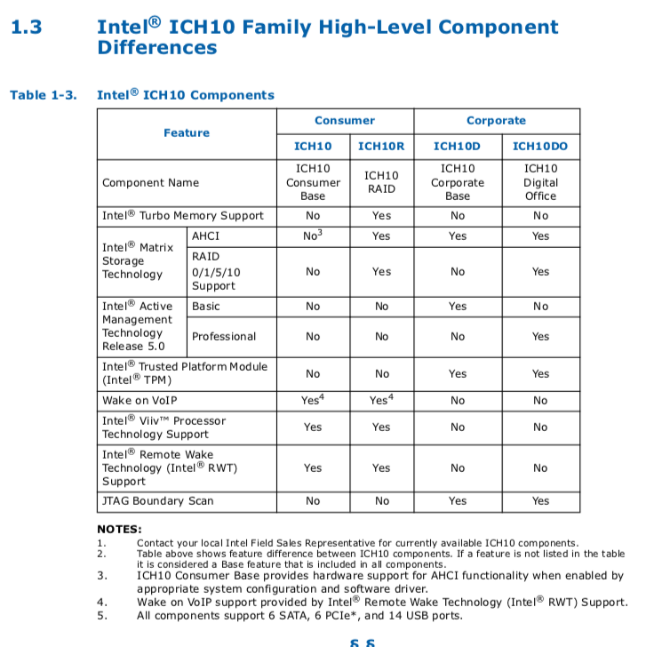

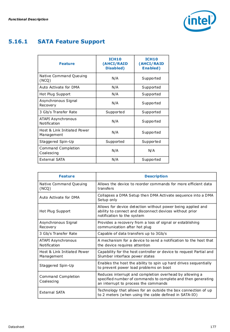

Only the ICH10R and ICH10DO have RAID/hot plug support:

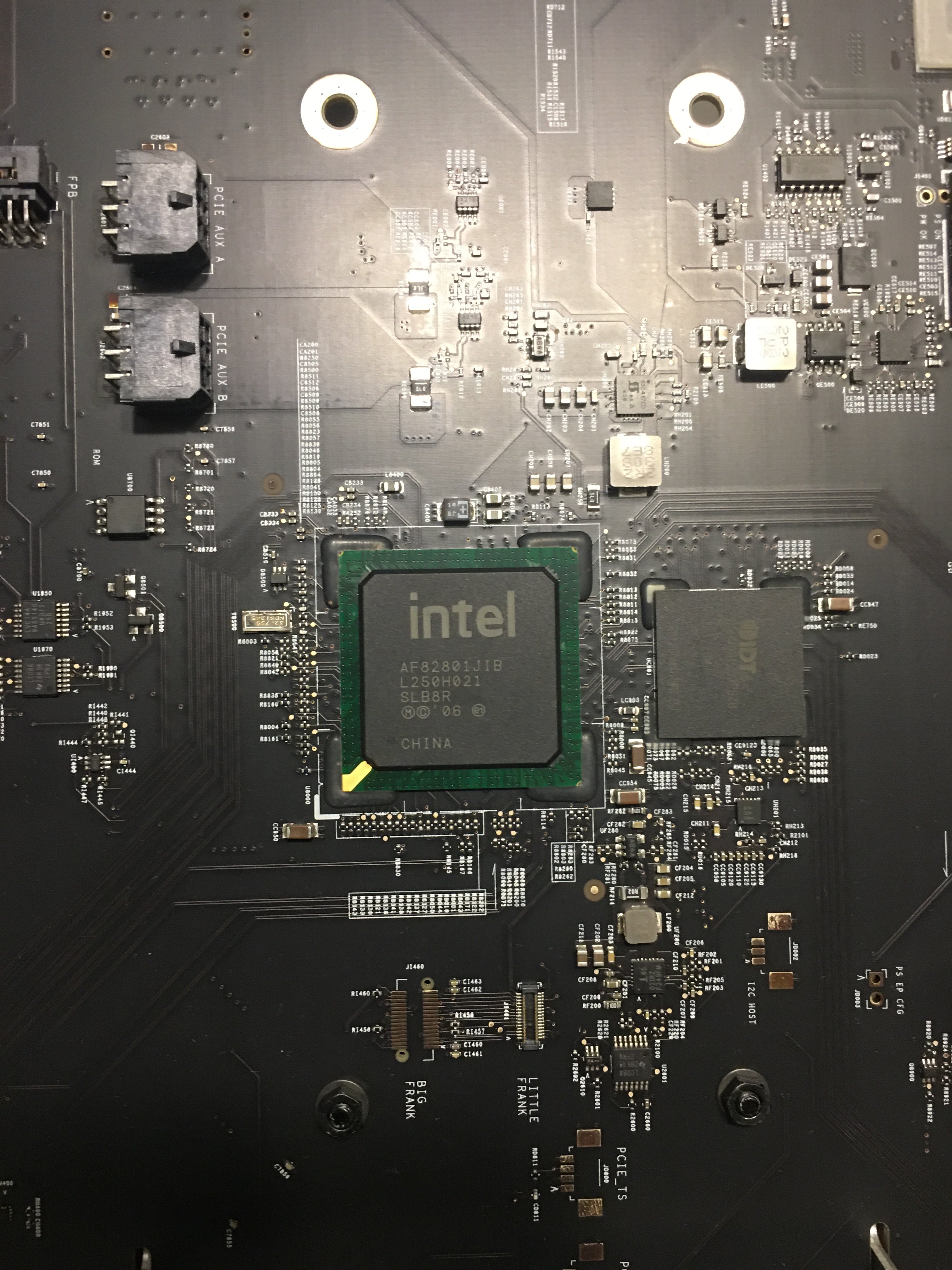

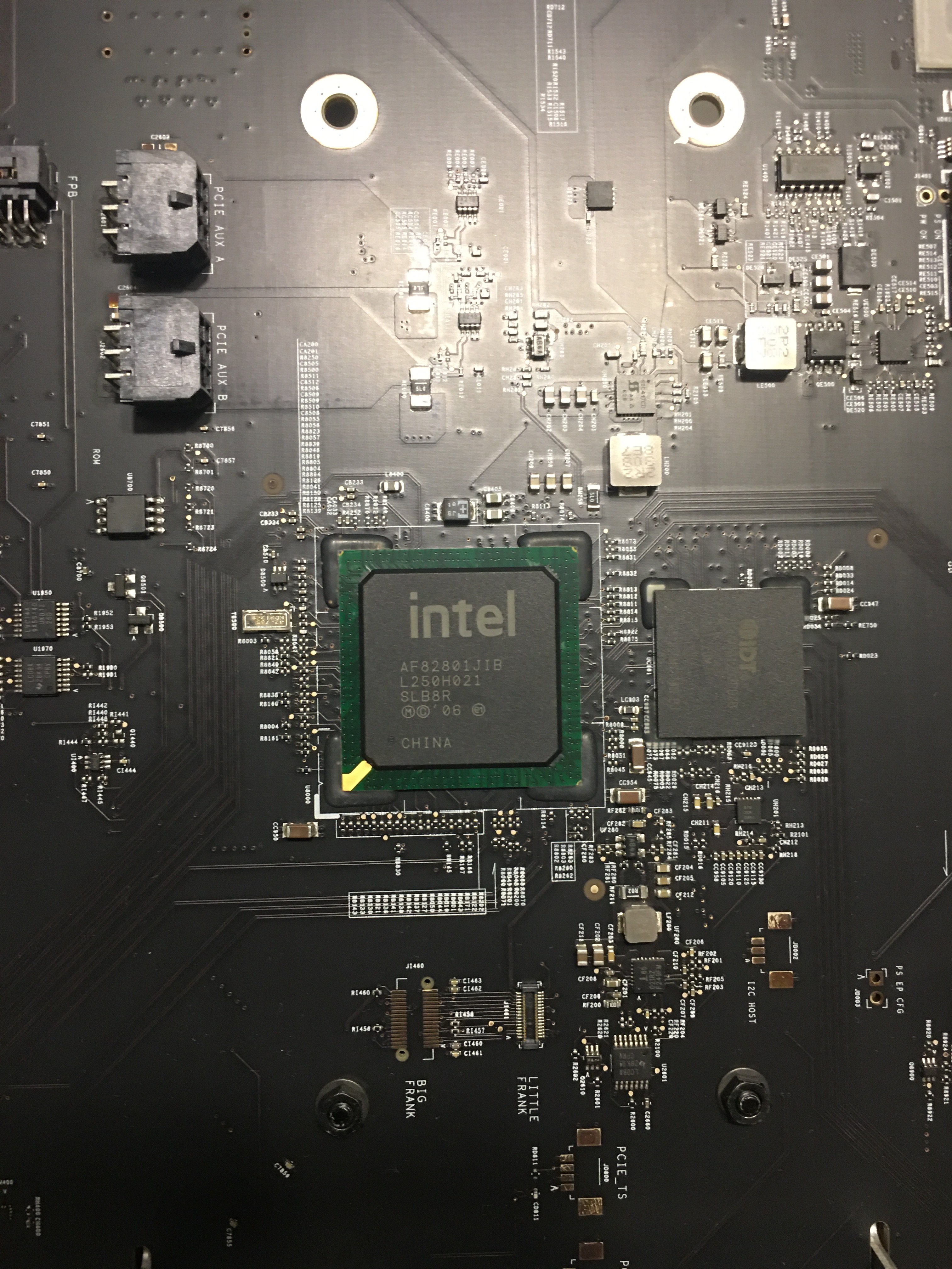

Mac Pro ICH10 version is 82801JIB, no RAID or hot plug support:

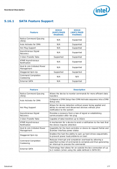

Apple was selling a real hardware SAS RAID card as an option to be used with slot-4, with a SAS mux in the backplane, probably this is the motive why they chose the simplest ICH10 version (to make a cheaper BOM).
Btw, to have hot plug support some discrete components are needed, Mac Pro don't have it, but some of the Xserve boards have them.
