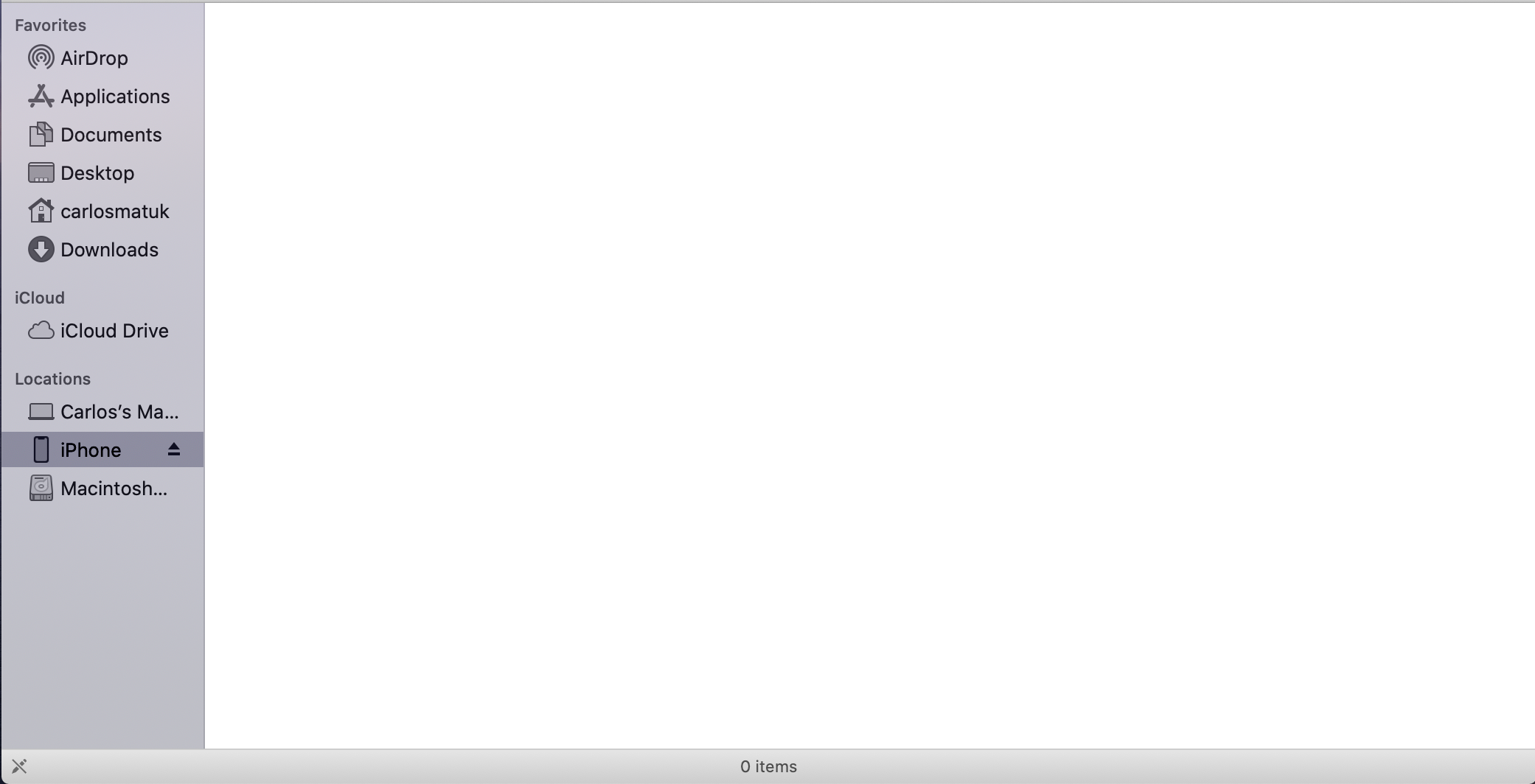

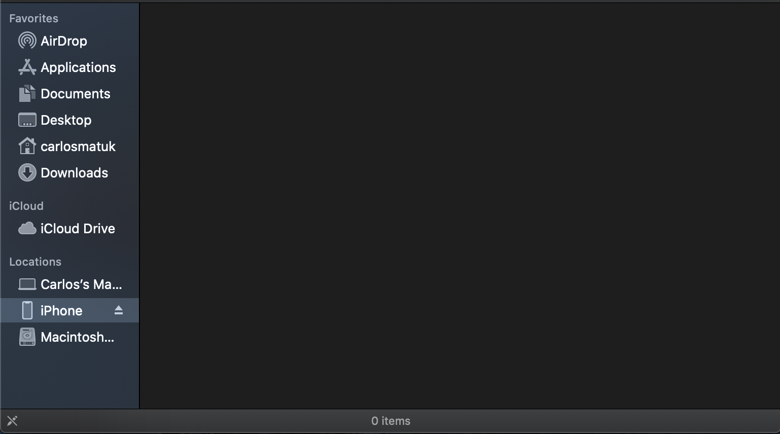

Thanks.... Im doing all that, except being patient.... I will give it once last go.... thanks man!!
Be patient bro!
I can't get pass the blank Finder page; the iPhone does nothing either.... maybe I'm missing something??? I deleted the iOS 12 Beta Profiles, I have Xcode 11; I'm also pretty sure I have the correct IPSW, (iPhone112iPhone116_13.0_17A5492t_Restore) for an iPhone XS (If I could even get an error that would be awesome)
... I'm not sure what else could I try but to wait; again, very frustrating!!

Make sure XCode is shutdown. Try also restarting. And give it ten minutes after you restore to see if the iPhone responds.
I believe it's a bug cos if i switch the Finder to Fullscreen, as soon as the new Finder mini window drops to select the IPSW file, everything freezes... I have tried rebooting, turning WiFi Off on both devices, I don't even get an error it just goes to that blank page and the iPhone does nothing... Its not locked or anything cos if i go to another device from the side bar the iphone just shows up again as if I had just connected it; I've tried different cables, different ports... nothing!!! haha
