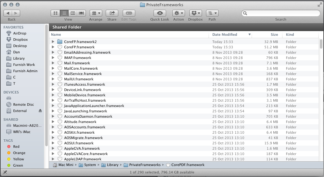

Hi guys thought I'd let you know what worked for me!
As Vanady says:
"have found that problem with MAS is caused by replacing CoreFP.framework during installing itunes 10.7 via pacifist. After pacifist have replaced this framework MAS doen't work.
But if we don't replace CoreFP.framework we get an error -42408 which doesn't allow to sign in iTunes Store, iTunes Match and etc in iTunes 10.7. But MAS will work fine.
So, the problem is in this framework. May be somebody knows how solve this problem?"
The problem lies in the CoreFP.framework.
I therefore (after using Pacifier to reinstall 10.7) used Pacifier again to extract JUST the CoreFP file from iTunes 11 to my desktop.
I then removed the iTunes 10.7 CoreFP file from the 'PrivateFrameworks' folder in 'Library'/'System', copying it to another folder as you need it again shortly.
I then copied the new iTunes 11 file into the Privaetframeworks folder and re-named it by simply adding a '2' to the end of the filename. This turns the file into a folder.
Then drag the 10.7 CoreFP file back into its original location.
In effect you now have 2 core files in that folder, one for iTunes 10 and one for iTunes 11.
I now have a working App Store and an iTunes that doesn't display -42408 error, and that allows me to log into Itunes store as it should.
Each app seems to use the CoreFP file it needs and doesn't worry about the extra one. I'm amazed it works frankly!

I've used pacifist to replace back the itunes11 and I still cannot update/install Xcode. I get the "purchases" message.
I've checked and in CoreFP all files are from the itunes11 pacifist or full installation (from DMG from apple). I'm not sure what else may be broken...

doesn't work for me - "purchase error" in MAS
can u describe the process step by step

Your solution worked perfectly for me. iTunes 10 + Mac App Store run like a charm. Not a single error. From now, I'll avoid iTunes 11 updates to be sure things stays like that.
