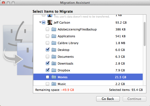

I only wanted to transfer over iTunes and photos and documents. Not all my settings. Is there a way to toggle off what you don't want synced
Once you start MA, you will get a screen similar to this where you have some control over what comes in. But still, what I said earlier about doing this at setup applies.
