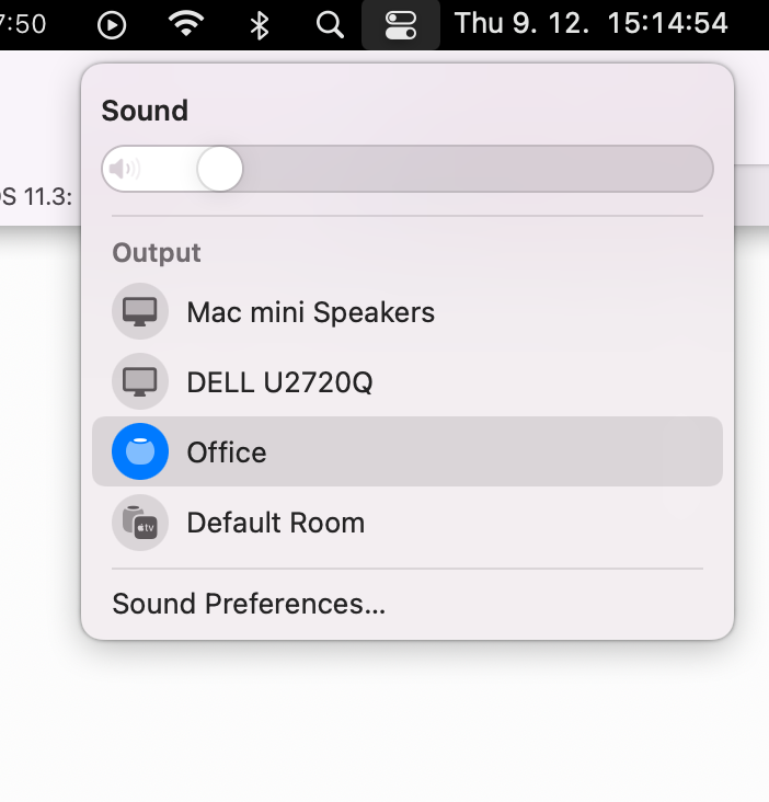

Maybe you don't understand the issue, but are fast to make your own conclusions about other people making false narrative. The issue lies with system wide settings. When you select HomePod as your sound output like this:
Go ahead, try it. And then play anything, you can even play video in QuickTime and sound will lag behind video when skipping ahead or when you pause it sound will continue for another 2 seconds or so.

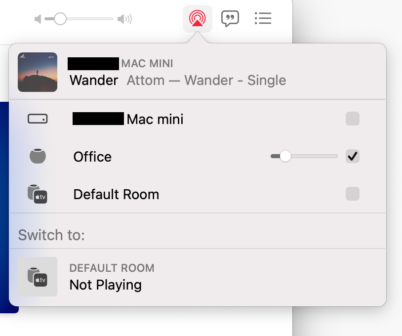

But when you select HomePod directly inside for example Music app, the aforementioned lag is not there.
