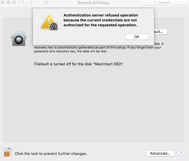

Not off to a good start?
[doublepost=1506877528][/doublepost]I only have one User (me) and I am the admin? Any clue what is going on?

I wonder if that is the issue?
I did find a few googles where the "beta" wouldn't allow the operation or it was turned off. Should have done it while on the final release.

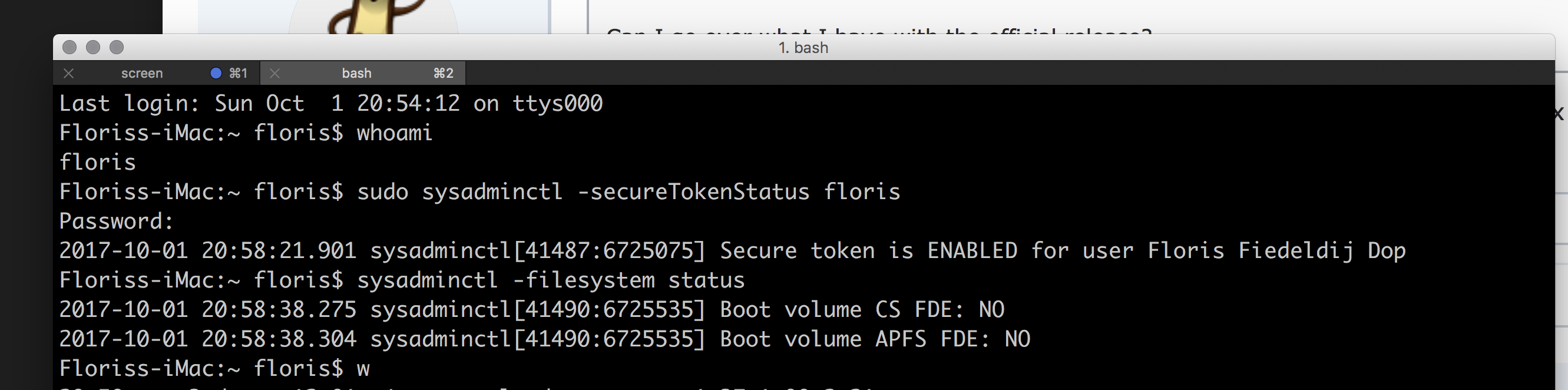

Since you did some restore and fresh installs and beta testing, try to check if you have a security token?
sudo sysadminctl -secureTokenStatus ACCOUNTNAMEHERE

Type: whoami
to get the username, then try the command again.
If it gets unknown user, then there's no security token or the system has a more serious issue.. i can imagine the FV then can report back an issue. I don't know if it's a bug or whatever.

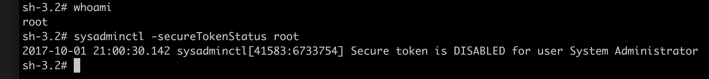

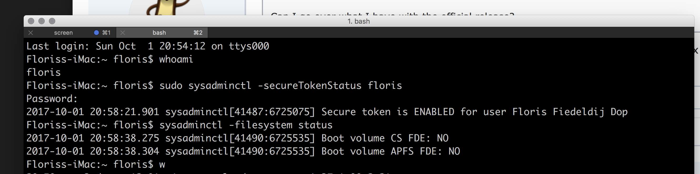

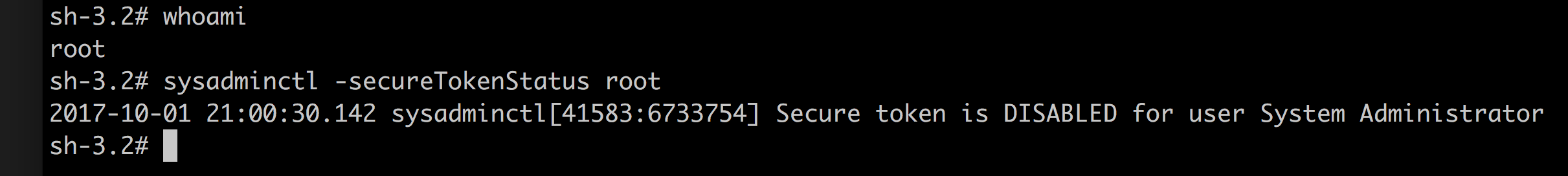

Ok, I ran the command right this time and this is what I got:
2017-10-01 15:13:02.949 sysadminctl[1581:112070] Secure token is DISABLED for user LarryJoe33
Does this look suspicious?
It's not suspicious, but I believe you require security token to be on in order for FV to work. I just got home from visiting my parents for a coffee, and if I can find the documentation again I will post it.. but at first glance it's no longer where I expected it.

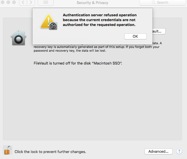

Sorry to hijack the thread but I think I have a similar issues that I would love some advice on. I had the double password and the extra “other" user issue. To try and fix this I turned off FV (took 3 days to decrypt, 2011 iMac with a 1TB SSD) Now when I try and turn FV back on I get the error "Authentication server failed to complete the requested operation” I would be very grateful of any help or advice.
The command to enable the secure token is
Code:
sysadminctl -secureTokenOn
Just don't be surprised if that reports problems with the authentication server credentials.

Thanks, I ran it and still getting the same message when trying to enable FV.
