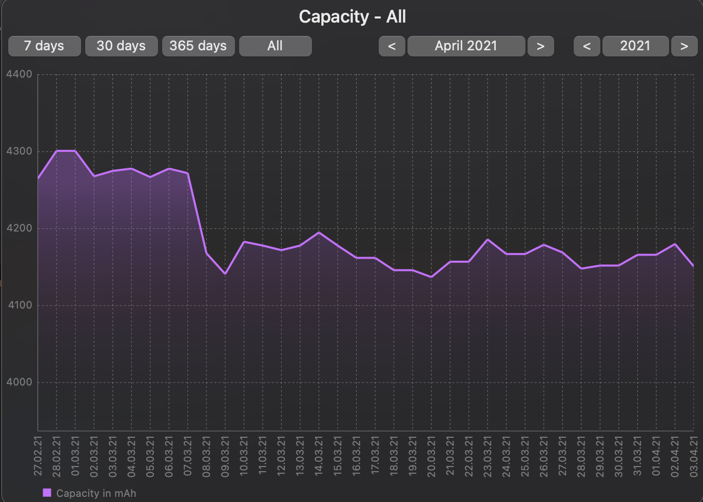

My capacity history supports what you say about daily fluctuations but I seem to have lost over 3% on one day between March 7th and March 8th. This looks like a clear change outside the daily fluctuations. Any thoughts?

I believe (consistent with TouTou's point) that Apple doesn't want users to see and react to fluctuating data so presents a heavily averaged number. I expect my Apple number to come down relatively sharply at some point when that step change in my max capacity works through the averaging.

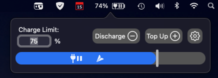

Constantly plugged in when on BUT with AlDente installed to prevent overcharhing.
Settings in AlDente: 60%. When battery is charged to 60%, charger powers Mac directly and skips the battery...

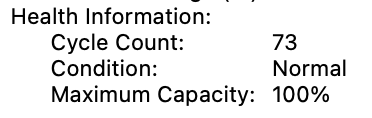

I have had my M1 MBA 142 days and my battery health (with 21 cycles) is 100%. I have been using AlDente.

Yeah, I'll stick with AlDente for now. Compared to my last 2 MBPs, the battery capacity is holding better than ever. I love it. 🙂
I'm running my M1 MBP connected to a 4k monitor with 2 hard drives plugged in (via USB C dock) - running off of a 15,000 mAh RavPower battery (usb c) (and have for the last few hours). Battery is at 87%. 🙂 I'm going nuts about how little power this system sips.
Love the control Al-Dente gives.
