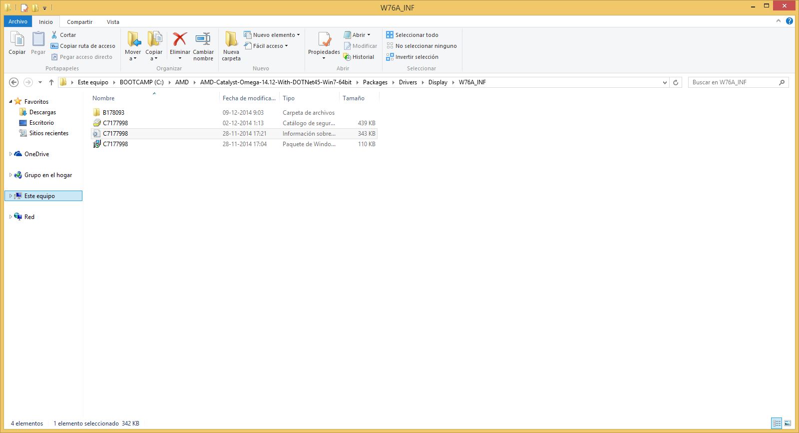

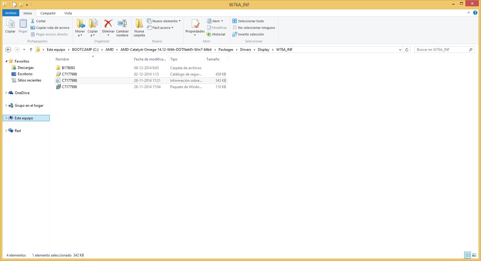

Not working, amd hardware not found.
remember the previous catalyst didn't use that string. the cards always are recognized as 7800 or 7900 (in D700 case) series in the official drivers.
Can't have been added to the correct inf file. With those PCI_VEN strings added to the correct inf file it will attempt to install a driver as those strings will pass the hardware check part of the install. Stopping after is a different story :D
i added that string in this .inf and nothing.
Must be another inf file somewhere that is doing the hardware checking first, probably buried in a cab file if its not immediately visible. I have been hacking Windows drivers for 20 years and the installer hardware check will look up those vendor strings trust me :D

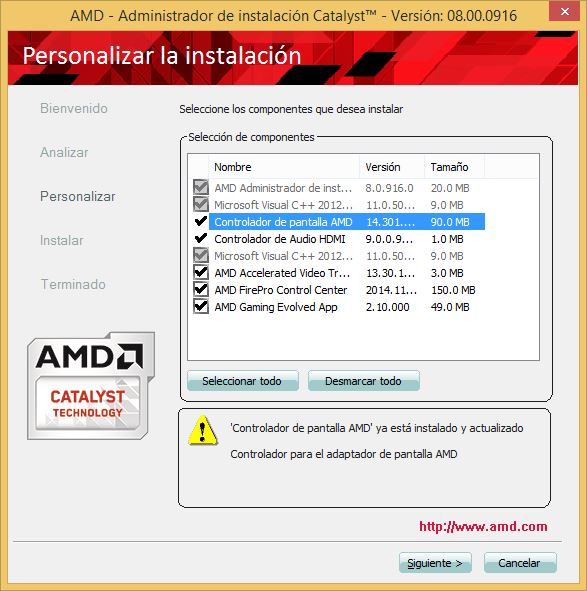

Good, bypass but won't detect the display drivers. It says is updated and already. (i have installed 14.11.2 beta)

Ok guys i installed the drivers with the method TerrorOfDeath
i used the InstallManagerApp and InstallManager.dll file of 14.11.2 (beta)
did not need mod the .inf just replace those 2 file and run.
PD: i had the wrong package sorry amd-catalyst-omega-14.12-with-dotnet45-win7-64bit
please you need sure what you have downloaded the correct package for Windows 8.1 is this amd-catalyst-omega-14.12-with-dotnet45-win8.1-64bit
i am testing the drivers right now cant see any changes in FirePro Control Center.
