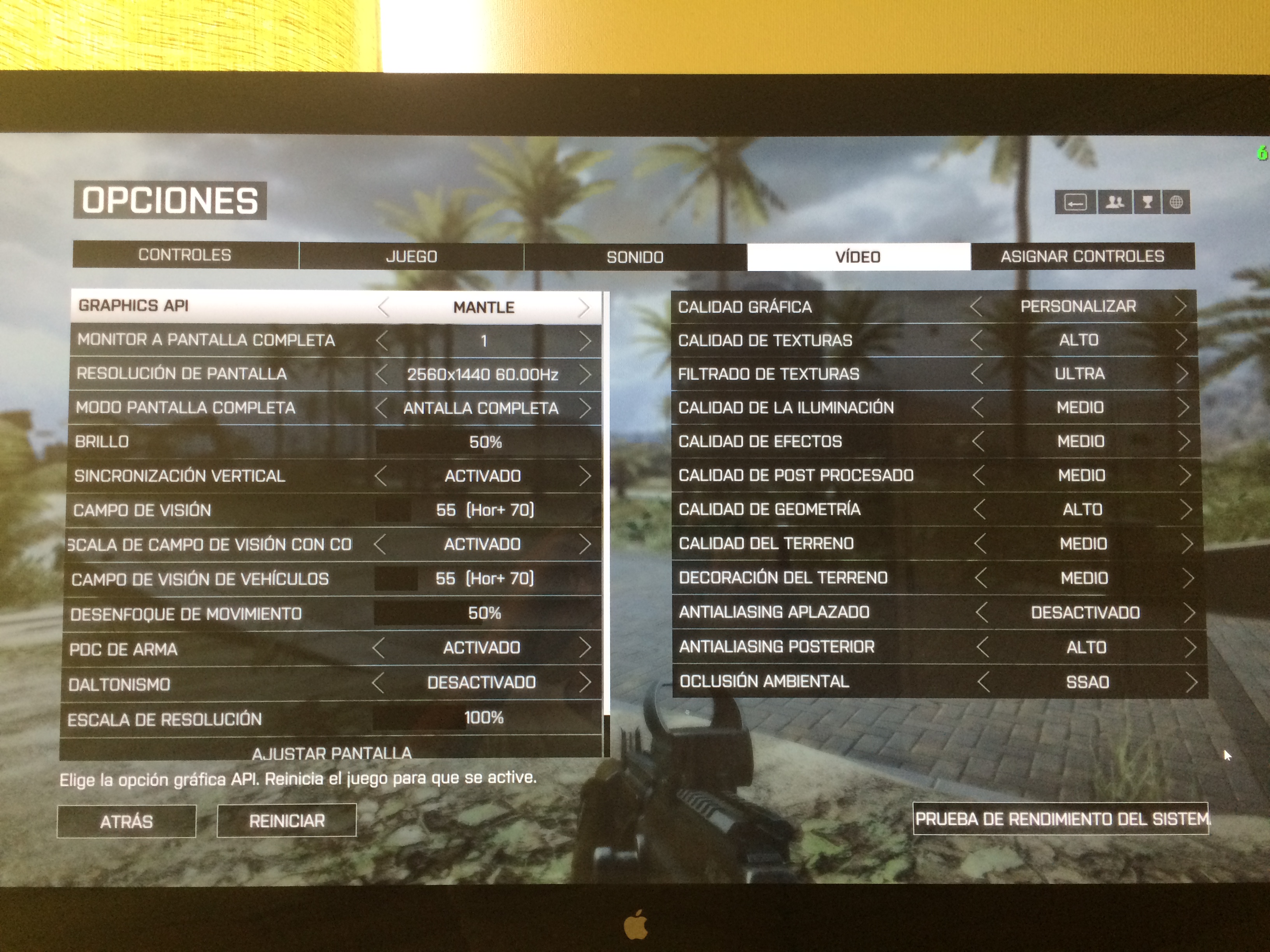

I'm playing BF4 with the Mantle render is working good mostly time is locked 60 fps
I think this is the best drivers for BF4.
