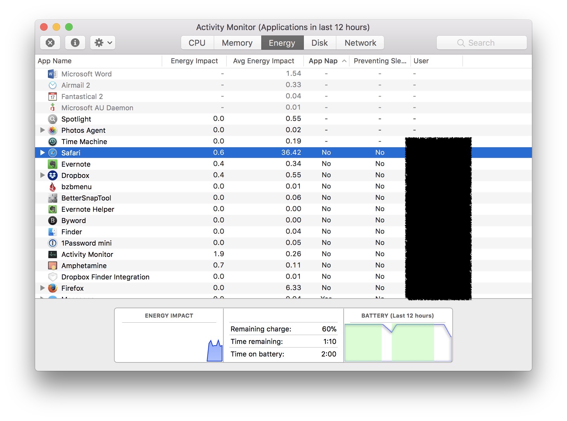

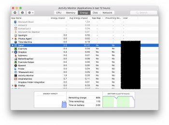

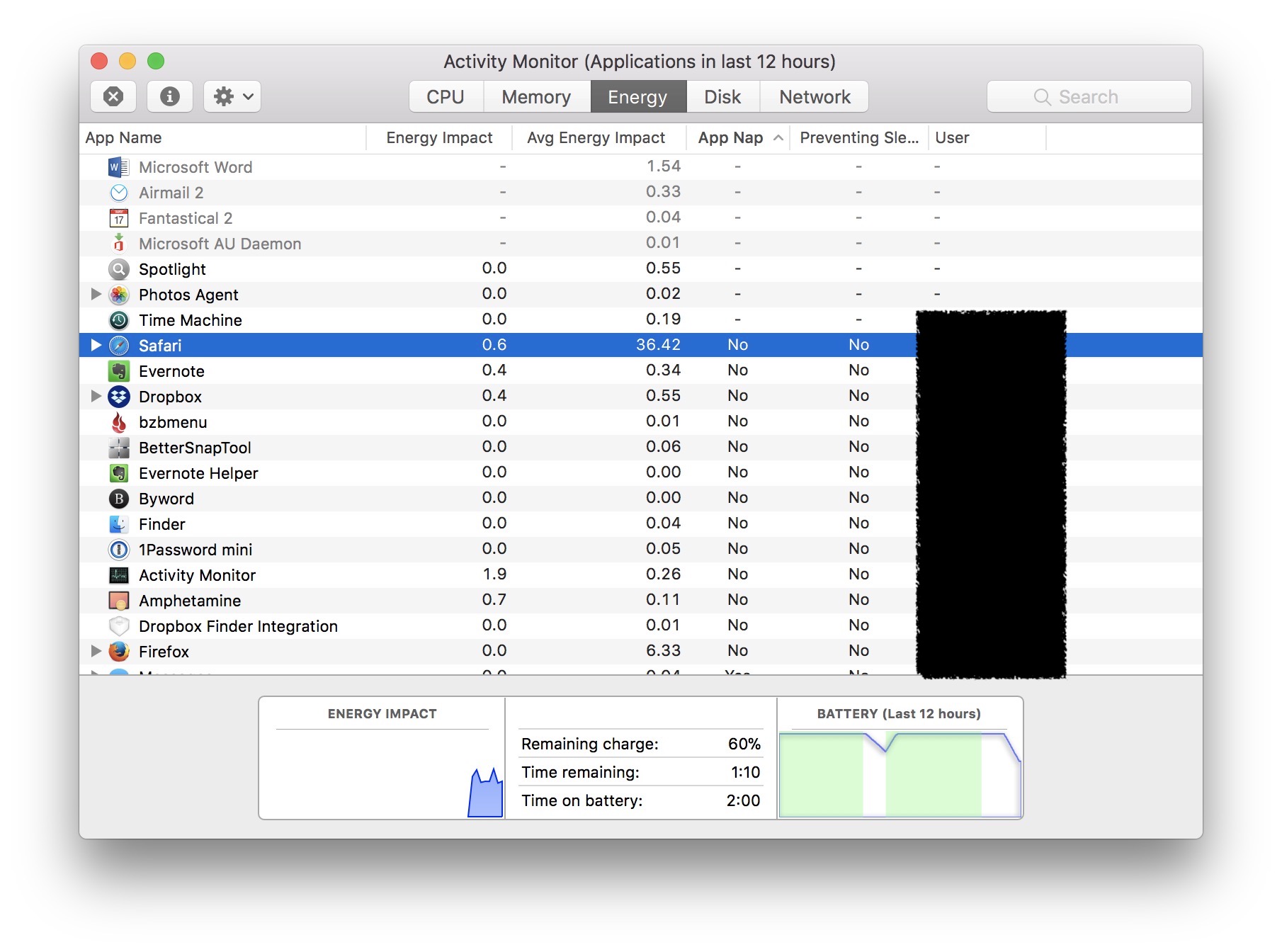

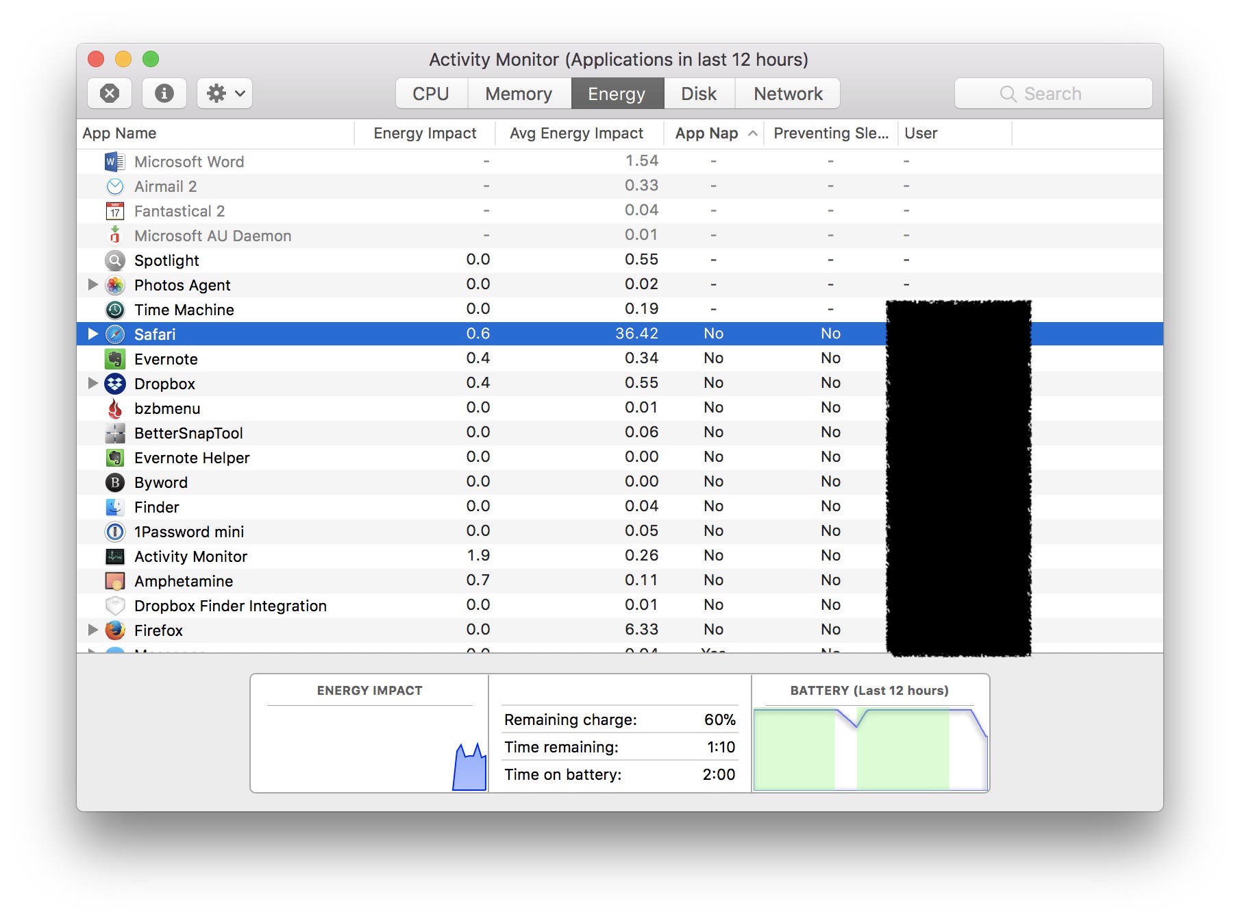

the tMBP in my sig has had major battery issues since upgrading to High Sierra. With my typical workload and settings, I could squeeze somewhere between 8-9 hours before getting to about 5%. In High Sierra, that is basically in half with a similar workload. I went from 100% to 60% in two hours with very little going on. Screen @ 25-30% brightness, few tabs open in safari (I even have an adblocker that blocks annoying ads with video) Evernote & Byword open. Not much else beyond that. Does anyone else have issues like this (on any machine?). Does the .1 update resolve this issue?

Mine same like your. 1hr+ it take 20-25%(web browsing), I wonder is it cause by High Sierra?
My first instinct would be to try the regular NVRAM and SMC resets (use your favorite Internet search engines to locate tutorials) to see if that doesn't rectify battery performance issues in High Sierra.
I have three Macs (two are notebooks) and I have not noted any major battery performance issues since my High Sierra upgrades.
Best of luck.
Best of luck.
I believed I tried that before but I’ll give it another go in the evening and see how it works out over the weekend.
You can check power abusers: Left-click on the battery icon in the menu bar; and, Energy tab in the Activity Monitor. For browsers, like Safari, you can expand to see which tab is the problem child.
