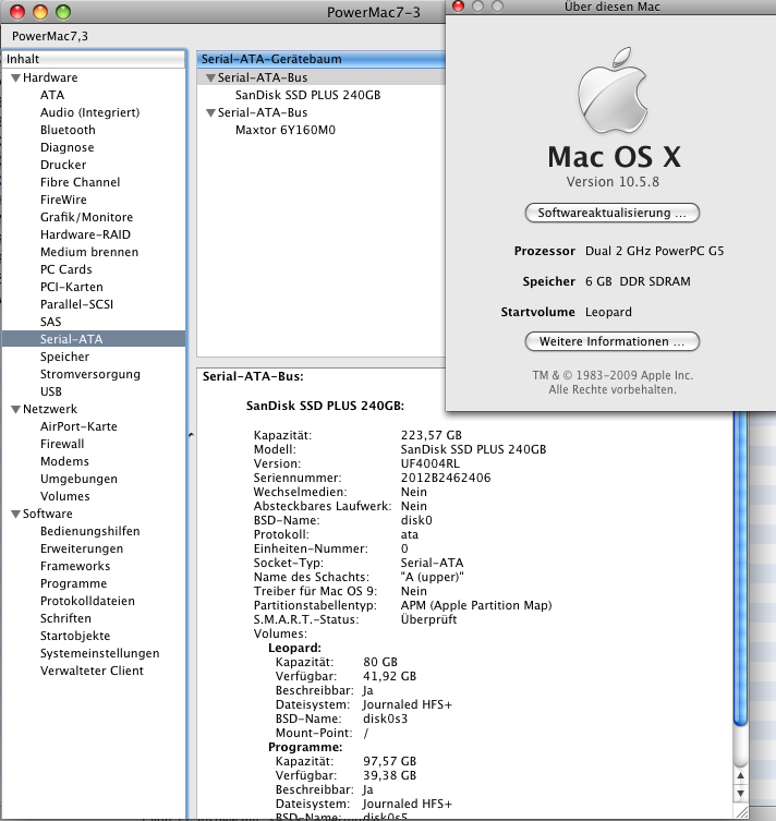

Ähem, buy the right, get the right:
Got the same drive in my iSight 21" iMac, works without problem.
My PowerMac7.3 has a Seagate Hybrid (some older 500GB 2.5" drive), also works.
Back than I did try some random 60GB SATA SSD which only worked (not 100% reliable) in the lower drive bay.

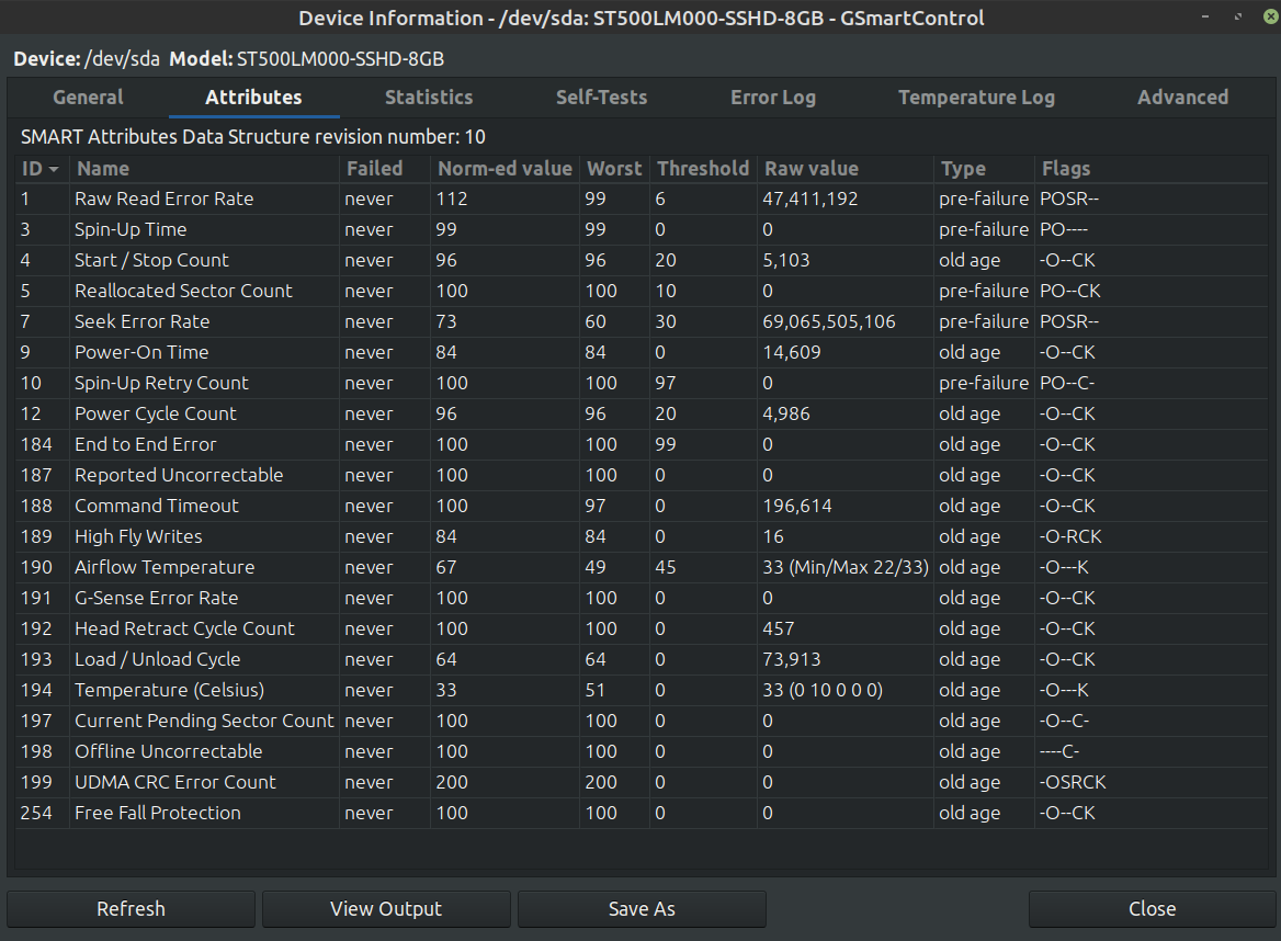

Not sure why this myth kept being peddled for a decade or so, but I own 3 of them now (2x500gb and 1 750Gb with a 16Gb SSD in my PowerMac G5), and one of them has the defective firmware in my old Macbook 2006 now running Linux. I used it since 2007 and 13 years later it is still going strong. My Crucial SSD which was supposedly to be built like a tank died in 6 years time. My Sandisk SSD died in 5 years. My WD green drive and I have 2 of them died in 8 years. Everything dies one way or another. There is no such thing as an absolute truth about hard drive failures or SSD. Below is my oldest 500Gb SSHD drive that is 13 years old of its SMART value, which according to the myth should die and yet I have 3 of them (all a decade + old) and they had yet to die. Most of these myths I think are circulated by people who don't own these products, have a bias on these products or just had bad luck on the product and then have a revenge vindictive agenda, out of anger, to discredit and put down the product.

They're no less reliable. Seagate Barracuda drives have gotten lots of mixed reviews. The Firecuda line uses a Barracuda HDD as their base. Those Barracuda drives that fail do so in both the Barracuda and Firecuda line. Adding in a small SSD does not increase the chances of failure by any registerable margin.
