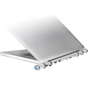

design preference
I would be biased towards such a design (as attached) that has ports and can also be sat on by the Mac
