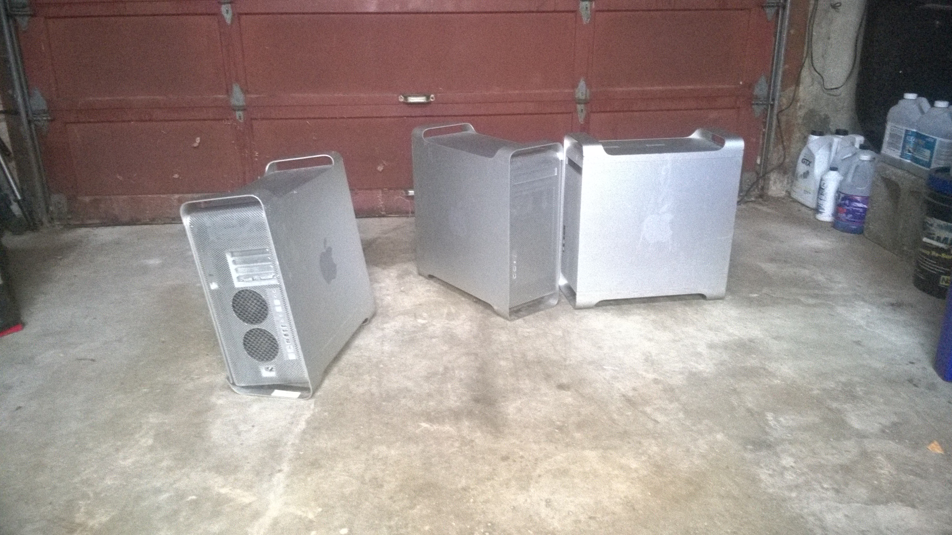

Well, here's the picture of the three. One has a gimpy leg and all of them look like they've been ridden hard and put away wet, but they do all power on. Two of them are single processor machines and one is a dual processor machine. Here are the EasyMac links for the three machines:
https://everymac.com/systems/apple/powermac_g5/specs/powermac_g5_1.8_2.html
https://everymac.com/systems/apple/powermac_g5/specs/powermac_g5_1.8_dp.html
https://everymac.com/systems/apple/powermac_g5/specs/powermac_g5_1.8.html
One machine has bent the tabs that latch the side of the case, and you saw the gimpy machine in the photo. Other than that, just scratches, dirt, and one kinda nasty looking gouge in one of them.
I'm going to vacuum out the interior and I want to get them up and running, so I can see exactly what is installed. I have a pair of SATA drives that I can used to get started. Being a Mac newbie, what do I need to do next to get these critters up and running?

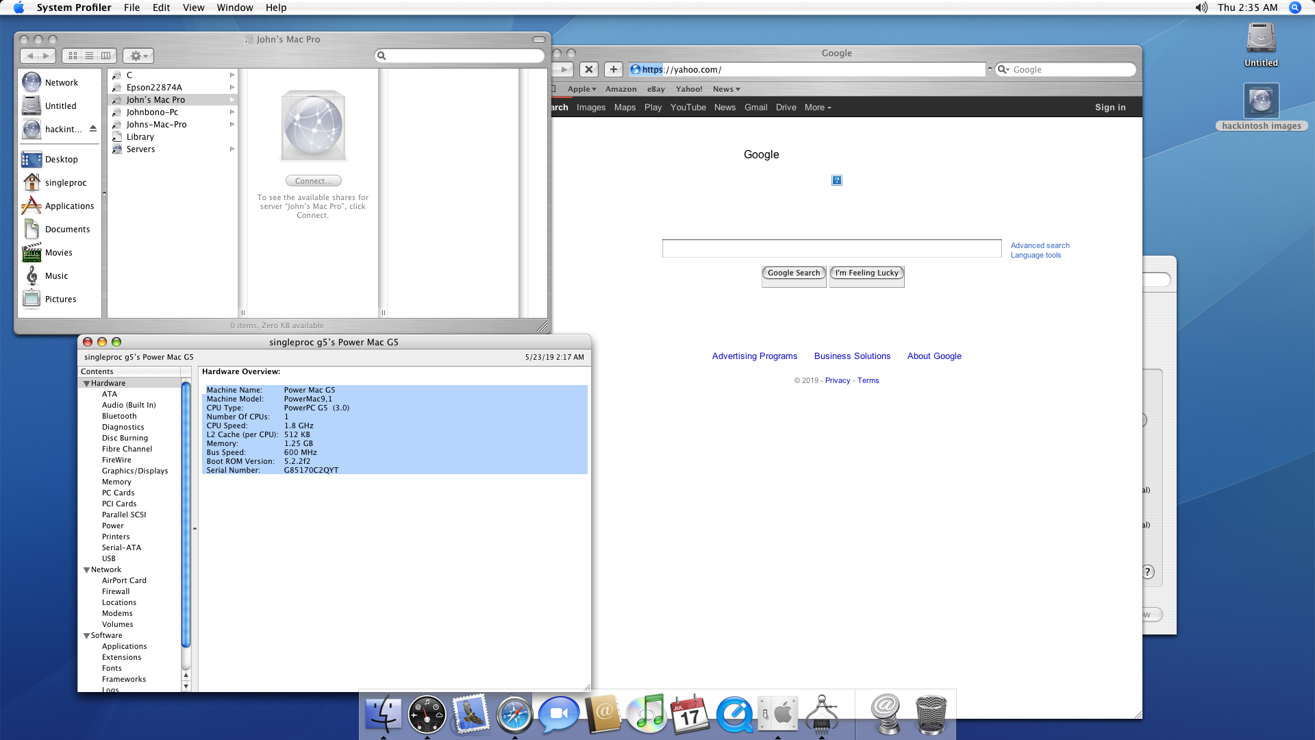

The single processor G5 is now fully armed and operational running Tiger. The biggest problem was that the superdrive does not really want to open. I swapped it with another one, which also was a bit balky. I blew on it, so a cleaning might be all it needs for long term. I also have an old drive from my Dell that might fit, so I may swap it.
The bad news is that the first dual proc G5 did not boot. The fan spins up, but no image on the screen and the led does not light up. If I pull the internal plastic cover, a red LED lights up on the MB, but that's it. The single proc has every dimm slot occupied. The dual proc one has two banks of dimms, each populated with just one dimm each, if that provides any help.
