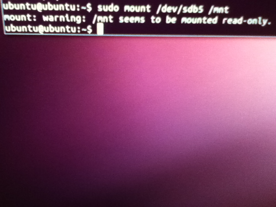

I tried mounting it through Terminal, through the Live CD like you said, but it said "Permission denied".
It replied with "bash: /dev/sdb5: Permission denied" after I put in "/dev/sdb5 /mnt", to be exact.
Help?
Help?
Try
sudo mount /dev/sdb5 /mnt
I tried sudo, and when I tried "mount /dev/sdb5 /mnt", It told me that was an incorrect path. Not even sudo helps. Or chown.
And I am sure sdb5 is the bootstrap partition, unless I should try to reinstall again.

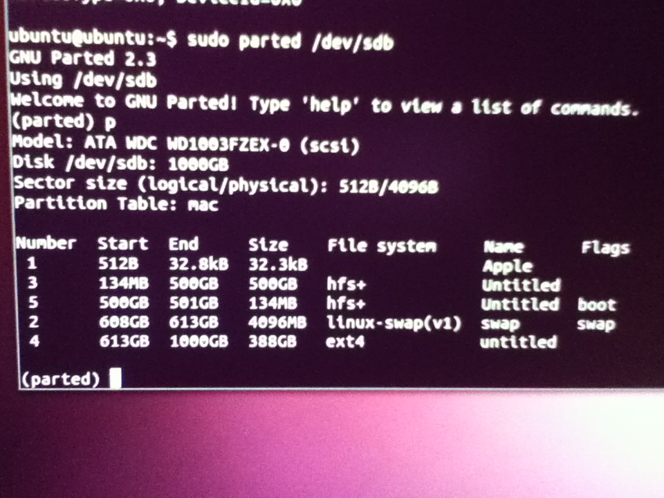

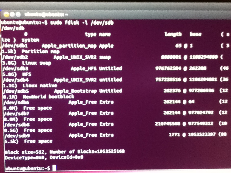

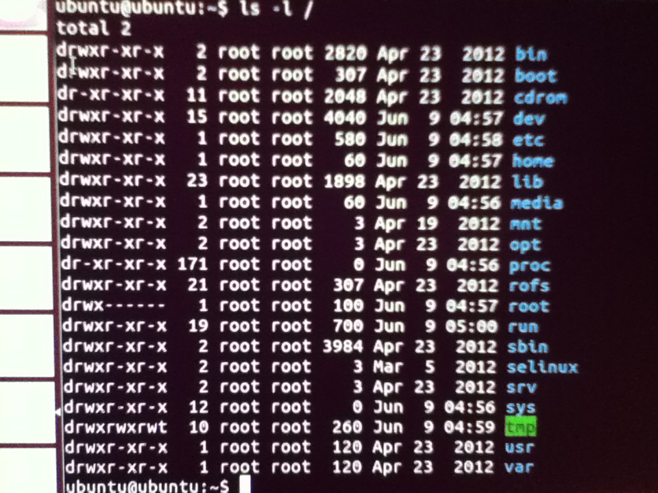

Just booted a live CD , can you give me the output when you try these commands :
ls -l / ( need to know wether mnt exists and who is the owner and group )
sudo fdisk -l /dev/sdb
sudo parted /dev/sdb
then p(rint partition table) , q to quit parted again
Normally you shouldn't chown anything , what error message do you get after the above when you do a
I'm probably just going to reinstall, anyway. I want everything to be perfect with no chance of failure due to missing files, or damaged components.

Well there is a few bizarre things in your screen outputs.
I thought the bootstrap partition should be hfs not hfs+.
Also your order of partitions has an OS X partition at 2 ,bootstrap at 5 , swap at 2, ext4 at 4.
On my systems the linux partitions usually follow each other

hfs+ is indeed journaled and hfs non journaled.
What does your sudo parted /dev/sdb show now ?

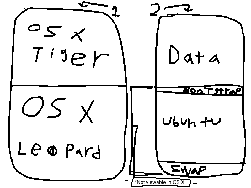

No, OS X was completely separate. Remember, this was on a completely different hard drive. I selected the main Linux partition, and drove it down to 1 GB, like this.

I just made a big Linux partition, and a 1GB bootstrap partition in OS X. I tinkered with the main partition all in Linux.
That is correct, out of the main Linux partition.
Yes.
If I actually go back into the installer on the Desktop CD I will.
I can't. I still have a Data partition for OS X on the same drive as Linux. Linux will think it can use the whole drive, and then the entire drive will basically go to no use while in OS X. Besides, I'm not giving Linux a terabyte of space. If you can tell Ubuntu *what* partition to install in using the automatic partitioner, that might be an option. I could try that.
I'm sorry for the ABSOLUTELY HORRIBLE presentation, but hopefully you'll understand it. This is pretty much what all the partitions look like now. Again, writing/drawing with a mouse is not my best skill. Please forgive me.
Actually your drawing cleared things up for me , I had already noticed that you had a big HFS+ partition on /dev/sdb and thought it was OS X , not pure data.
Now I also understand why you can't clean reinstall using the automatic partitioner.
Unfortunately I don't have a clue how to resolve this since I kept my data on the same partition/disk as OS X.
I would suggest either
  1. Copy the data to an external disk, wipe /dev/sdb , automatic partition and leave free space at the end to recreate your HFS+ data partition after the Linux install and copy the data back to it
  2. If you do want to keep your current partition setup, have a try on the Ubuntu Forums ,they might be more knowledgable in this dual-disk split partition setup
    https://ubuntuforums.org/forumdisplay.php?f=328
