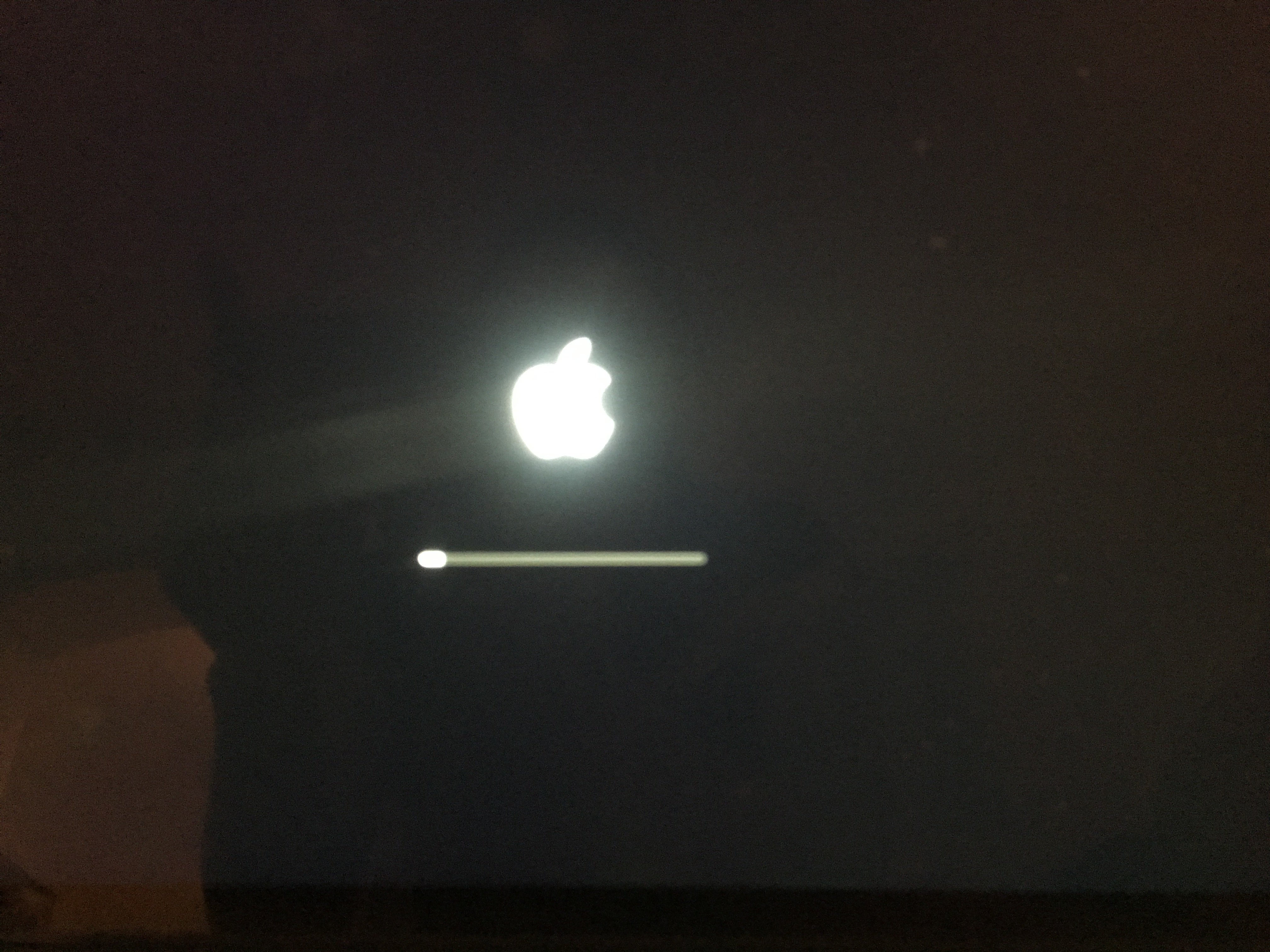

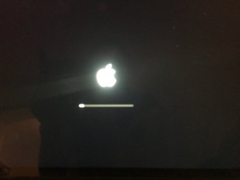

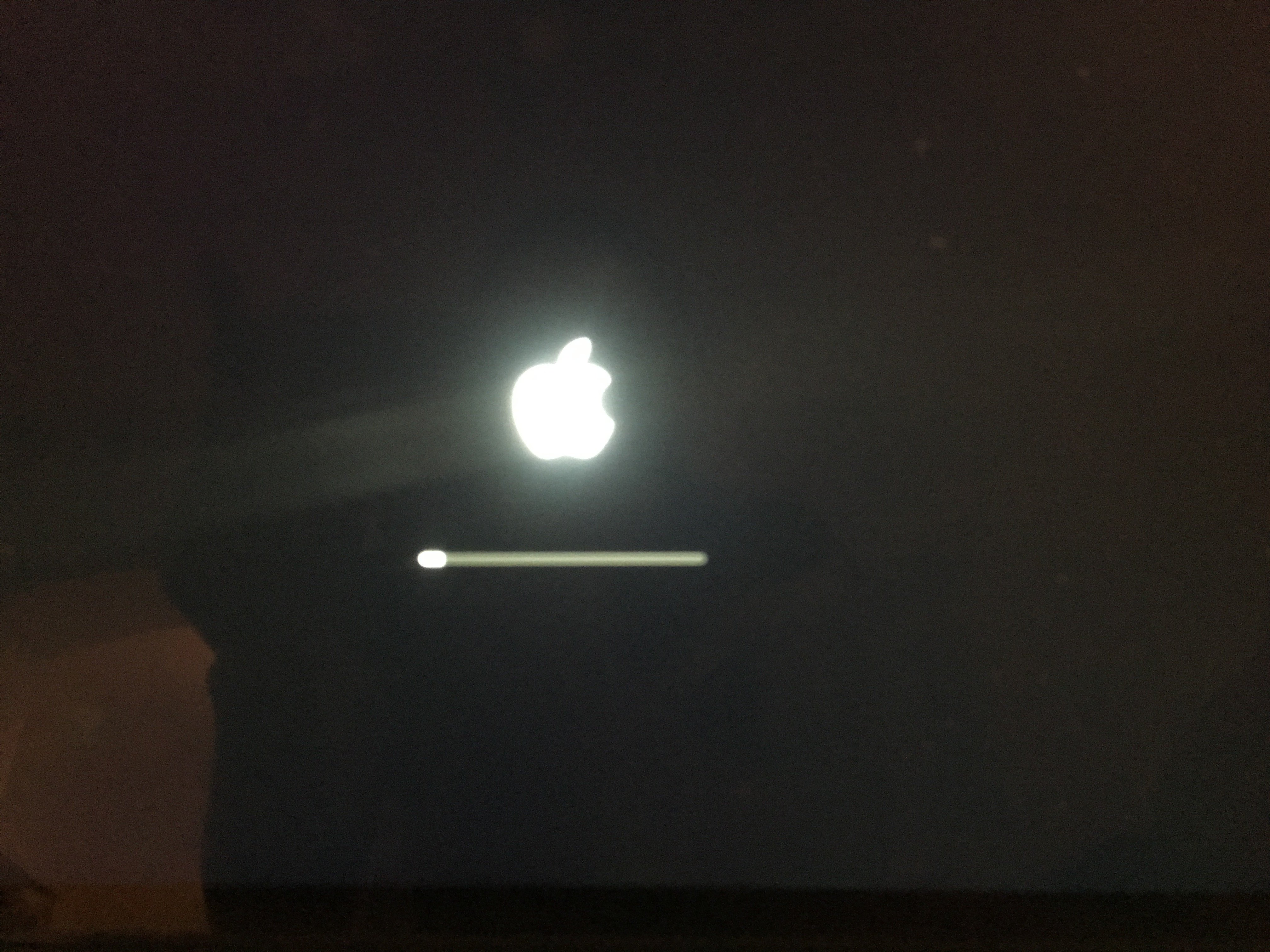

Yes, that's exactly what's up. Upon startup, the choose language screen opened. I did the good ol' press and hold cmd, ctrl, option and start button until you hear a chime and the apple logo pops up. Then the screen was just black and loading with the white apple logo and I immediately knew something was wrong, because it should just start up and show the account holders names.
[doublepost=1559071021][/doublepost]This is what it looks like when I open it. As you can probably tell, it's loading. It's super slow, so it's basically starting up the choose a language screen...

What process did you use for the SMC reset?
I think it's time to restore from backup but there's something wrong if you followed the SMC reset process and it did this. I would do the hardware test too, and the NVRAM reset.
Well, apparently I did it wrong since this is happening. I didn't know you're supposed to remove the battery, so I didn't do that. I've used this method in the past though, without knowing I've been skipping a step, and I've never had any issues... thanks for your help. I guess I'll just have to start resetting my computer then!‍♀️
Did the hardware test, computer says no. As in, no problems found.
