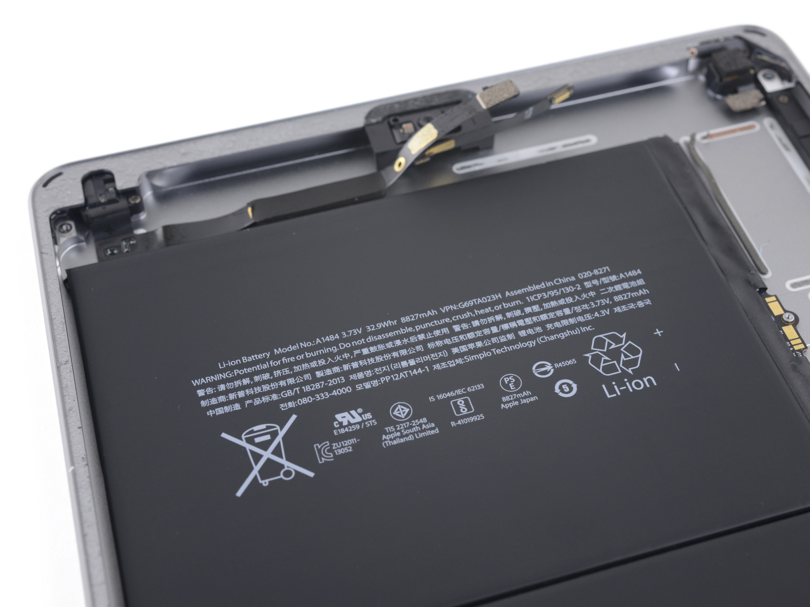

My 2018 units with 10W adapter came with smaller 8557 mAh battery. Just a thought, I guess that could make up some (but small) of the difference in charging time also. But again, it does not really mean anything if the device only pulls 8,5W while charging.
What program/app reported 8557 mAh capacity for your iPad? Per Apple specifications, they should have 32.9 Wh (167g) battery same as the 2017 iPad. My 2017 iPad has 8820 mAh total original capacity albeit per Battery Life app, it's now degraded by 7% to 8200 mAh.
https://images.apple.com/legal/more-resources/docs/apple-product-information-sheet.pdf

And yep, looks like the basic iPads have bigger batteries than the Pro 10.5.
Like I mentioned, you need to use PC + outside app that can read information directly from charging circuit.
Those apps running on iPad cannot read that, so they just assume all units got 8820 mAh battery. However those apps do give pretty much the same information about battery wear (so, it will be just sugar coated as in 99/100 cases battery is slightly worse than what they say because rounding up go like this: 8701-8799 will be reported as 8800 mAh in those apps). Still there are some values like voltage reported accurate.

Based on the Wh ratings on Apple's product information, I do believe 8820 mAh actual capacity is accurate. 32.9Wh / 3.73V = 8820 mAh. Do you notice how when you leave the iPad charging overnight and it's 100% when you unplug. Going from 100% to 99% takes a long time but from 99% to 98% or 98% to 97% doesn't take as long? I think 8557 might be design capacity or 100% and the extra 200 or so mAh is allowance/contingency.
Besides, we even have this:
https://www.ifixit.com/Teardown/iPad+6+Teardown/105416
